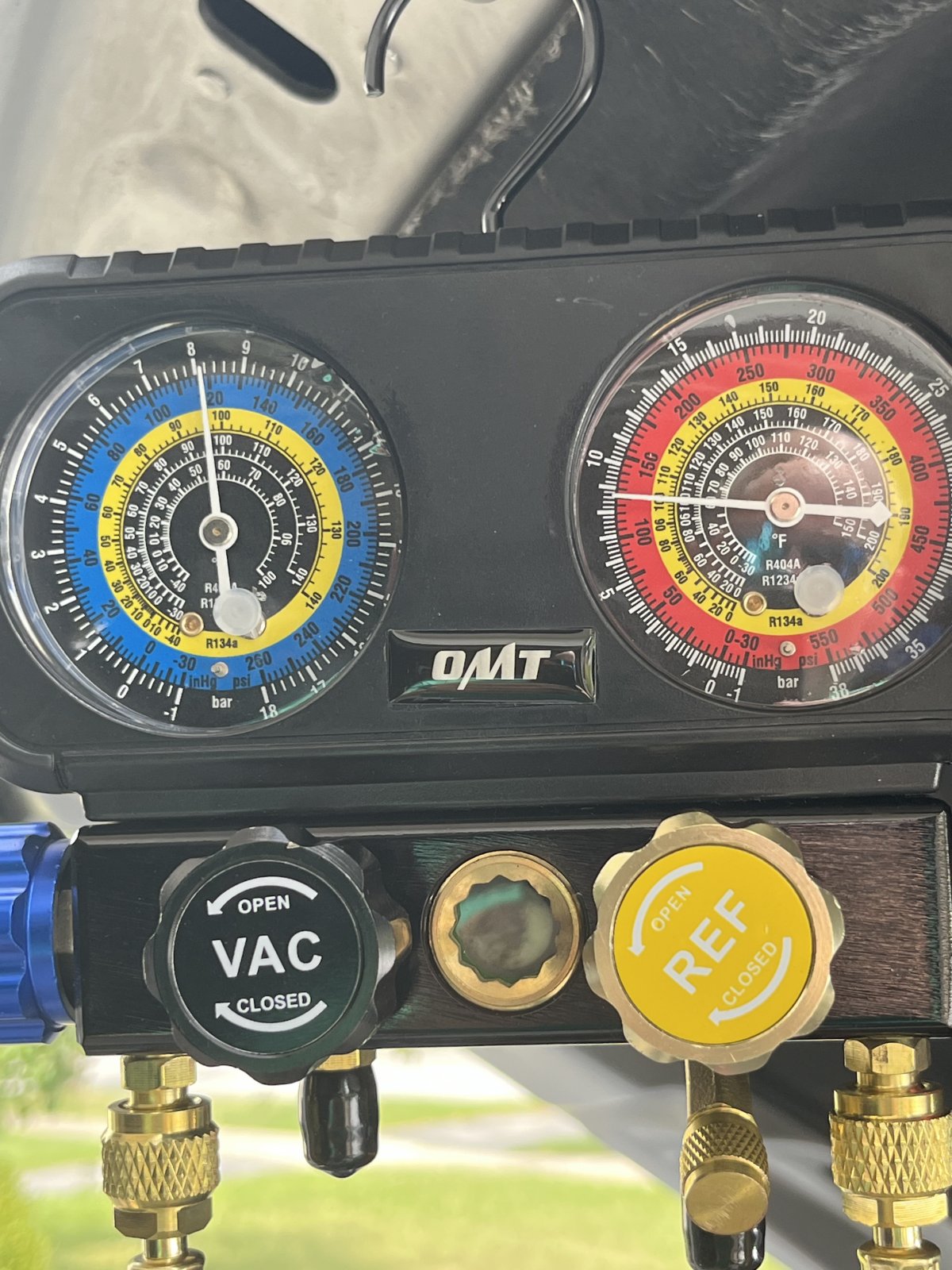

Ok, went out and got some gauges and here are the reading with the car running with ac on and car running with ac off. Again the clutch engages with ac on and disengages with ac off. Hot and humid as balls here 92. Appreciate the info. Thanks. Jim

Thanks again fellas. That last was a quick post. To answer some of the questions…I do not feel anything cold and there is no sweating. While watching the gauges it looked like the pressure on the low side was slowly increasing while the high side remained the same. Are the pressures off from where they should be with the conditions?? If so, what is the cause of this?? Bad compressor?? I am guessing I can rule out a leak seeing I have pressure in the system correct? Thank again for your input and patience as I try and learn this.

Pressures dropped when the ac was turned off.
They should but they should not be even when running with clutch engaged. That is why there is a HIGH side and a LOW side. I would try adding refrigerant, by a professional shop and check for leaks.

My first thought is you may have a clogged expansion valve….if your compressor is engaging and low side pressure goes up WAY to high..with relatively no high side pressure change. Or a plugged condenser.
