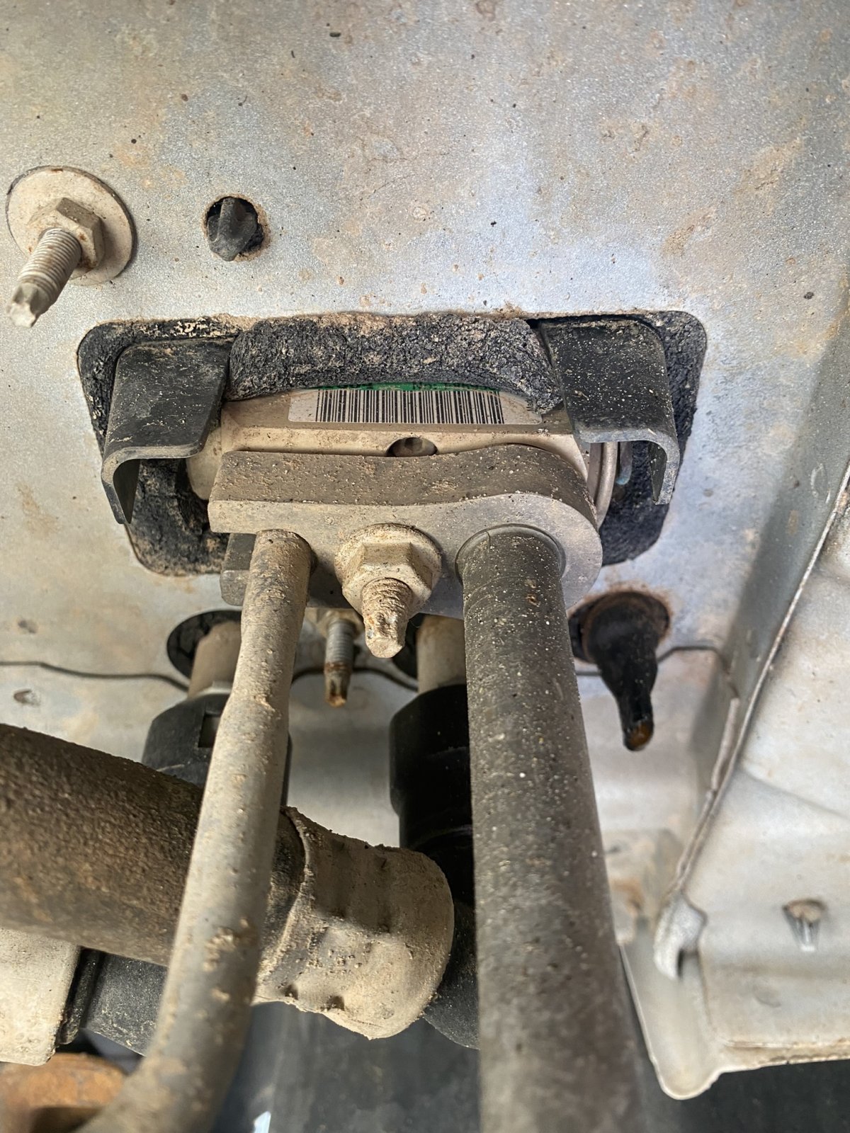

If you look under the vehicle by the passenger rear wheel well you can see where the coolant hoses and refrigerant hoses go into the rear evaporator box
Rear AC connector

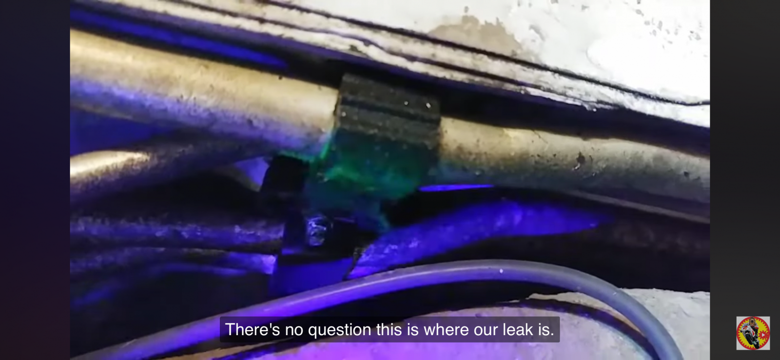

This is the specific clip where the lines like to fail inside the wheel well 99-modern rear ac i believe all run a similar clip design
Is that or any of the other mentions behind the inner fender liner or just behind the rocker panel/frame rail?
IS the green color the from the original fluid leak or was there dye introduced?
