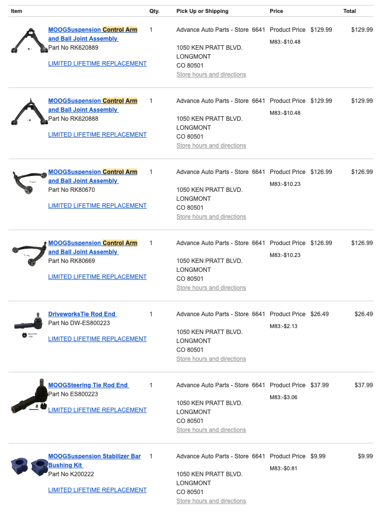

When I pieced together the stuff for my 2007 I used Moog parts for all but one of the tie rod ends that I couldn't get so I subbed in a Driveworks one. Fast forward 4 years to last year and I had to replace that same tie rod end due to a blown-out boot, but this time used a GM OE. And I now have a boot on one of the Moog lower balljoints about to tear. When I do my 2012 in a few years, I'm going to use all GM OE this time because it sucks to have to pull it all back apart every few years.

Only about 32K at that point. It's like the rubber boot on that balljoint is made of gouda cheese. Here was my parts manifest at the time. Note that they were the Moog "R" line, which is their value line. It was all I could get locally at the time. Presumably their CK/K line would fare better.
