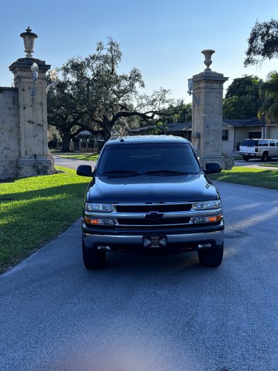

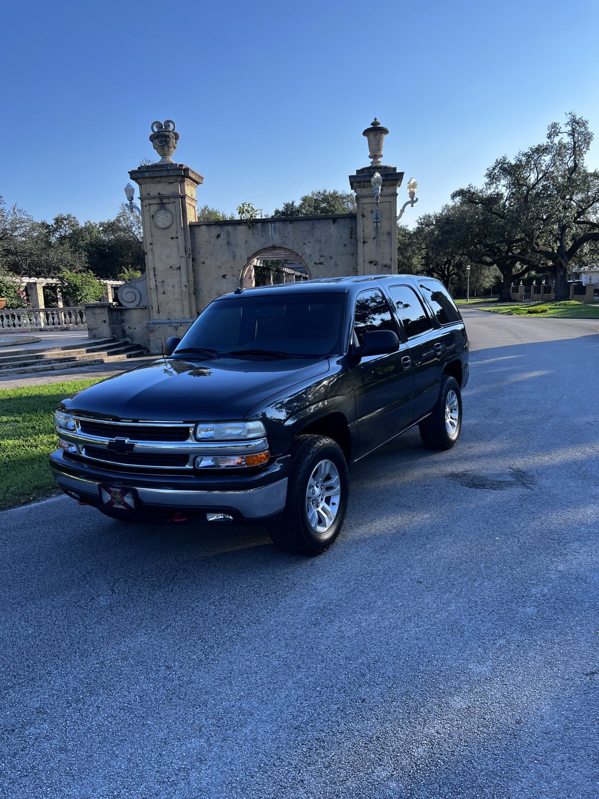

Welcome to the Forum from NH.
Pics of the truck, please.
@swathdiver has a pretty good handle on the multiple door actuators that come with these trucks.
Thanks for the welcome!
