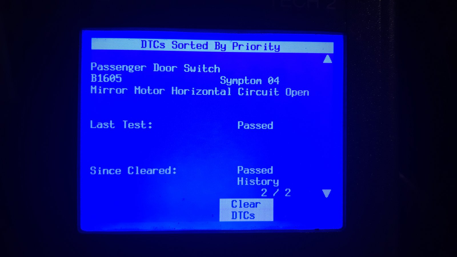

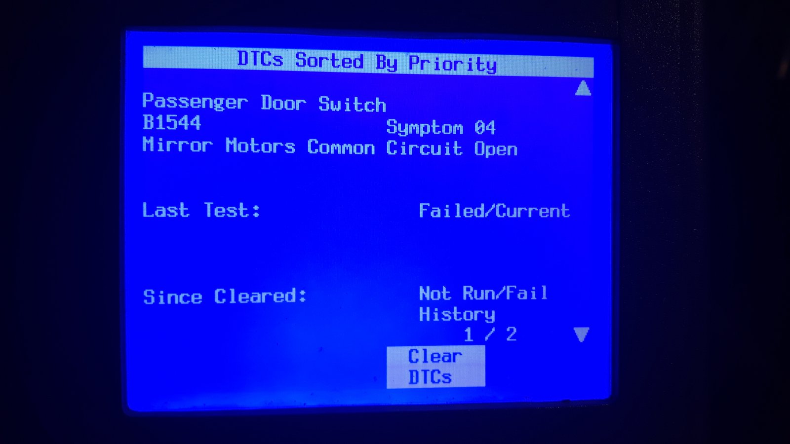

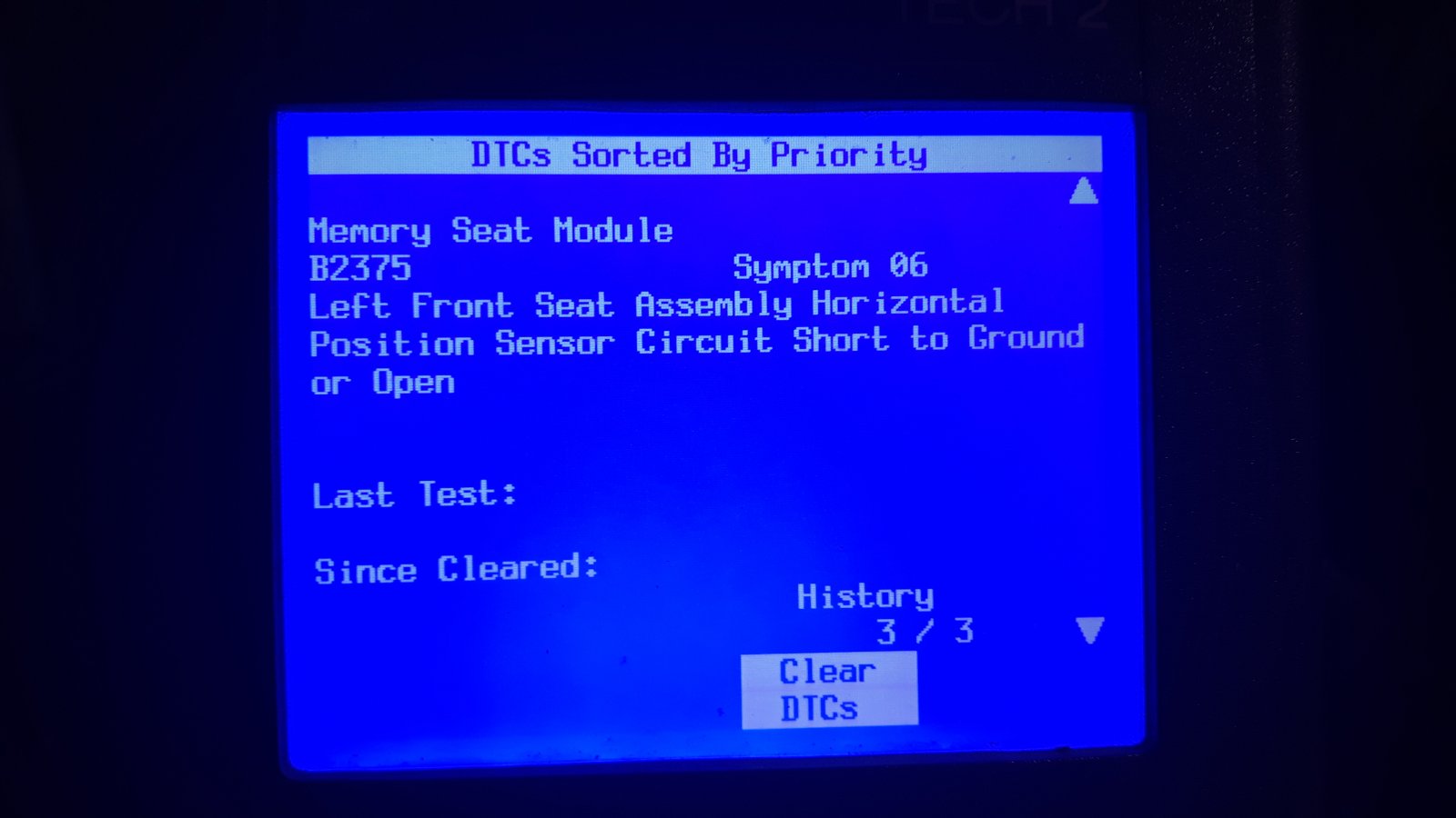

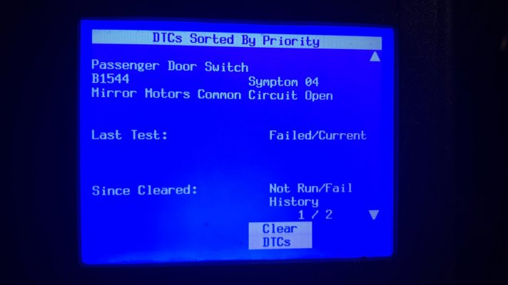

Double check that the codes you are seeing are either CURRENT or HISTORICAL. Some codes clear after so many ignition cycles, others stay forever until manually cleared. There's reasoning for this but I don't remember why!

I looked and couldnt find where it listed the codes as "historical". It does tell you when they where set in relation to last key cycle and if they set again after clearing. I went ahead and cleared all of them so I would have a starting point and so far they have not come back and the hvac seems to be acting normally. As far as I know it has the original actuators still in it and I will keep in mind about using original GM ones if I have a failure.
