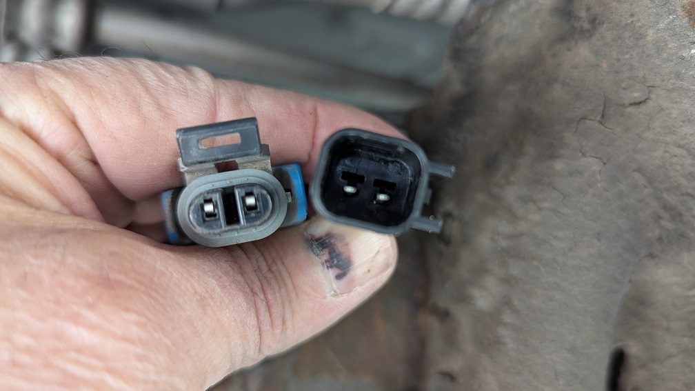

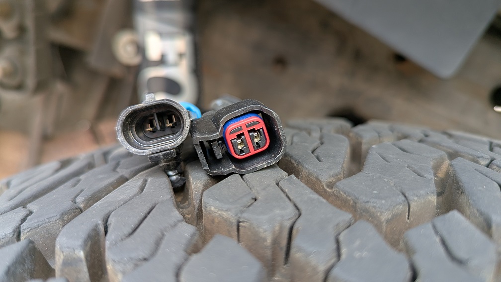

circling back to this, it looks like this 2" extender "might" work. It is marketed for the colorado's but the connectors look the same to me
not sure if the connectors have a physical difference or not, from all the photos I can find they look the same
$39 plus shipping
