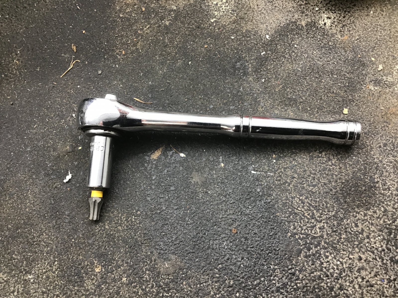

Not sure what torx size they are but this is what o usually use to get at screws like that- 1/4” drive ratchet with an adaptor that accepts bits. You can get a set of torx bits from t10-t30 for cheap.

I'm not the best solderer (is that a word) there is. I may give it a go and see. I'm really hoping I can get to the screws. We're in OK, and I wash under our vehicles often (I'm kind of OCD). I'm hopeful the screws aren't corroded and don't have lots of dirt packed into the heads. Does anyone know what size torx bit these screws are? And any tips other than the dirt on the screw heads?

be careful taking out those screws holding that module in they like to strip like a drunk hook-er, I would blow some air up under there to clean it out so you can hopefully get the bit in good. if it strips you will have to cut it out and then no core value.

Or use a small pick tool.

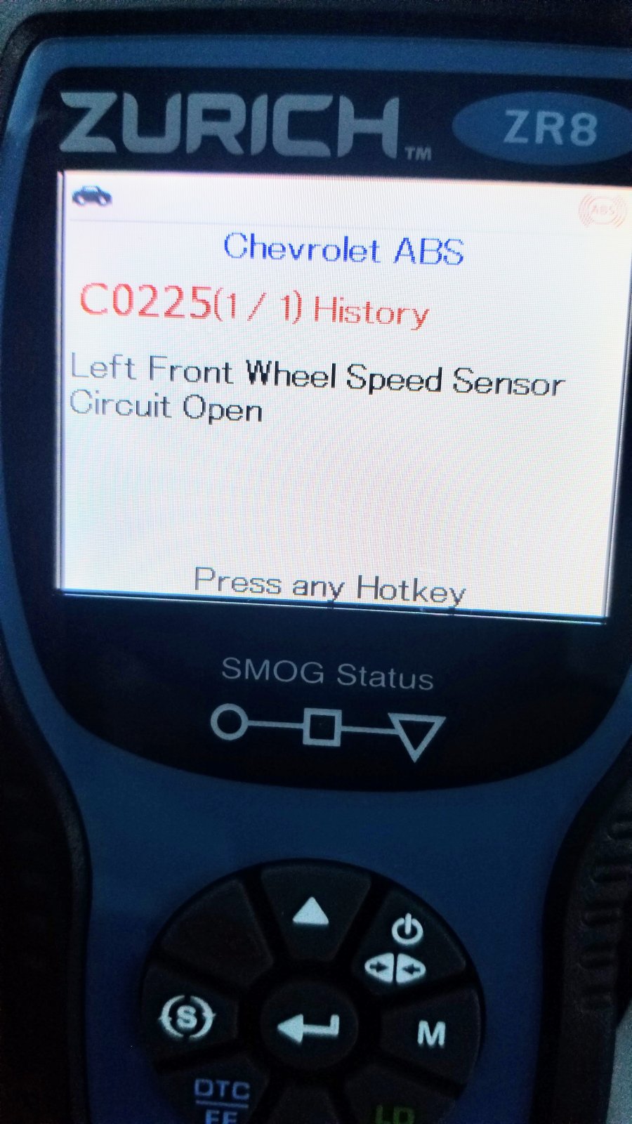

At some point, I found that there was an area somewhere in the Zurich menus/submenus called "Chevrolet OEM Enhanced - ECM".
When I dove in, it appeared to have all codes stored (8 of them) since last total reset. Here was one of the 8 codes... Not sure when that ever happened, but I never had any CEL codes for my torque converter, stop lamp switch circuit or cruise control set switch since I have owned it.

Correct. "Chevrolet OEM Enhanced - ECM" was found through the system on my ZR8.
Photo of just one of the 8 stored codes is below as an example of what I was able to see.
I had no active issues with my stop light...
None of these codes in the Enhanced section were listed under CEL menu, because they were not active codes.

Their instructions state the Torx are t-20 FYI.
