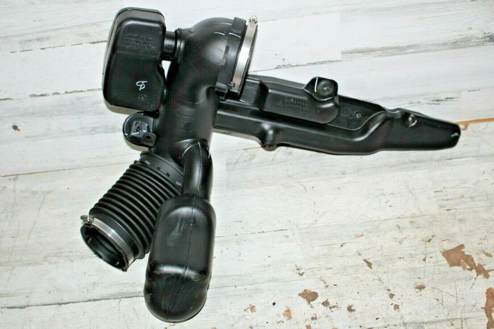

Keep your stock Air Intake system guys, a lot of engineering went into that funny design.
https://itstillruns.com/air-intake-resonator-do-12156112.html

Interesting find, however.... I wouldn't care if I lost 20HP by ditching my ugly factory air intake. It looks bad and I prefer the engine noise... sound waves and pressure be damned, haha.

I think the ability to control air pressure pulses has become a lot more important with the addition of variable valve timing to V8 engines.

That article is way to generic/vague and I'd like to see an infrared, if you will, video of the soundwave bouncing off the backside of the valve, back through the intake manifold, maf, down the tube and into that chamber. Just give me a back to back dyno comparison and db level output to see real world results.
52,954
Ok, well Blackbear Performance did dyno tests comparing CAI’s and most of them gained a few HP over the ugly stock intake tube, and some quite a few more, so exactly how good did GM engineers do on the HP side of the equation as opposed to the quiet side of it? I’m of the belief that they chose quiet over performance. You can still find the results of their latest test, on a ‘16 6.2l, on their website. They gained over 25 HP with the AFE intake.
http://blackbearperformance.com/IntakeTestResults_2016.asp
Thanks for that link, looks like that AFE is the best overall, I just asked a question about an AirRaid tube in a different thread, but this answers that question. Now to check prices for my 2013 5.3 PPV

Interesting analysis but I also believe it was primarily for sound dampening. As has been noted if this was true then dyno testing should show a loss in power and not gains.
My other question is when this pressure wave bounces back would it not just move toward another cylinder with an open valve instead of ALL the way back into the intake tube? I can see how you might possibly have waves bouncing around inside the manifold but as the cylinders are pulling in air sequentially and consistently the air coming into the tube should be constant and consistent.
If you're talking about a single or two cylinder engine this might make sense but in something like a V8 there's always at least 1 or 2 intake valves open at any given time for air to be drawn into.

Our intakes were designed to give you a nice quiet cabin, fit within the space, work from -40 to 140 etc........
They will give you decent performance ....oh and they had to build 1-2 million a year....

I think the stock system may become particularly important when the engine drops to 4 cylinders from AFM - it might help smooth the transition.

I think the OP missed the fact that the stock system on our trucks just plain sucks. It’s ugly, huge and it underperforms. It’s been proven for the last 20 years that pretty much any CAI other than the stock one is better. Not as quiet, but better performance wise. I’ll tell you what- when you buy a supercharger ( like I did lol) one of the things they include is a CAI tube to connect to your stock air box and guess what? It doesn’t have a bunch of chambers for waves to “bounce off”. And most of us like to hear our engines at least a little. This reminds me of Harley Davidsons, especially their V-Rods. In stock form they almost sound like sewing machines and the first thing almost everybody does is either mod the stock exhaust or buy an aftermarket one.

Glad to hear you have it all figured out Rocket Man - I'll try not to miss any facts in the future that don't conform to your all knowing views of the world.

Thanks, I’d appreciate that! :signs8: Realistically though, dyno numbers are real, a bunch of words about a generic product don’t prove anything. The article you based your theory on had nothing backing it up test wise, and it didn’t directly state anything about GM’s cold air intake design so if I kept even one person from leaving one of them on their vehicle because they mistakenly thought if they replaced it with something else they would suffer decreased performance then that’s good. I apologize if I offended you, I was just trying to set the record straight. The data doesn’t lie.

That BLACKBEAR report is interesting but IGNORES sound attenuation. Unless I missed it max dB in the cabin was never measured.
Many soccer moms/dads don't want the loud roar of a CAI.....
