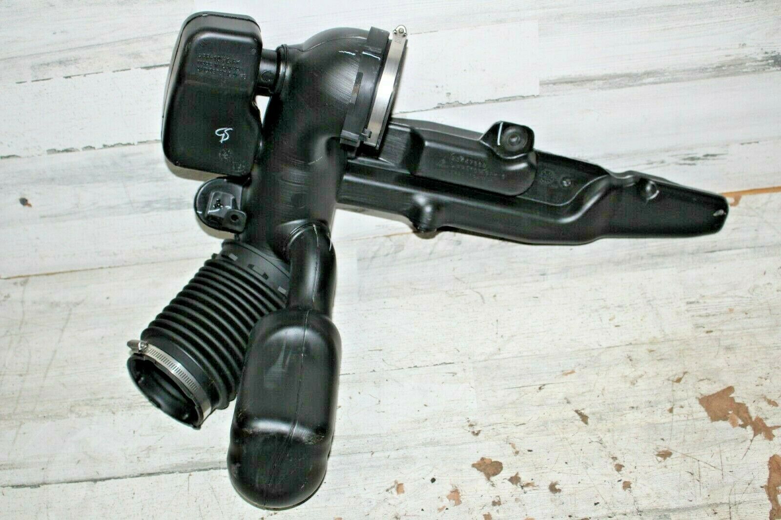

This design literally Screams Performance

i think the big point is simply removing the resonator and not doing anything else by just capping off where the resonator went will give you back some of the sound some people like. that could however have negative effects as the entire stock system is designed to utilize the resonator and give you the best power at the same time. depending on the vehicle a cai can have a large benefit in power but greatly increase the sound. other vehicles a cai will just make a bunch of noise with no gain in power. in other vehicles it is a full trade off between maximum power and actually hurting your low rpm power. 4 cyl engines was also mentioned so lets toss a typical 4 cyl civic in for a ref. a 2000 civic d16 a cai will literally do nothing but add a bunch of noise. a 2008 civic r18 a full cai will add some top end performance but you will notice a drop in your power off the line. you also cant compare some ebay junk to what most of the note worthy aftermarket companies sell you. buying an intake system isn't for everyone and doing your research prior to buying one should always be done. a stock intake system isnt so restrictive that you cant gain some power and keep it on the vehicle. if your after the sound and look of a cai why not. if your after power but without the added sound dont do an intake. if your after the sound and power do your research prior to buying simple as that. any aftermarket option that can be looked at as an "upgrade" in some fashion should be researched before buying regardless. no reason this discussion needs to get heated.

So even the Airaid MIT tube results in more power, not much, but a few HP. My point stands - the stock tube results in NO gain performance wise over something less complicated and less ugly. If something like the stock tube gained even a few hp over a plain tube, you can be sure that something like that would have been included with my supercharger instead of a smooth flowering simple tube that connects to the stock air box with a high flow (not cone) filter. As far as claiming that a full CAI will provide a “few” extra HP due to the filter itself, the test I linked shows over 25 hp with the AFE intake which has a large filter similar to stock. That’s not a few, that’s a lot. Show me the proof - not just an opinion- that that stock tube improves performance over a simple free flowing design. I do not buy it.
