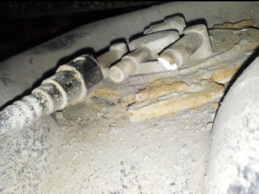

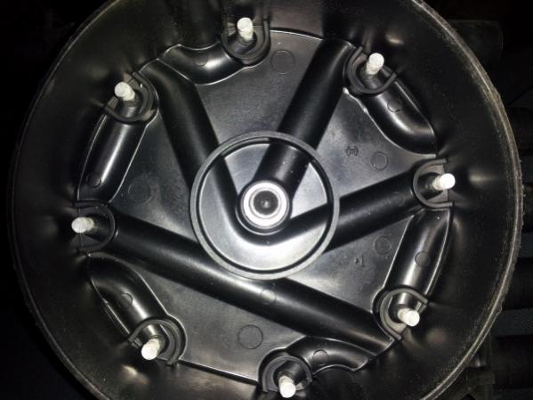

the spotting on the rotor does wipe off as does the white dusting, i brushed the chalky stuff with my hand and noticed that some of it came off. Here is a pic of the dist cap

well i don't see any immediate problem at that angle. who makes the cap and rotor? how old are these parts? and in the picture above can you get me various angled shots of the terminals as if the camera was sitting on the cap edge looking down slightly to see a side view of the terminals. really only interested in the right three terminals.

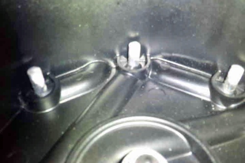

i do not see a name or a symbol on either, so I have to say generic. I don't know the age of the parts since I just bought the truck. This is the best pic i could get of the inside of cap right 3 ( what would be the d/s) all electrodes look to be equally corroded, but they are not broken

i was looking for cross fire burns. and yeah it is not a delco or delphi unit. at least not the rotor and the cap does not look like it either so far. and i definitely know it is not a msd unit either. i would like to suggest this. if you can do a compression test of the cylinders and post numbers here. weather you can do that or not it ideal to get a declo delphi cap n rotor,wires and plugs. the delco numbers are: d329a for the cap, d465 for the rotor, 9718q for the wire set and 41-993 for the plugs. all can be for about $142 at amazon which is cheaper then a local store. if you want to try clean up the plugs a bit and measure them to make sure they are at .060. that would save $48 but i typically don't recommend using anything but delco or autolite. another option is to put regular copper core plugs from autolite in there. they would be autolite 605's they are about $2 each everywhere. the drawback is you have to change them out in about 10k miles they are not platinum or iridum and can not last up to ten years or 100k mile. i have pushed my copper cores past 15k and about .075 gap but i am running a high power ignition system from msd too. i am going back to autolites xp605 when the headers get installed. i have had a long term experiment going on my truck. if you get standard plugs you will need to gap them. fine point tip ones should already be gapped. if after all this this is done and the compression and cylinder condition is good and you burn out a cap say 5-15k down the road you will likely have to deal with the dizzy as the vent screens may become a problem.

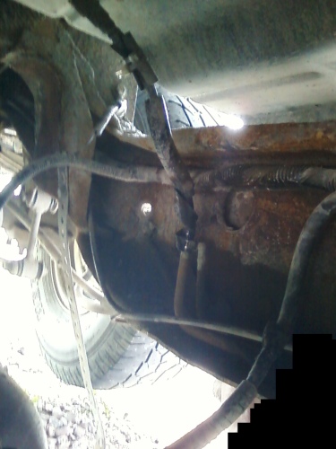

okay here are 2 pics
in this first one you can see the regular rubber line coming from the hard line on the frame sticking almost straight up. You can see the other hard line there too with nothing on it. That rubber line in the right of the pic is the other fuel line.
Here is the top of the pump, right side broken, left side all rubber line, looks like its the right type of line maybe just much longer.

looks like you broke the pump pressure connection. and yeah that just piping looks wrong right there from the pic you posted. but is it a rubber hose or just abrasion padding. item #1 gm 15714582 $104 is the fuel feed line. item #2 gm 15714273 $83 is the return feeder. both available online or any local dealer if you need them. prices vary. check the condition of the line that mount to front of tank as well. while it is all down clean up the spray the frame real good too.

line number is ok, just the tip of the fuel pump is broken there, line number 2 is flexible. just looks like a longer section than line 1. line 4 is completely fine.

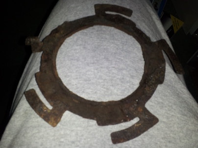

here is the one I took off of the tank. notice the one tab is just about mangled, 2 others were like that i straightened them
