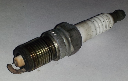

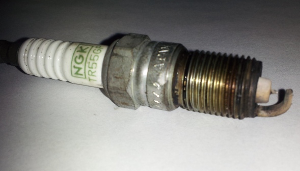

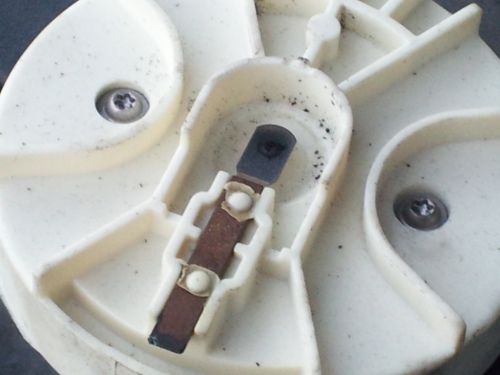

here are 2 pics of the #6 plug. wire looks good. also pulled the dist cap, generally it looks pretty good, the electrode tips inside are kinda white though. Also when I pulled the rotor, the distr underneath looked sorta chalky white also. Pic of the rotor below plugs. Coolant flush will be tomorrow

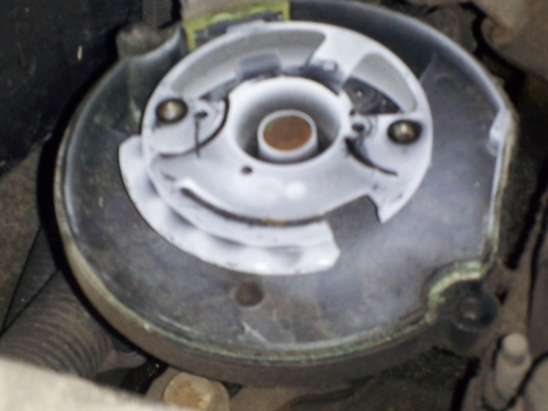

this is what it looked like under the rotor.

well the plug looks fine. in fact is does not look like it has had problems at all. from this point on tho use acdelco or delphi parts only tho. tho you can use autolite plugs. does the spotting the the rotor wipe off an do you have a full view and inside pic of the dizzy cap? i want to see the inside terminals and body surface look inside and the center button. how about the plug where you found the loose spark wire? i take it the white stuff on dizzy rotor wipes right off?
