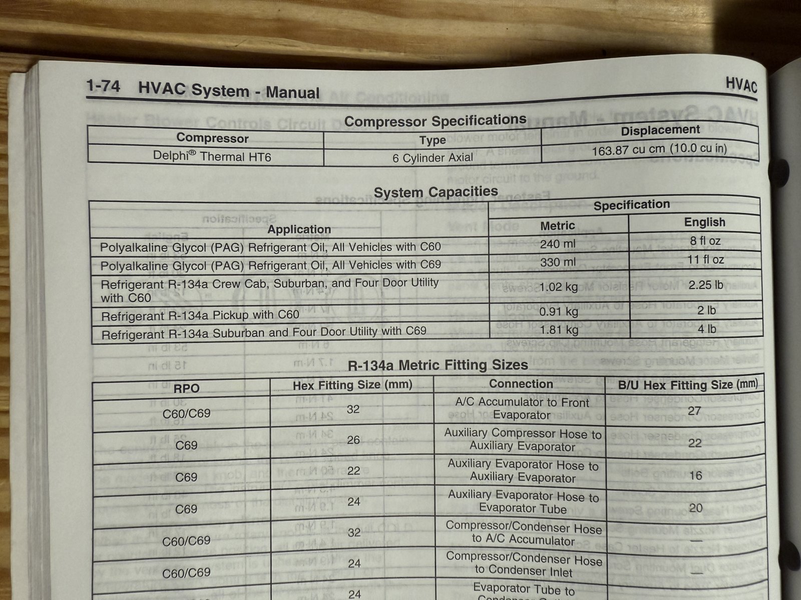

For what it’s worth, here’s the page from the 1998 manual. It doesn’t mention the 2-door or why any of them without rear air wouldn’t have the same capacity as a pickup since they, presumably, have the same a/c system.
