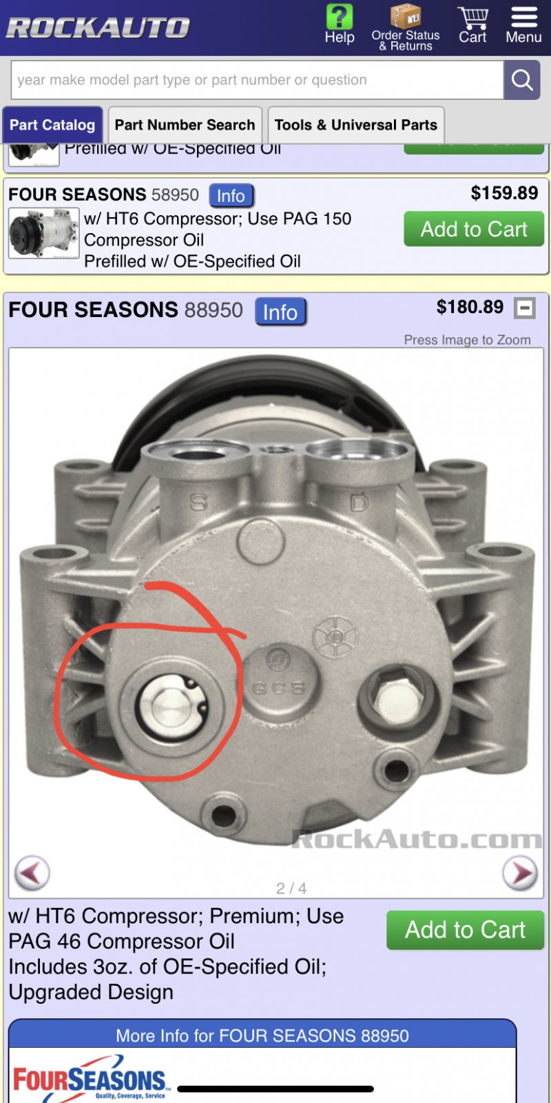

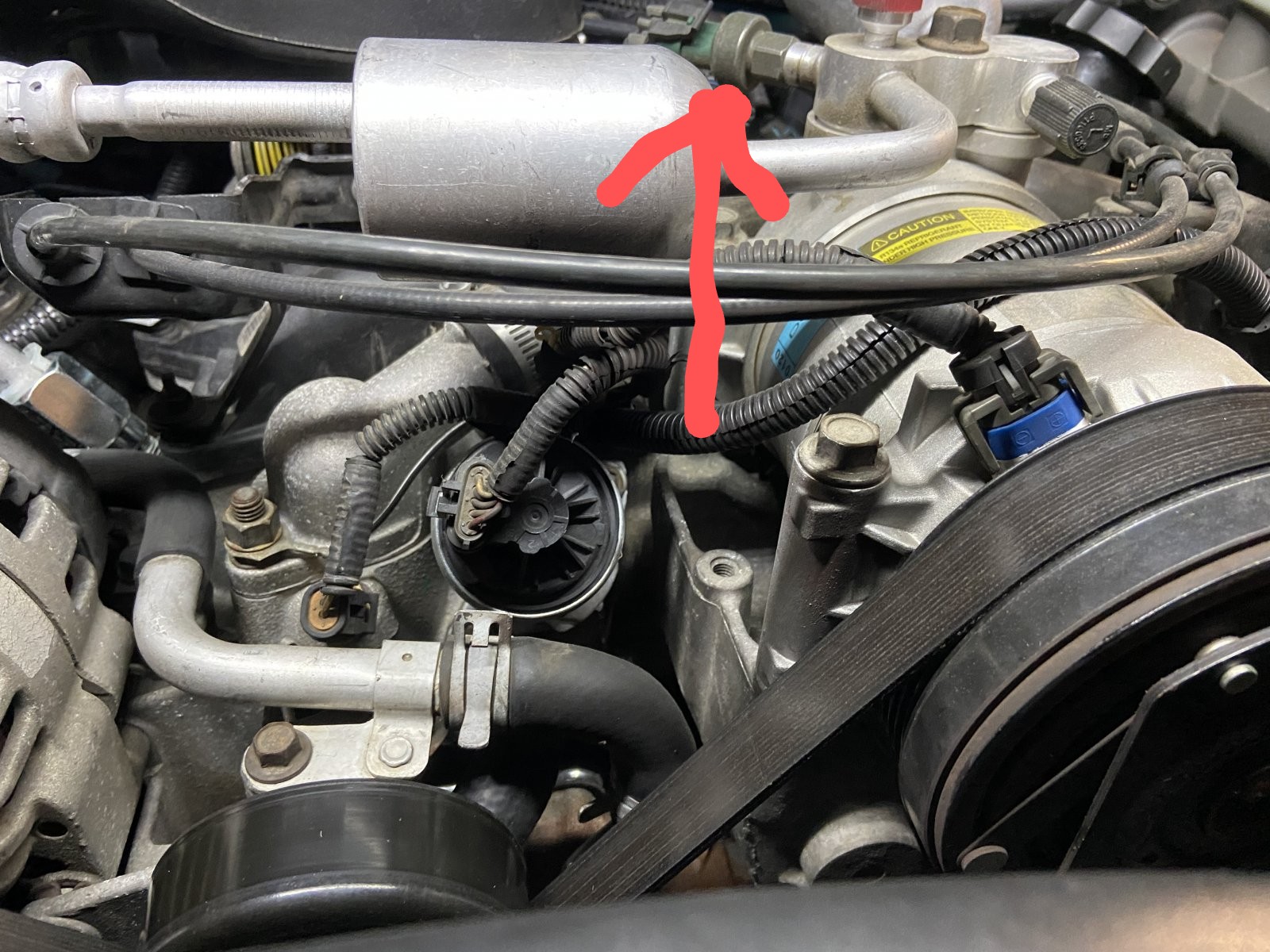

Did it come with the snap ring and plug? That comes out and the switch goes there.
The harness splits into four at the EGR valve. The wiring across the compressor goes to that switch, the other three to the coolant temp sensor, the EGR and to the compressor clutch.

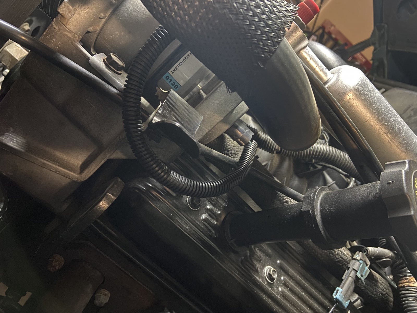

Thanks for your help. I managed to find the problem.
It seems like one of the previous owners has messed with the system.
Thats probably why the sensor was missing on the old compressor as well. I found the cable and connector tucked between the valve cover and intake.
Right now I used a jumper to make the system run.
I might order a new switch. Can it be installed with the system charged and compressor installed in the vehicle?
