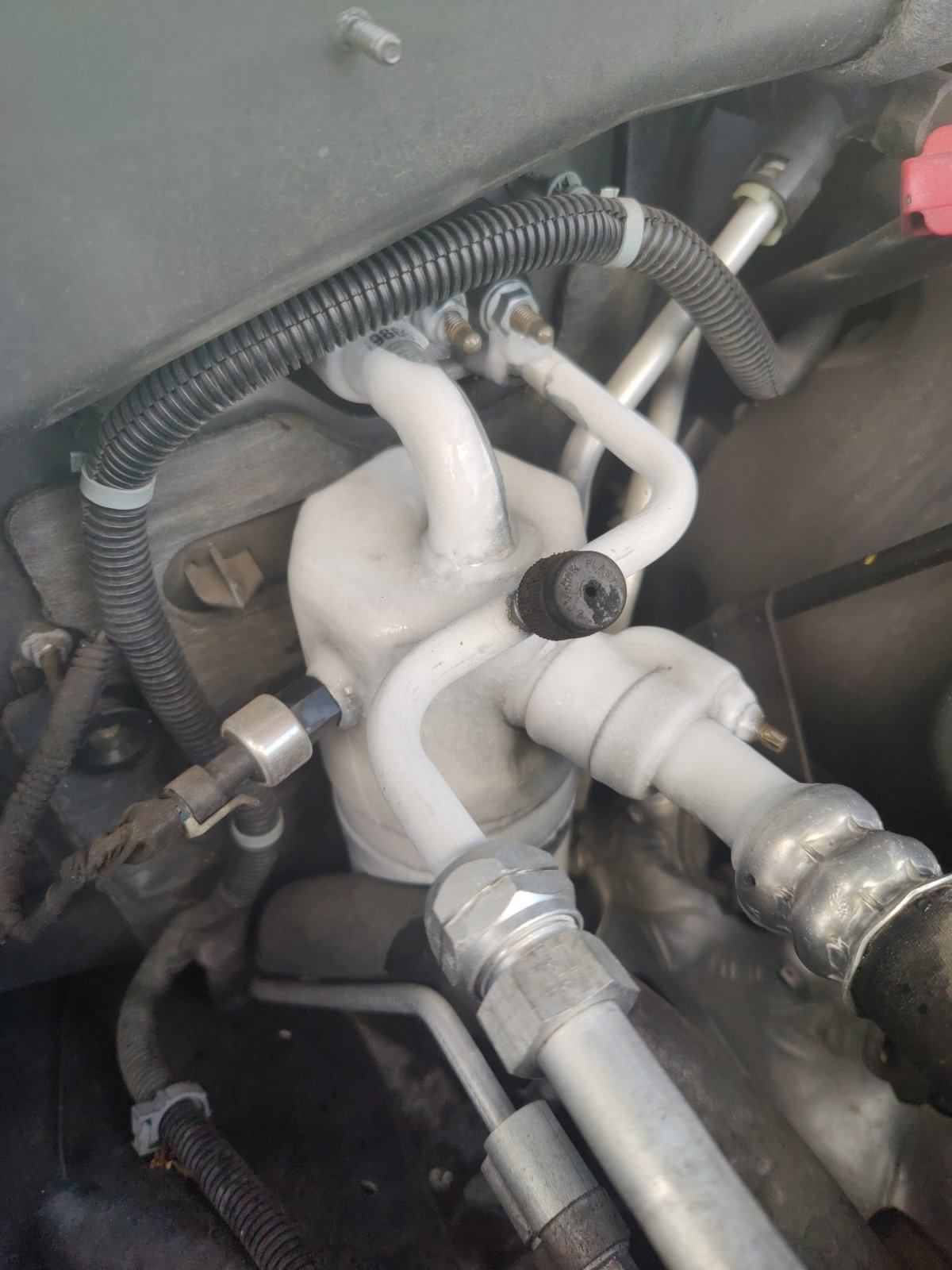

2006 Yukon XL Denali
When driving on highway for a period of time, front A/C vents stop blowing at the levels they should. Cycle to floor/defrost and nothing changes. Slow down to city driving and in less than 5 minutes, fan blows normal.
Do not recall having an issue with rear fans.
Not sure where/what to check as I cannot reproduce the results when at home.
Thanks in advance!!!

Update: seems to happen when driving highway speeds for a little while. Once I went back to lower speeds, no problems.
See attached photo - this is what I had after getting off the highway. Drove around another 30 mins, at lower speed, and never froze again.
