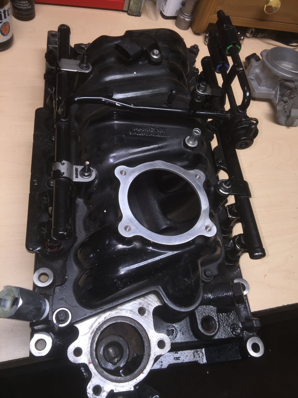

I've decided to just go ahead with the manifold swap so I can put in some 36lb injectors. Stock are 19lb which just isn't enough fuel for this thing. Only draw back is this marine intake is a boat anchor. It's heavy as hell. I'm going to have to change out throttle body or at the very least make up an adapter to mount my bored out TB to this intake.

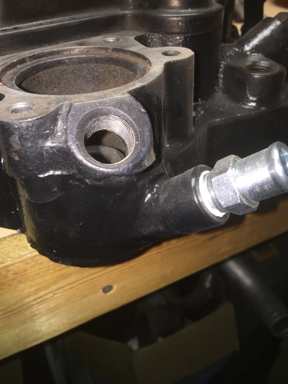

Marine manifold had to be modified a little to make it a direct fit. There are no provisions for thermostat bypass hose, temp sensor or EGR. But as you know I'm doing away with EGR valve. Good thing is there is plenty of meat to drill the holes I need for hose and sensor.
I used some epoxy to ensure a leak proof connection on bypass hose. Inside and out.

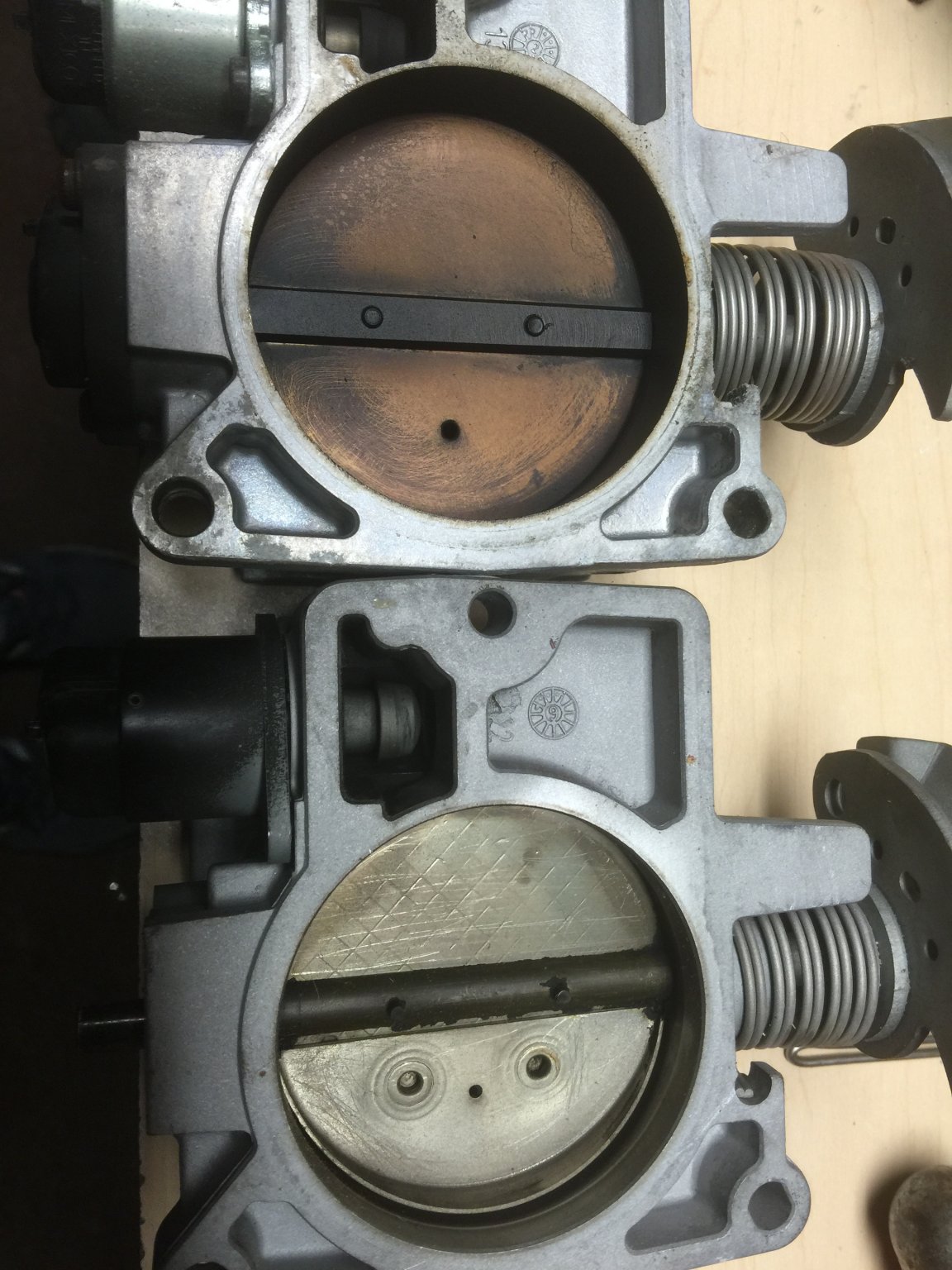

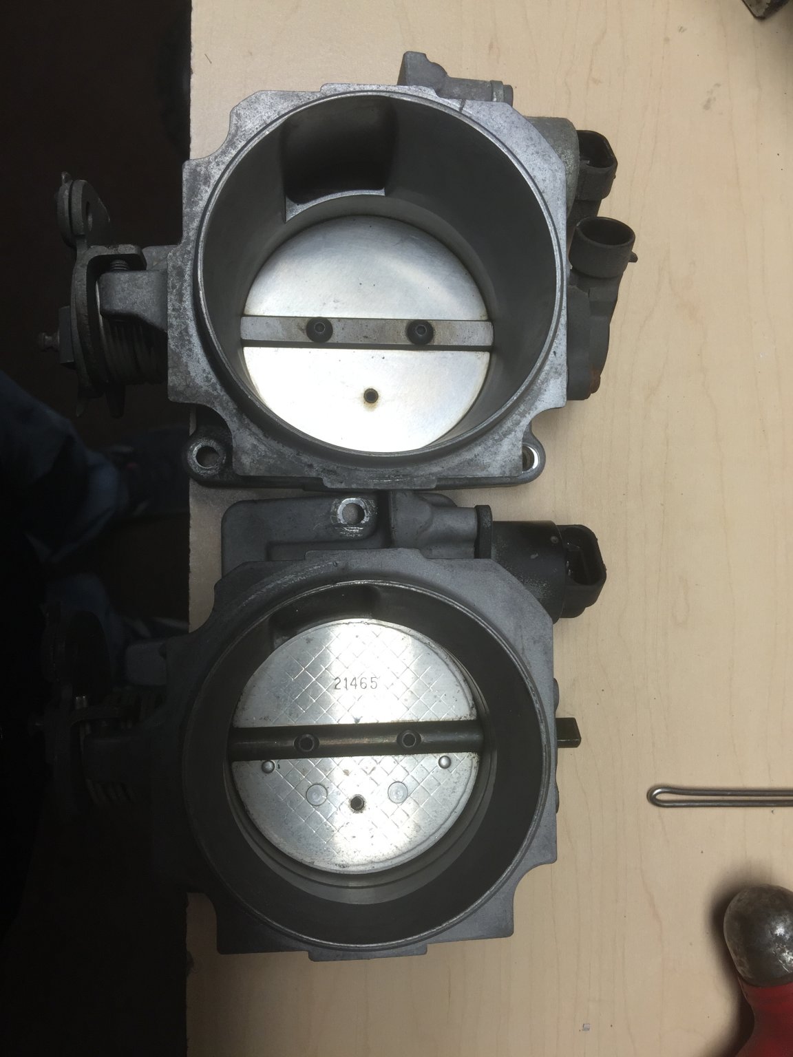

I may end using a throttle body from an LS. I will put a 90* elbow on intake and reroute my intake piping to it. I originally was going to use my bigger throttle body but I think I can get more air thru an aftermarket LS TB.
Here you can see stock vs bored unit. I've seen a lot of TB for this intake that they say are bored but use the stock butterfly valve which kinda defeats the purpose of you ask me. I found this one a while back, can't remember the size off my head but it's bored all the way thru. Bottom is stock, top is unit I just took off.

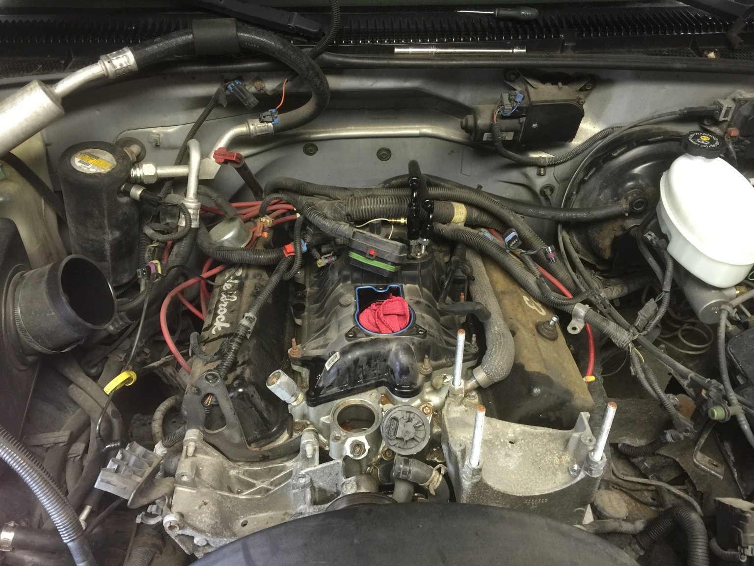

Making progress. Not sure how much farther I'm gonna take it tonight. Might get the front brackets all the way off and remove water pump. I won't drop oil pan until 2mrw so I can get front timing cover off. I still need to order new front cover from EFI Connections and camshaft. I'm wondering if I should even do the cam now, but while I have intake off it would be the best time. Otherwise I'm gonna have to take intake off again and this thing being so heavy, may just want to do this once.
I'm looking at this EGR tube and I'm hoping I can get it off shorty header without screwing it up. I think if I have to pull header to weld it, I might just go to a full length header. Shit is starting to add up on me real quick.

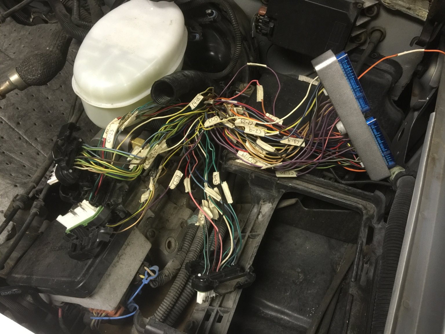

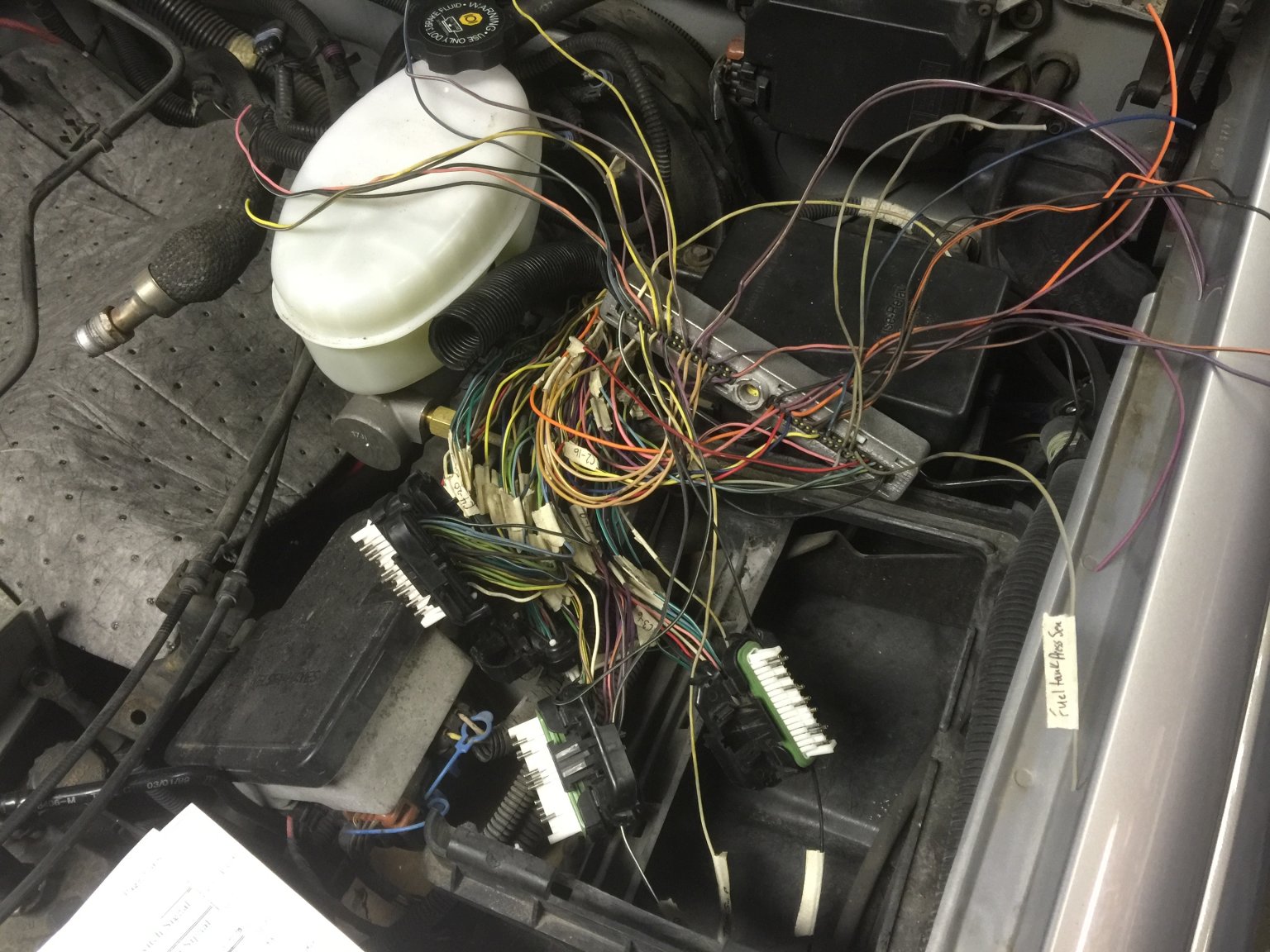

Started pinout on connectors. I only got one done tonight and that's all I could do. I've been sick the past 2 days and I was tired of just laying around so I got as much done as I could.

Both connectors are done. Pretty straight forward swap. No surprises, just a few wires that didn't seem to cross reference but I got it figured out. Added wires for cooling fans that I still need to install relays for but that's easy enough.

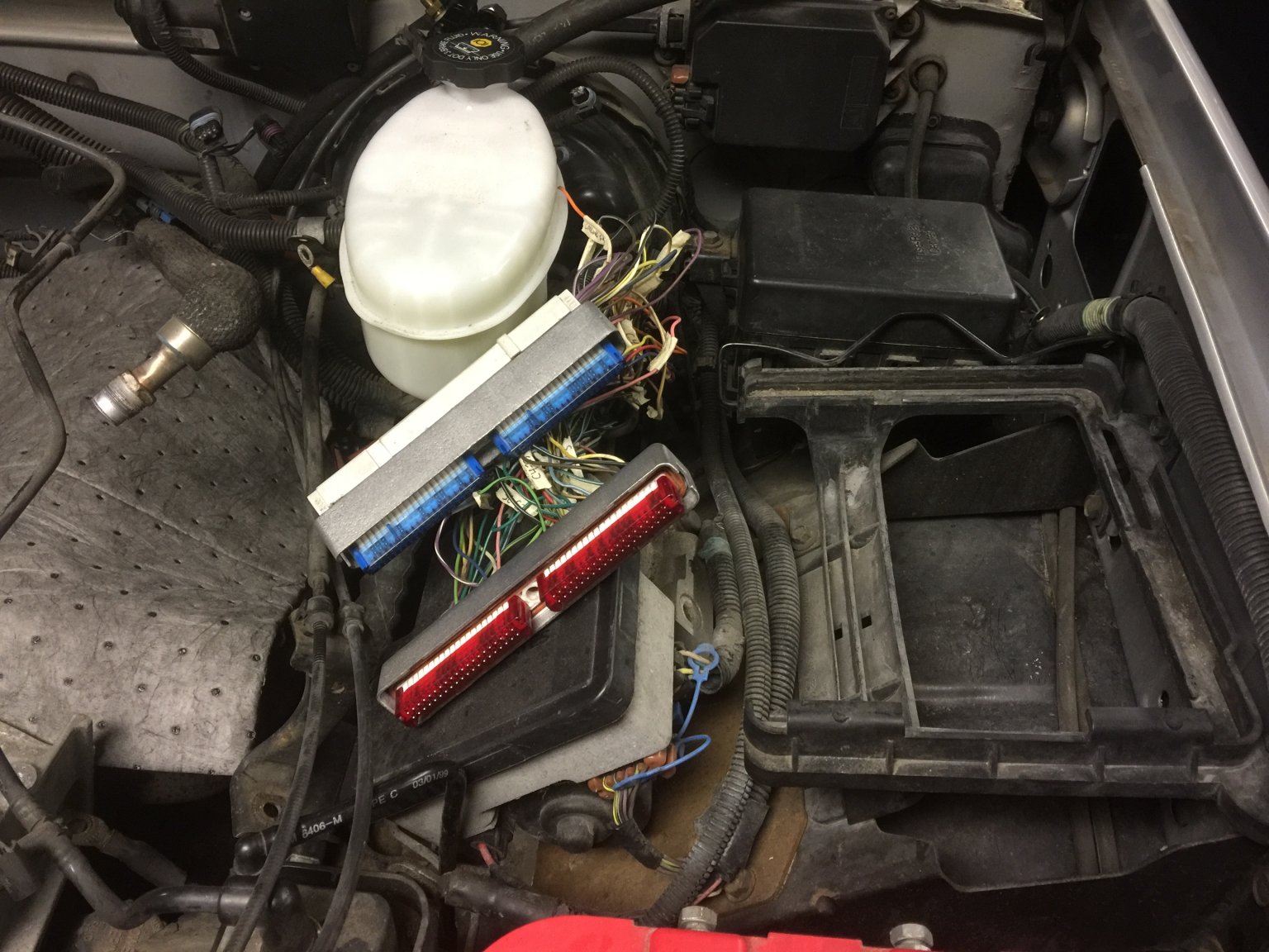

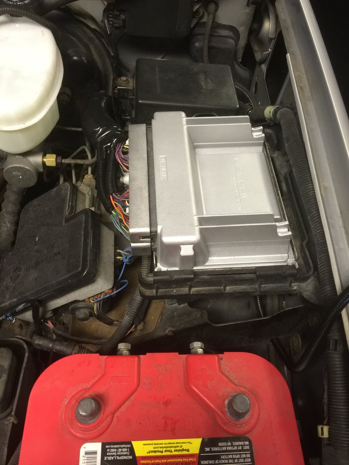

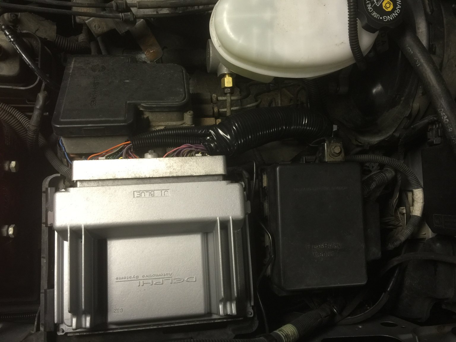

PCM is done, in and wiring tucked up.
I think I'm gonna make a new bracket to secure the PCM to. This one sits in there nice but I don't like any concepts I came up with to secure it. A new bracket would be better. I will come up with something soon, have a few sketches and ideas. Shouldn't take but an hour to make.

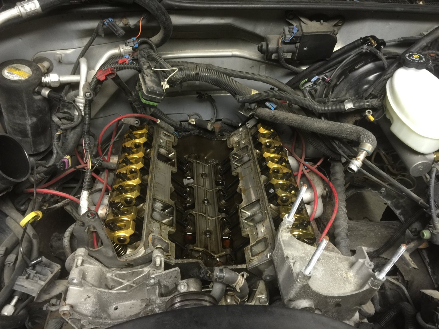

You bet I can't. I called my machine shop and talked with him for about an hour. Kinda just ran things past him and he nicely knocked me off my high horse. Long story short, wanted to sell him my E-tech 170 heads and buy some 200's. Told him I'm changing cams (226 - 230 deg) and possibly bolting on an S475. Told me the smaller runners and valves in the 170's will give me better throttle response and the S475 is more toward a higher RPM and is in the 800-1000hp range, would be laggy on my engine. Told me stay with a smaller exhaust housing to spool quicker like a T70. Has an engine in there right now that makes 468hp/443tq on engine and is 600ish with turbo. Pretty close to my setup besides rockers, cam and running a blow thru 750 carb. Said I should get to roughly 550rwhp on 9.5:1 comp, pump gas, single turbo with .96 exhaust A/R. So he's gonna work my heads a little and swap out springs for me. Now I have to pull heads off. I'll start on that this morning.
