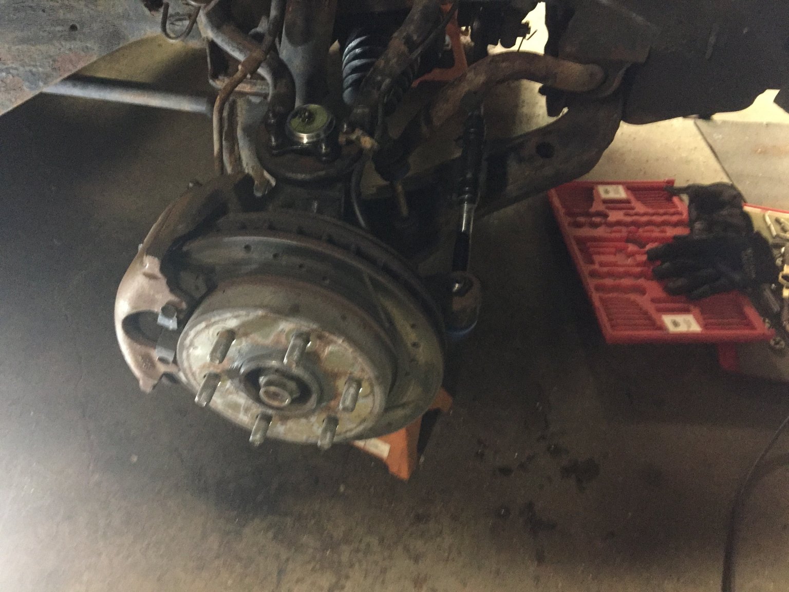

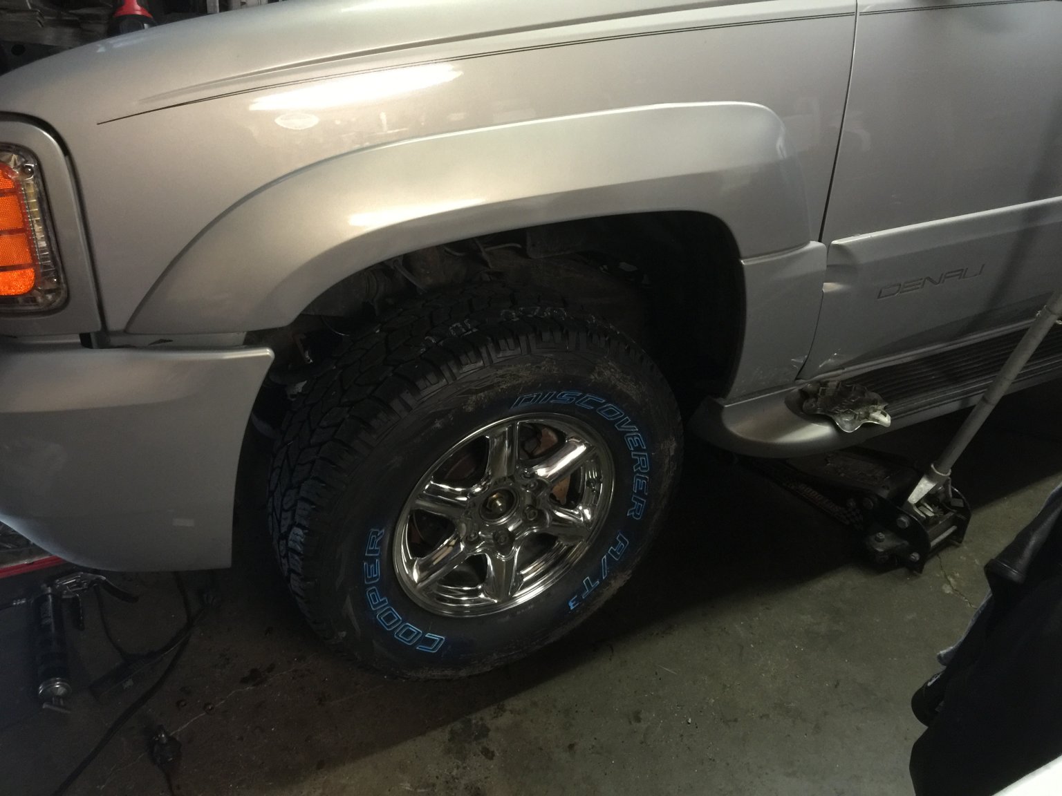

Drivers side apart.
Time to put parts thru parts washer. And decide if I should replace shocks or not. I want to go to coilovers and ditch the torsion bars. I'm here, should I fab some brackets to enforce the shock tower and lower mount or should I wait til I do both axle swaps and lower it a few inches? Decisions decisions.

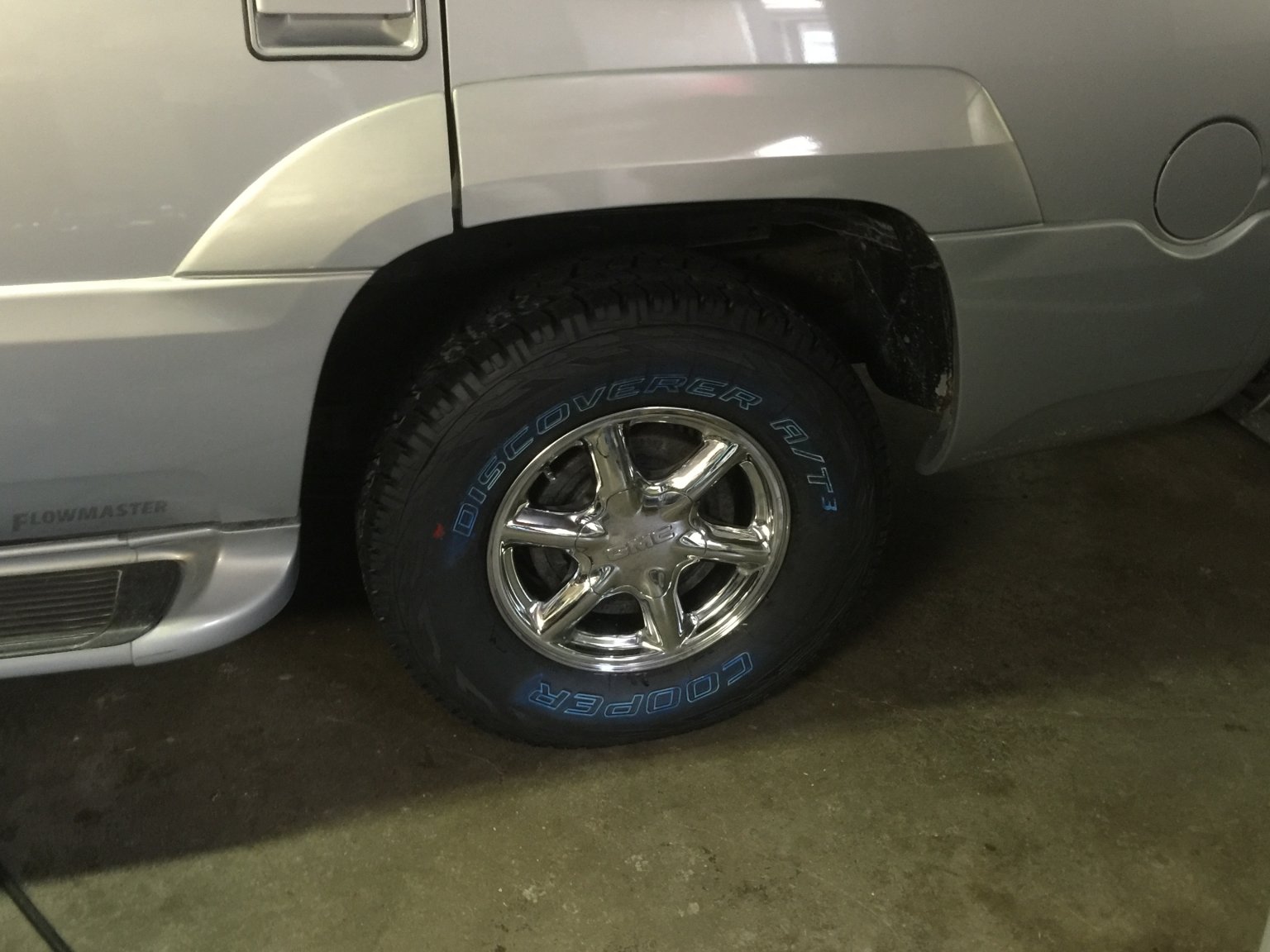

Tires mounted and rears put on. 3pm Tuesday and I've been up since 6pm Monday night. I think I got my rear tire on bike running true but looks like a ****** day Sunday with possibility of snow. Toys for Totts may not happen for me this year. Oh well, like the Cubs fans USED to say, maybe next year. Lol.

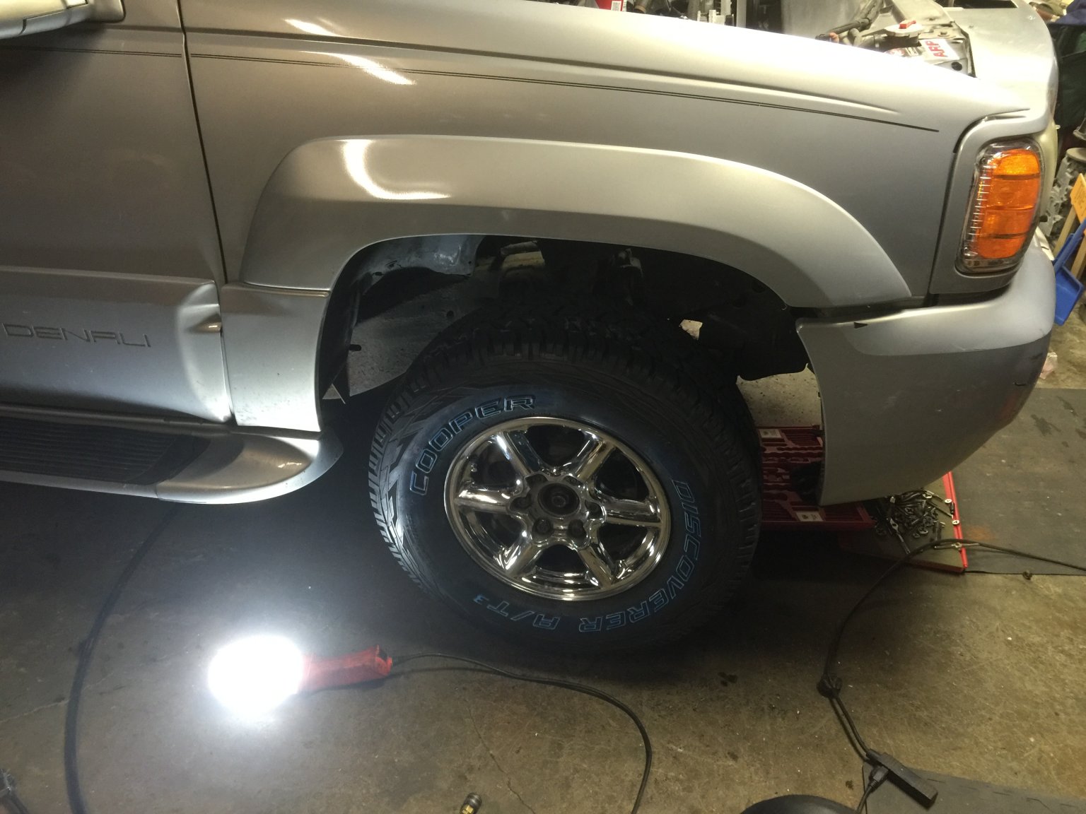

Cutting it close. It's 7 and I have to leave by 10 for work. Gives me 3 hrs to get passenger side done. Drivers done and on.
Didn't get to paint frame and control arms. I couldn't separate hub bearing from spindle without putting heat in spindle and since I'm not replacing these hub bearings I didn't want to heat. Oh well, it's winter anyway, I'll have a long summer to slap on paint. Back to work.

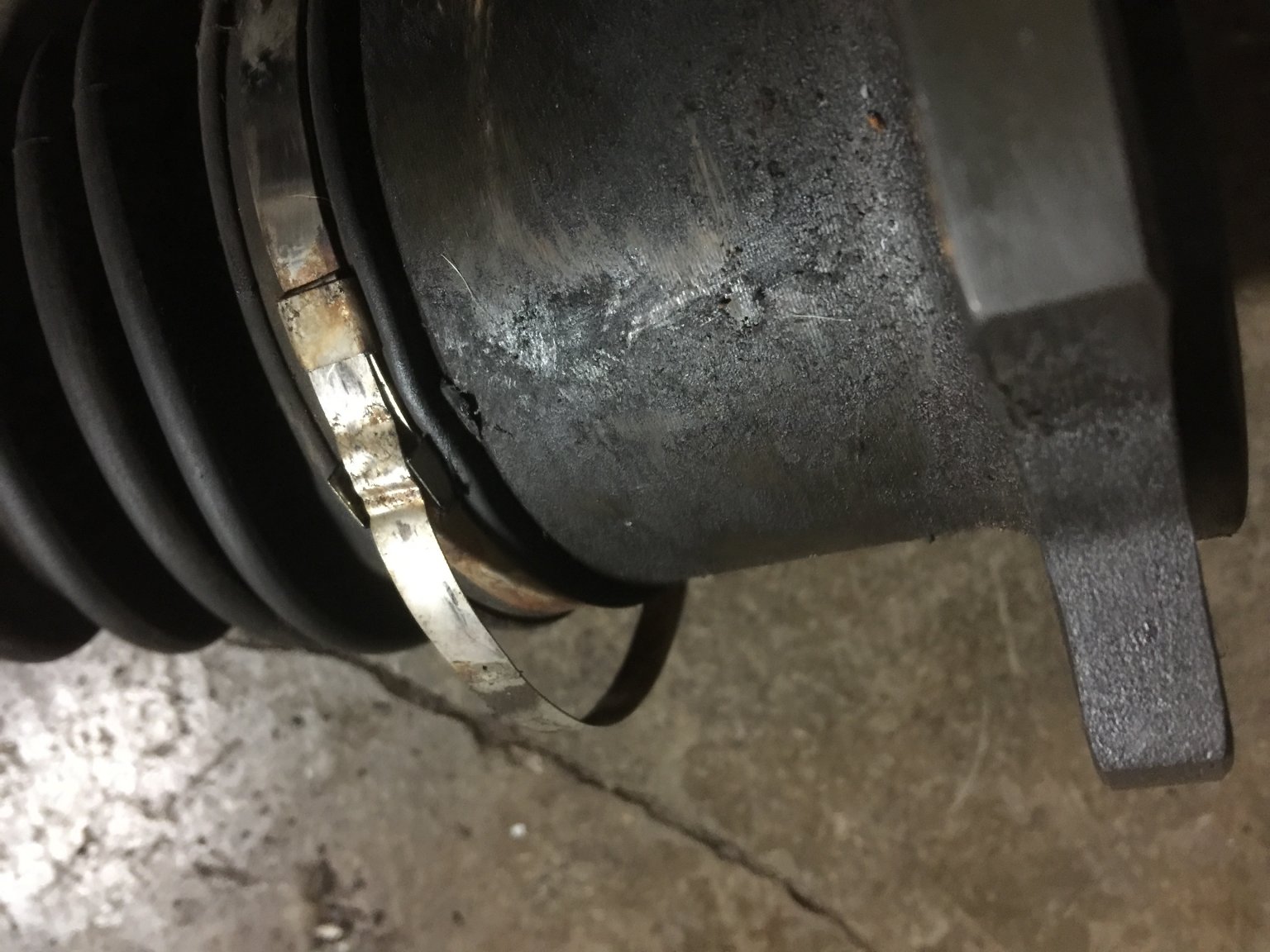

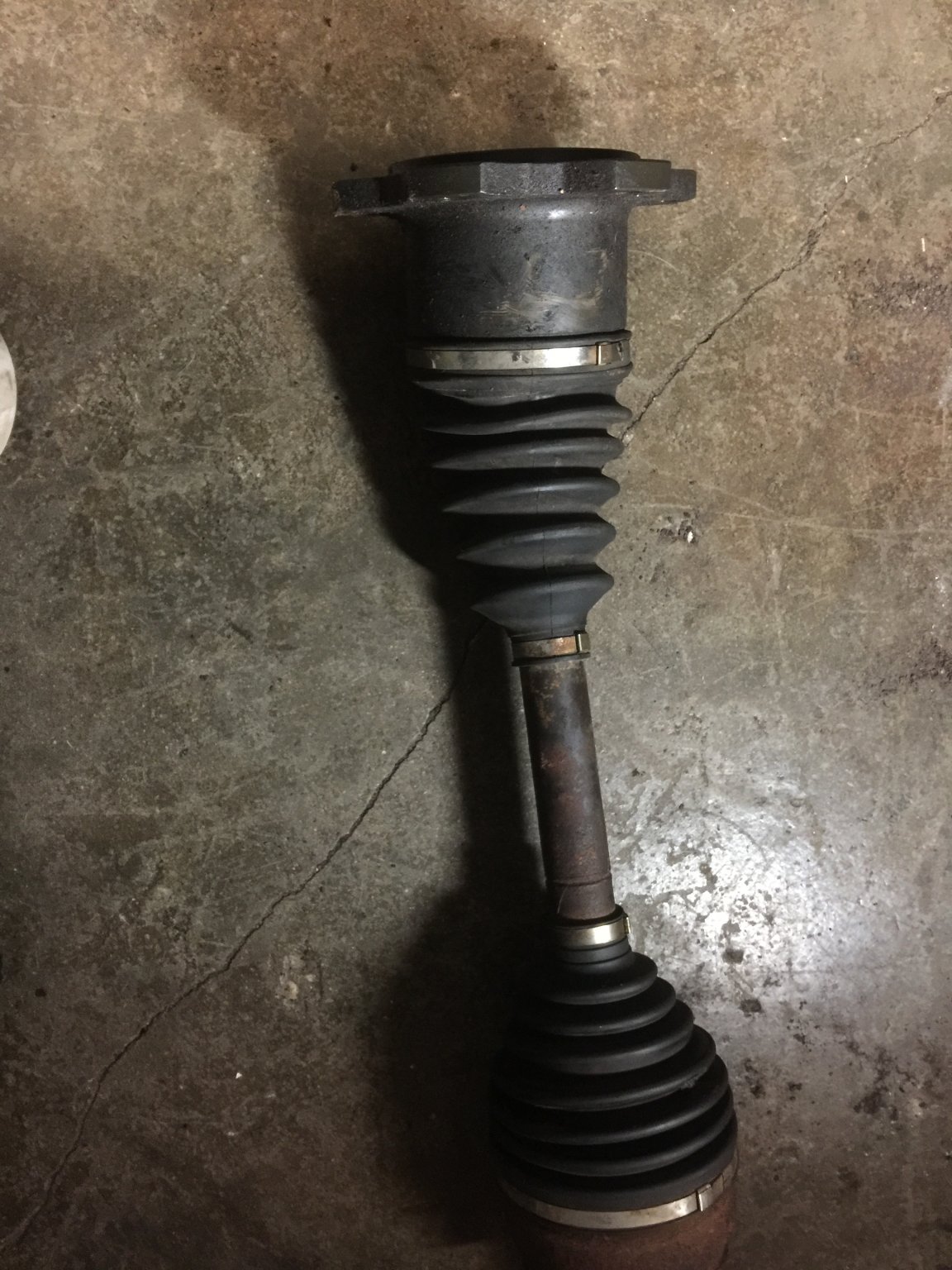

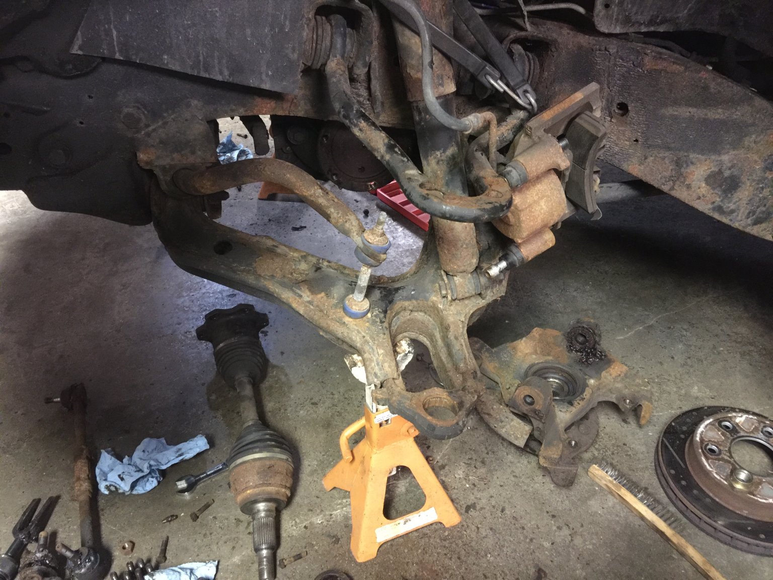

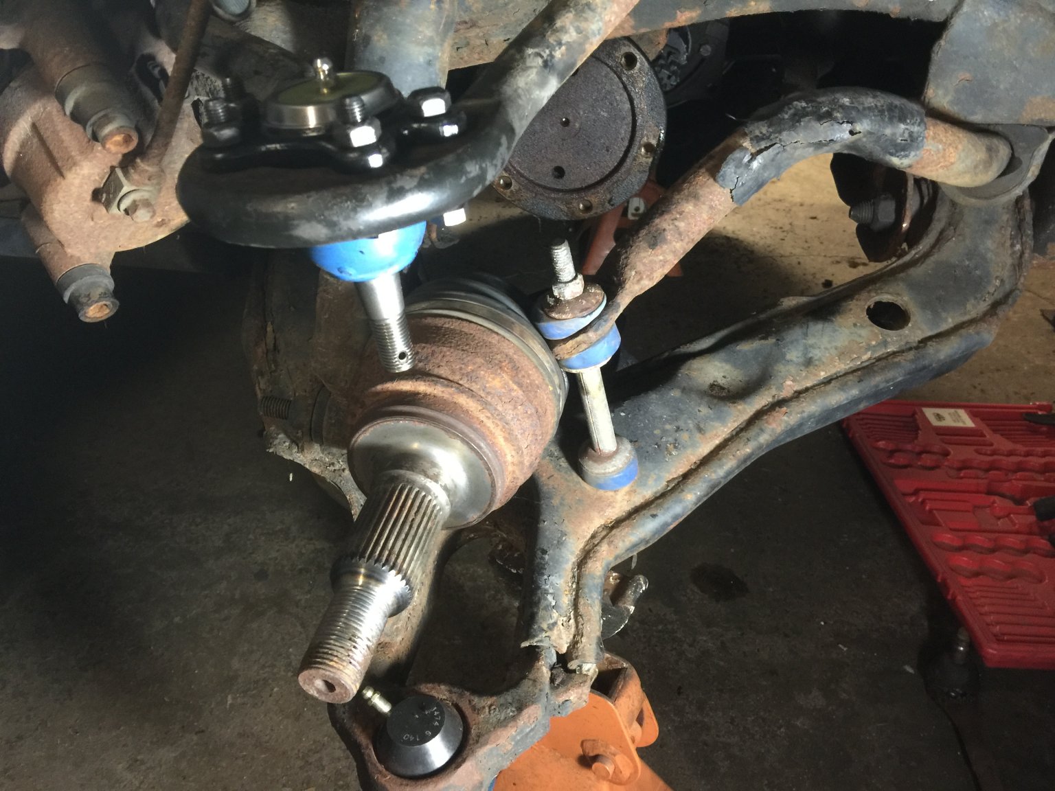

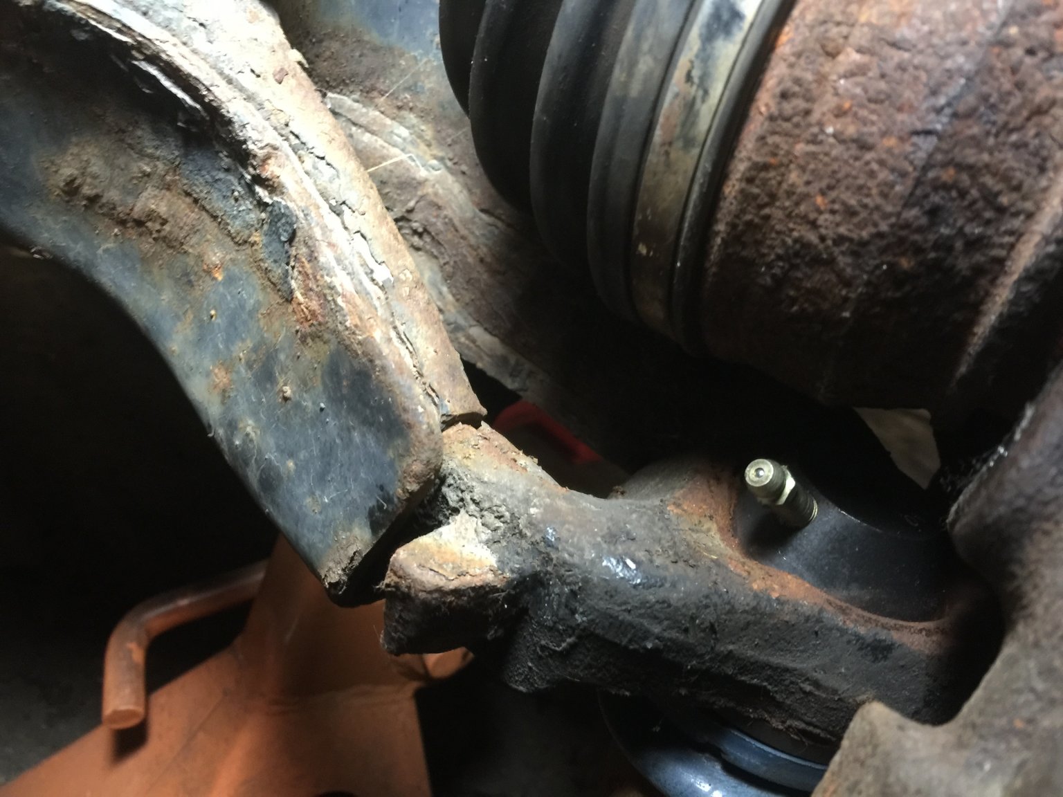

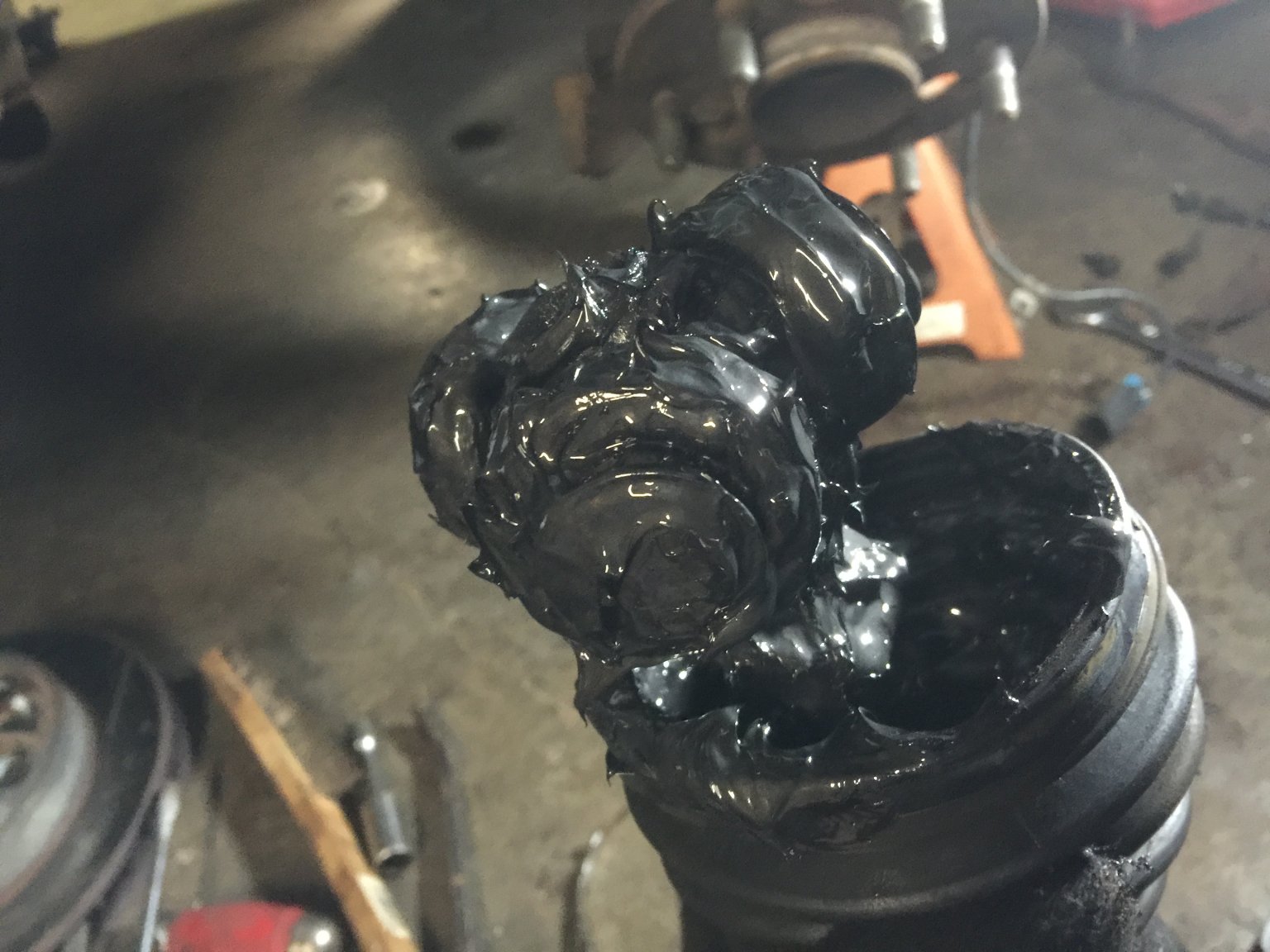

Here's a little issue I ran into while pulling passenger side apart. I took nuts off ball joints and CV shaft and when I lifted top arm to separate balljoint from spindle, the spindle leaned outward and instead of CV splines sliding out of hub, it extended CV shaft. When I tried pushing spindle back up the CV didn't want to collapse. It was binding so I just removed bolts holding CV to diff housing flange and removed shaft all together. I usually leave shafts in when I do ball joints but I figured I was going to remove them anyway to clean and paint but it never happened.

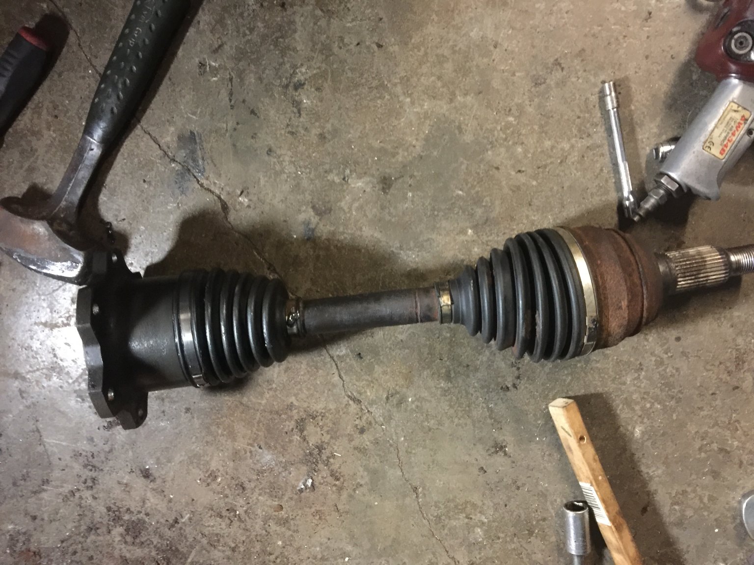

Anyway, while going back together I picked up CV shaft and then remembered it was extended. Look at inner boot, you can see its apart.

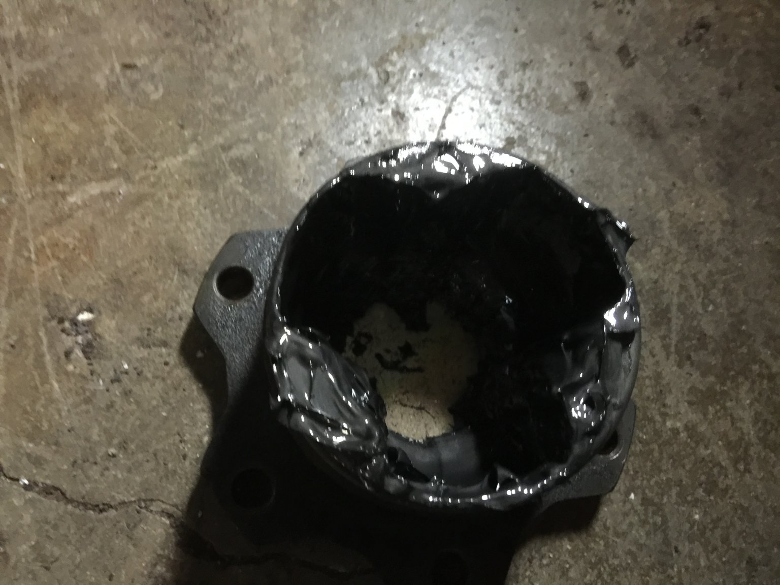

So I tried to push it back together, I even dropped the flange against the floor a few times thinking it might pop back in, but didn't. I had to remove the band holding the boot on.
With clamp removed I pulled it apart to see what the issue was.
Everything looked good. It just popped out and needed some persuasion to go back together. I was able to get it to go back in with a few taps with a dead blow. Reattached clamp, I didn't have any 4" clamps to replace it, I will Sunday most likely. Clamp did pull back together nice so it should be ok but anyone who has ever had a boot rip or come loose knows how nasty it is when the grease flies so I'm replacing it. But here you can see how the boot should look when it's relaxed.

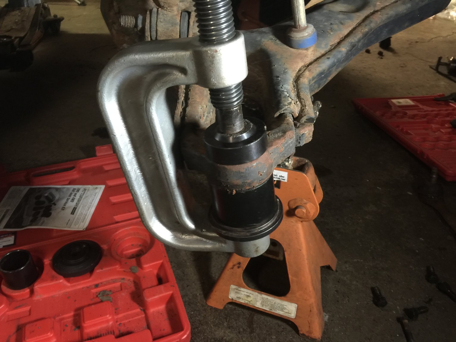

For those that haven't done this kind of work, here's a little run down of how it goes back together. I'm sure that if you see how it goes together you can figure how it came apart.

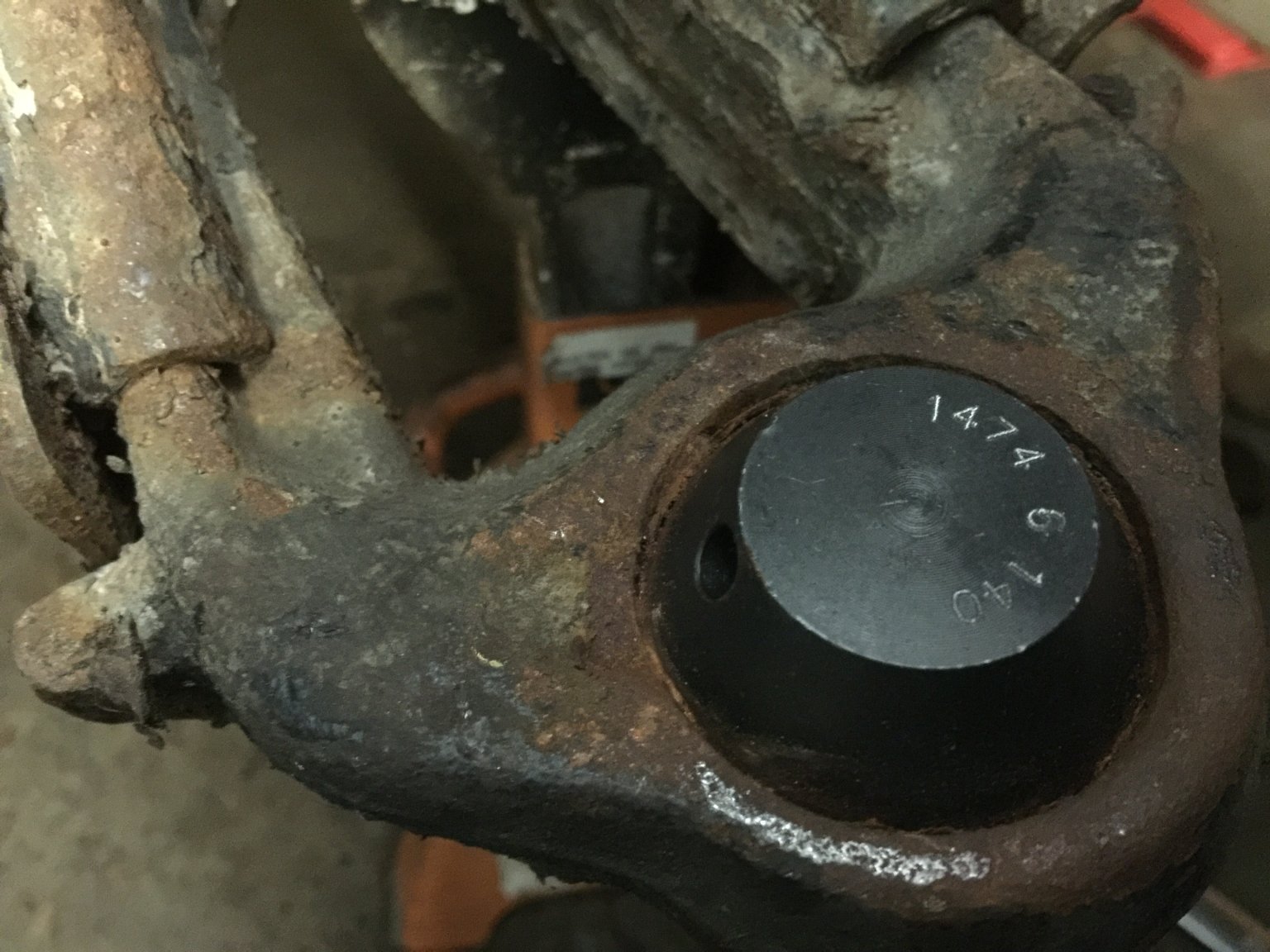

Bottom ball joint is a pressed fit. You need a press to do this.

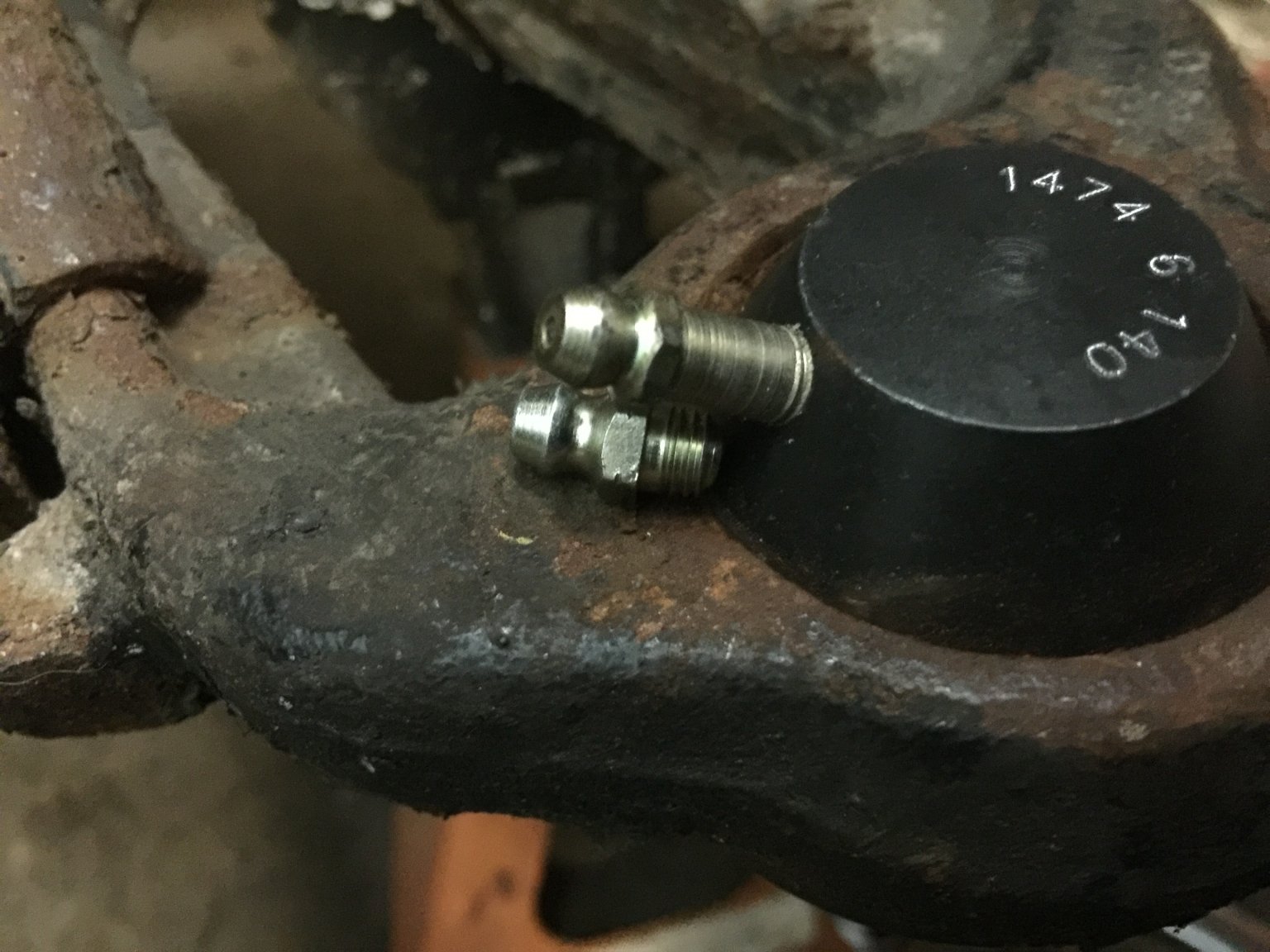

You have to make sure you line up the grease fitting hole with a little recessed area on lower arm. Not sure if you'll be able to see the recess on the arm but it looks like this.
If you don't line it up it'll be impossible to get a grease gun on it. I hate them little grease zerks so I use longer ones. I have a stock pile of these just for things like this.
This joint looks like they actually moved the grease zerk hole a little higher on the joint. They were always lower and a tighter fit.

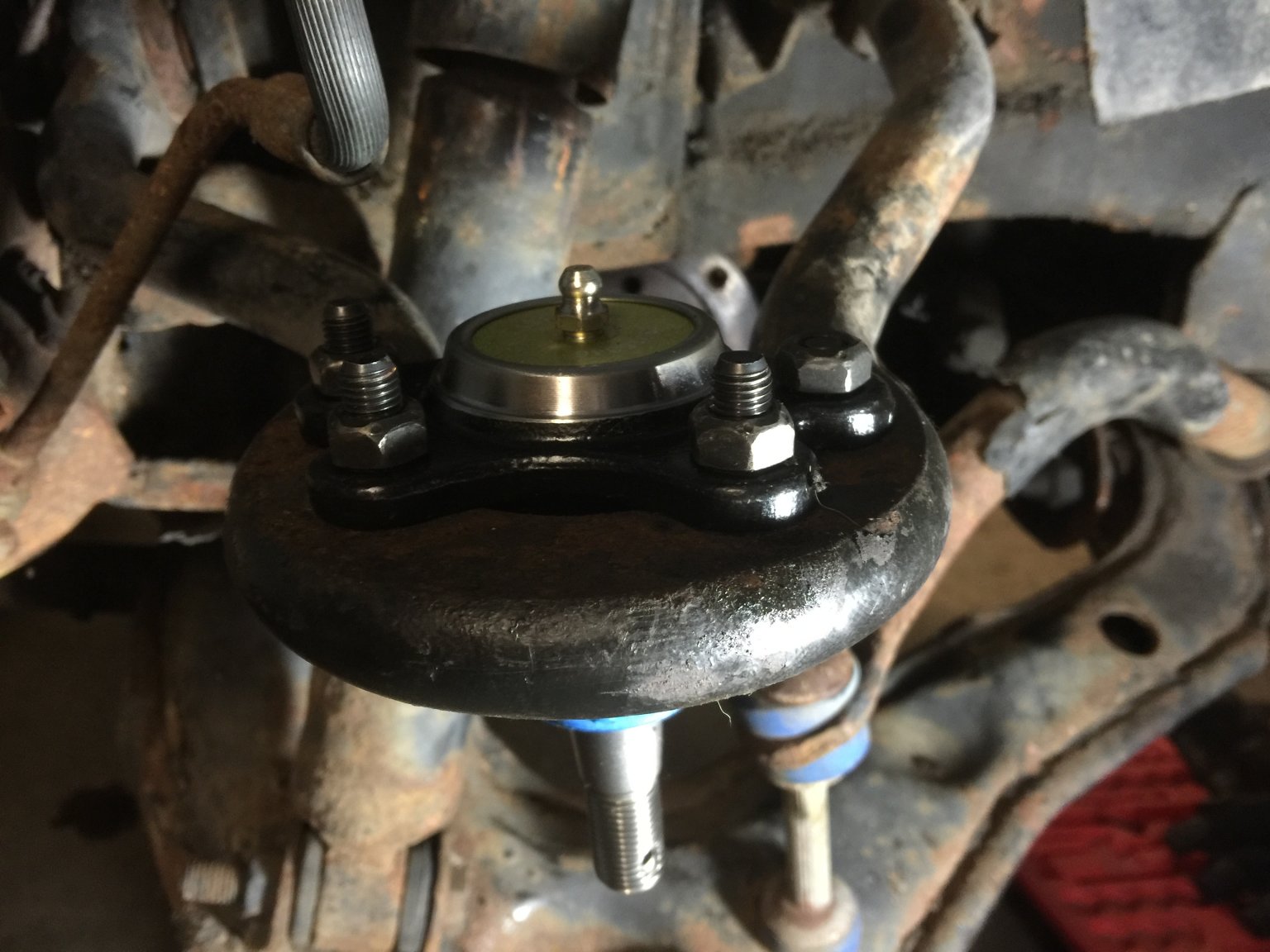

Upper ball joint bolts in. I always leave the inside front bolt loose because the ABS wire attaches to it. I've seen some guys bolt the joint to the bottom of the arm to keep the upper arm farther away from bump stop. That's more for lifted trucks and not necessary on this one.

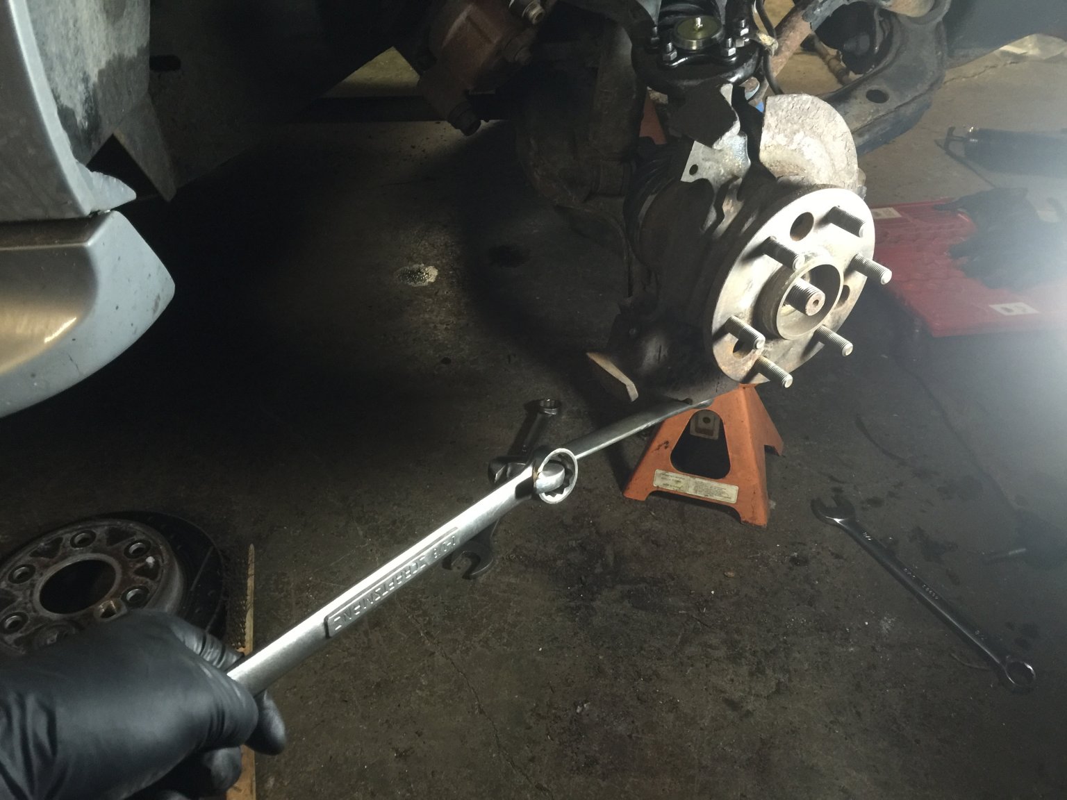

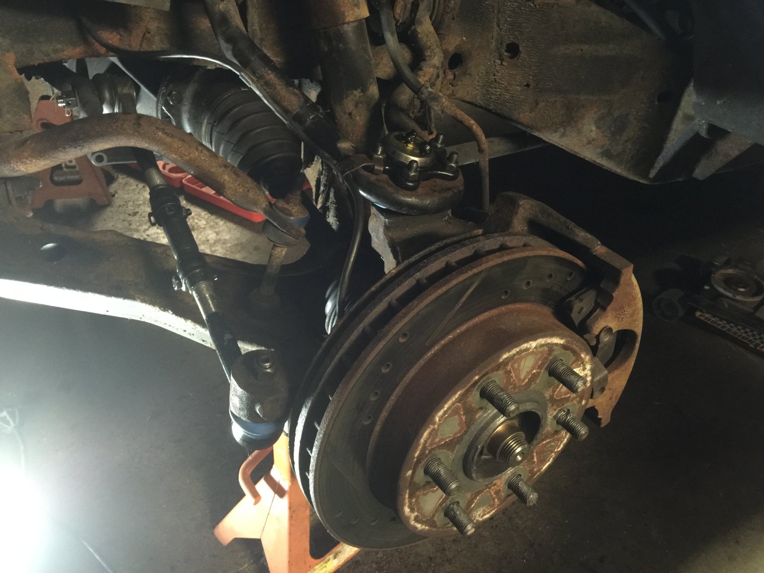

Now the spindle goes back on. Slide the lower joint in the bottom hole and get CV shaft back into the hub. Start the nut on the bottom ball joint and that will hold it up. You need to push the upper arm down to get upper joint in the spindle and then start the nut. Tighten the nuts down and the ball joints are done. I always like to double wrench the nuts to get them seated nice and tight. Line up the hole for the cotter pin and install pins.
Put the washer and nut on CV shaft and then I installed the flange bolts. Here you can see the clearance between shaft and grease zerk.

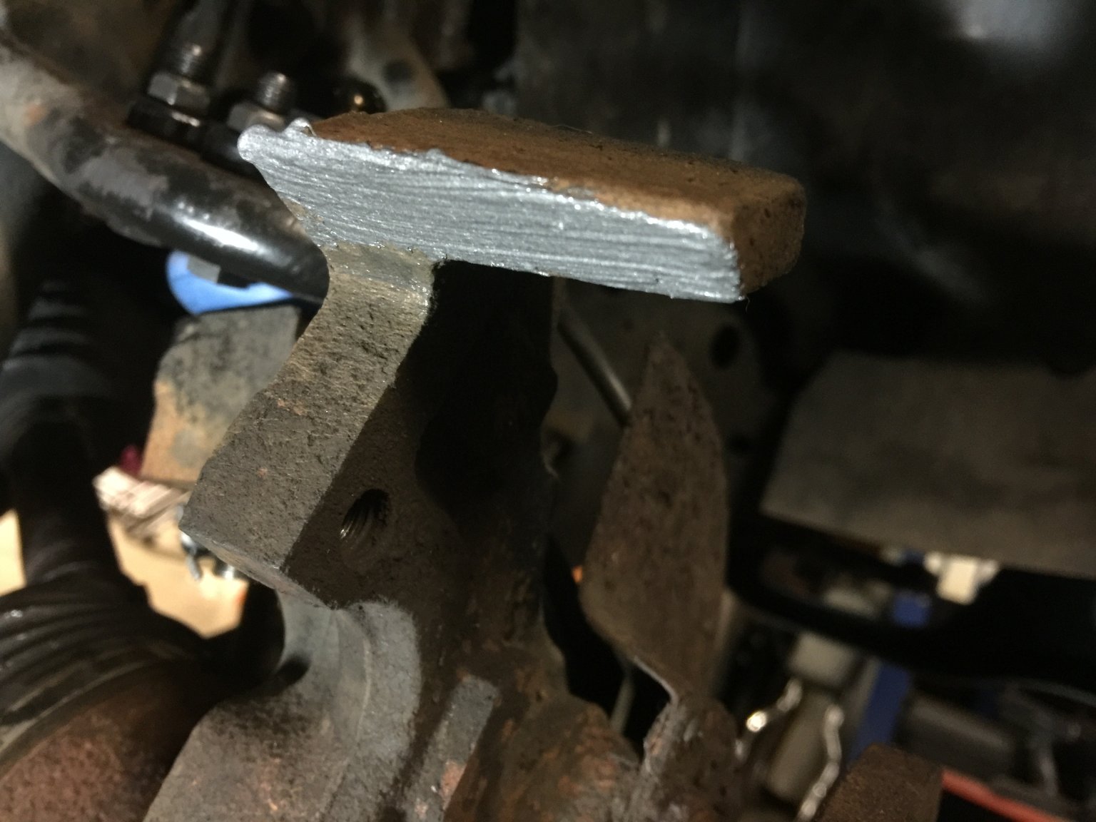

Now the rotor can go on and install brake caliper. Be a good time to check your slider bolts in caliper. Mine were good but if they didn't slide easily I would have pulled them out and greased them. I take a wire brush and clean up the surface area where the caliper slides and put a thin layer of antisieze on them to keep caliper from sticking or binding.
Then I measured old tie rod to get a length and set up new tie rods and adjusting sleeve to that length. I see a lot of people count threads but that's not always a good idea because tie rods can be threaded differently or have a different length. I measure from center of tie rod on the flat side to same point on opposite tie rod. Then tie rod assembly went on. Before tightening clamps on adjusting sleeve I make sure tie rods aren't cocked one way, make sure the ball is centered before tightening clamps on adjuster.

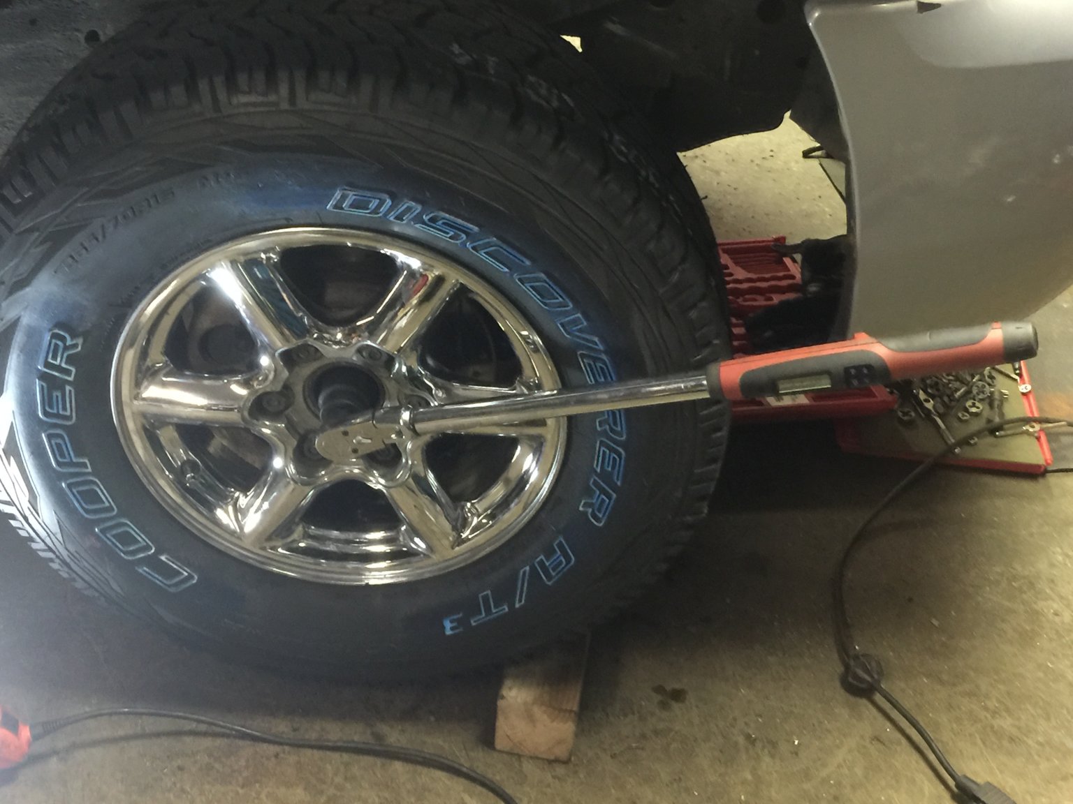

Then I put wheel on and placed a block of wood in front of it to hold it and torqued the shaft nut to 175ftlbs. This preloads the bearing and is important. You don't want this over or under tightened.
Then I torqued lug nuts to 140ftlbs. Took it off stands and test drove to see if my alignment was gonna be too far off to drive it to work. It was good. Still needs an alignment. Anytime tie rods are changed it needs alignment. If I was just doing ball joints it wouldn't have been necessary. And that's it. Back on the road again and this thing is like a different truck with these new tires. Man it feels good to have new shoes. I think I might even get better mileage from it.

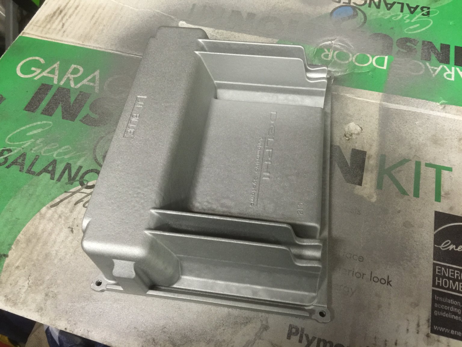

No updates as of yet. Been driving it more lately. I really need to figure out this fuel delivery system. I'm torn between the marine intake or just going to an LT1 intake. I have the E-tech heads so I can go either way, I'm not limited to the Vortec 8 intake bolt. I really just need external fuel injectors so I can play with them. Found an LT1 complete intake for $75. Looked at Fitech EFI but it would have to be a stand alone system and I need my OBDII system for emissions. Good thing is I don't have inspections, just a self diagnostic check at emissions station. Looked at Edelbrock Pro-Flo also but seems like the fuel rails will share realestate with my ac compressor and I'm not getting rid of that. Trying to find an LT1 with L31 Vortec accessory brackets to see if things will fit. Probably roll the dice and get it and work around issues myself. In the meantime, hope everyone has a merry Christmas and a safe and happy New Years.
And of course I have to leave a pic for the picture ******. Don't feel bad, I'm one too. Hahaha

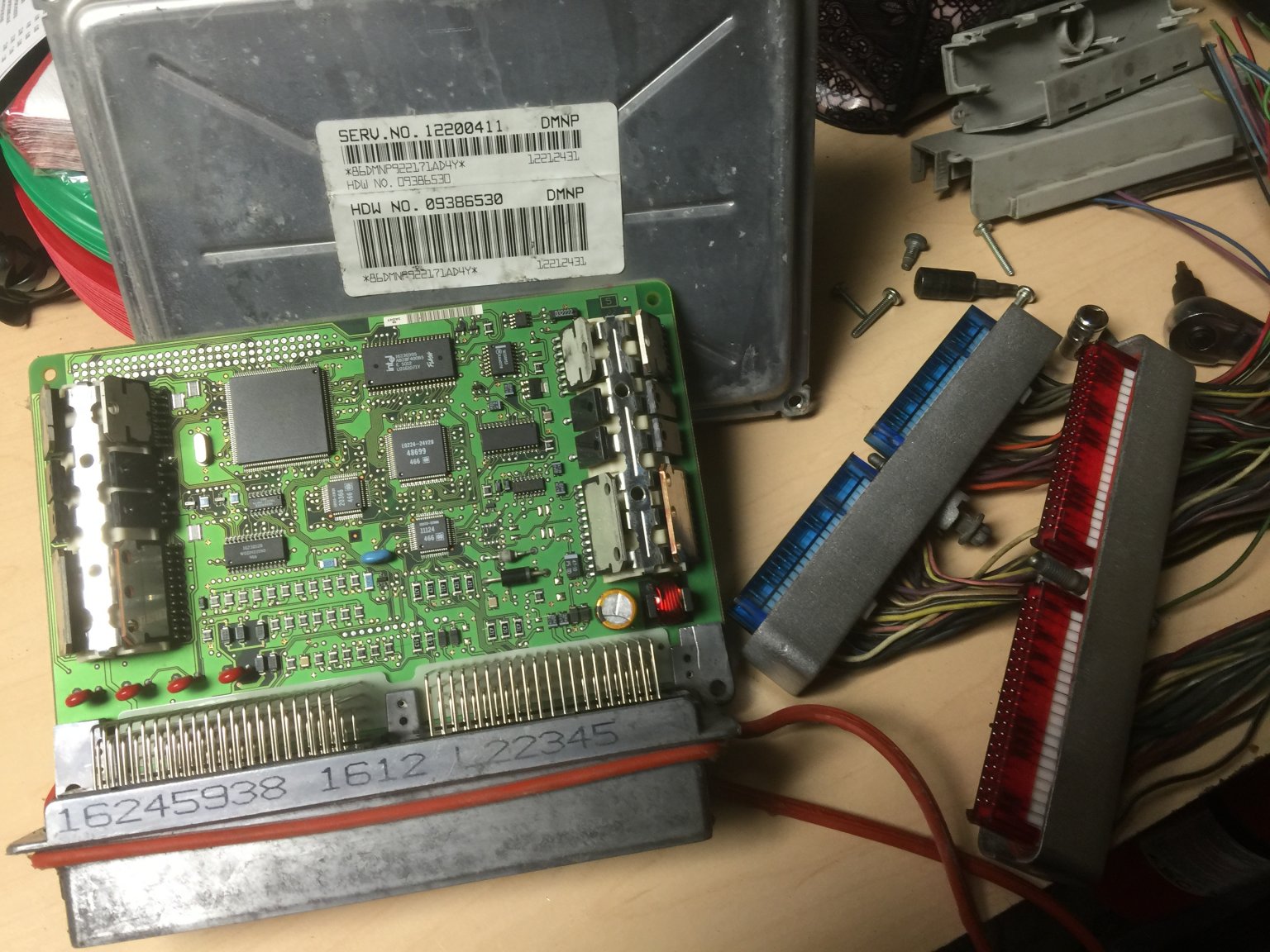

Anyway, I have to start with the PCM swap. Cheapest I could find one online was $90 programmed with my VIN. They couldn't do any tuning or deleting of VATS or EGR so I ran down to the local pick and pull and grabbed one from an 01 Chevy Express van that had an L31 and 4L60e for $30. That's the base tune I need to make this thing run. I've decided to buy EFILive tuning software and do the tuning myself. Going to be a learning curve but I really like that kind of stuff and been wanting to dive in. So the new to me PCM was nasty dirty so I removed the circuit board and blasted the housing and painted it with some high temp ceramic coating paint. The connectors I took apart and blasted the aluminum housings and then just buffed with a wire wheel. They look fine so I'll leave them at that.

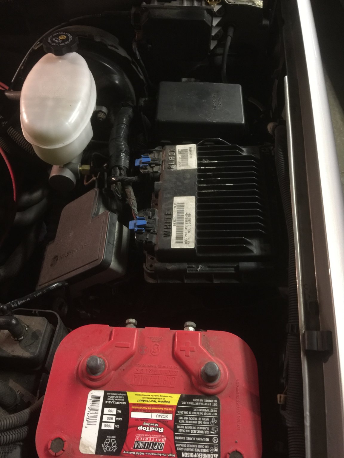

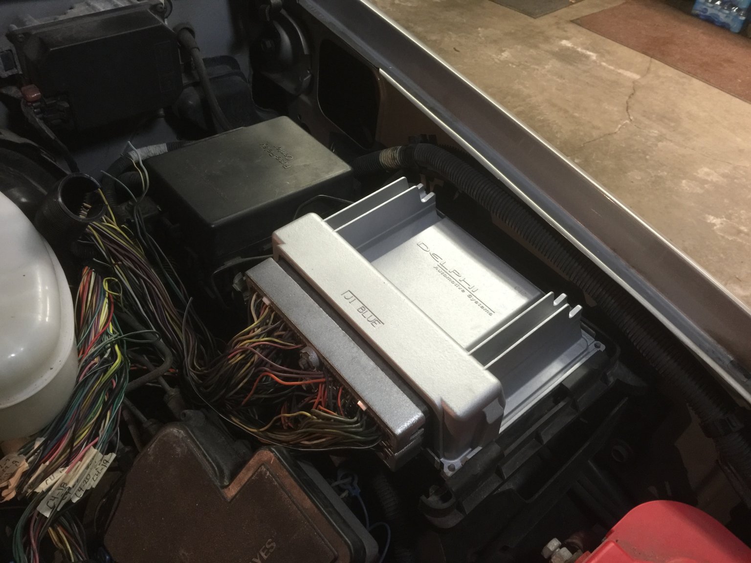

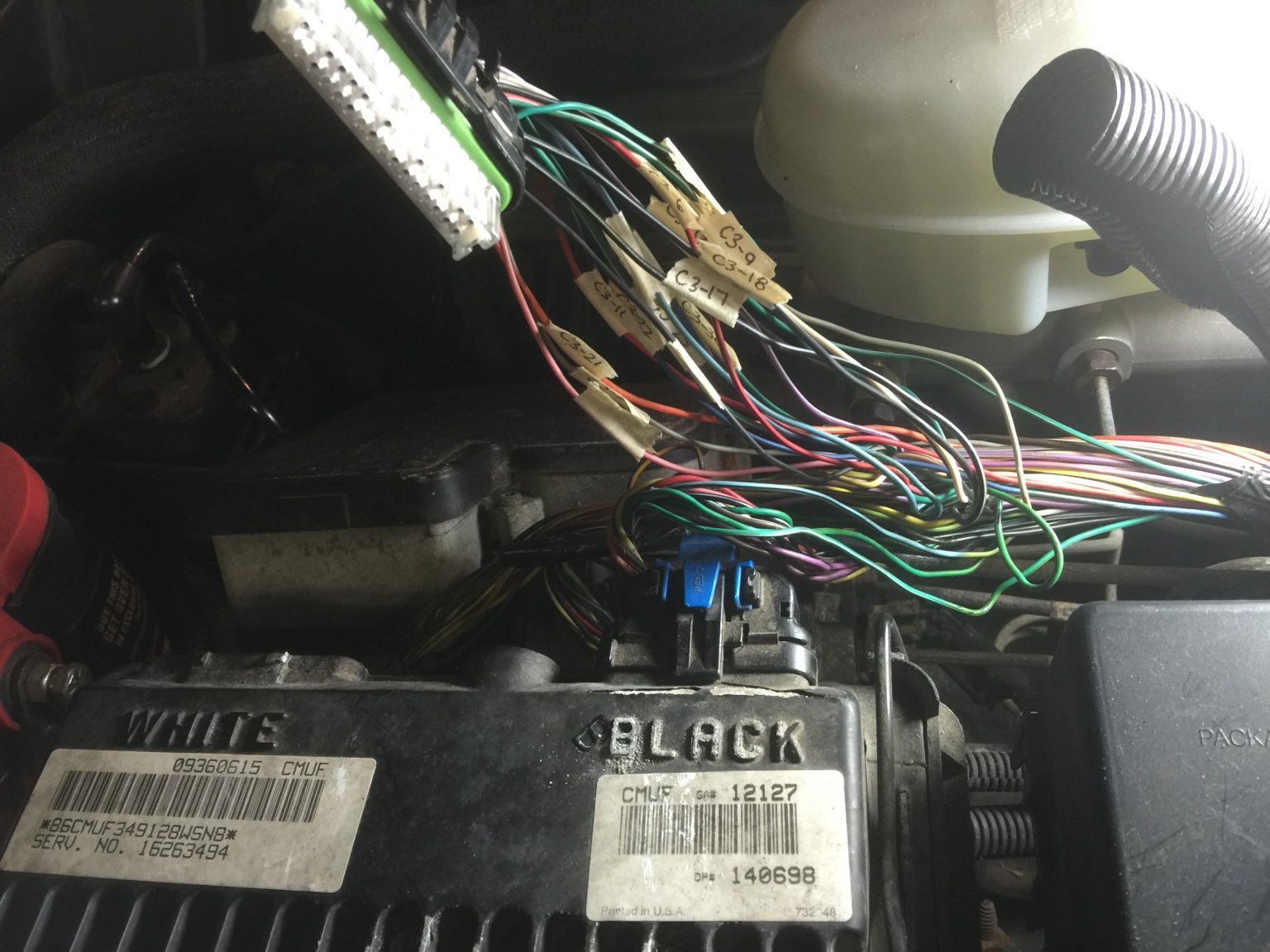

Starting to get things ready for the PCM swap. Have all my pinouts for both and started labeling the wiring. Looks like it's gonna be a straight forward swap. 0411 PCM looks right at home in place of the black box.
Stay tuned, pun intended, working on getting it wired and then need to remove VATS before it'll start.
