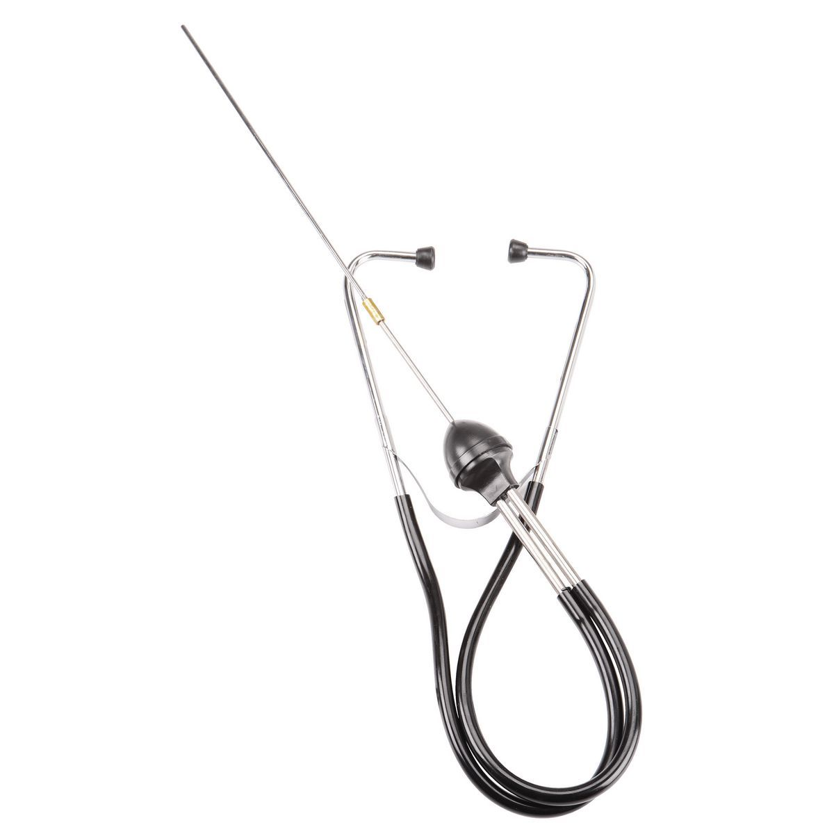

Use a long screwdriver and touch each rotating assembly while running i.e. A/C pump, P/S pump, alternator, etc and put your ear to the end of the screwdriver. It acts as a stethoscope of sorts.
This can help you narrow down the culprit here.
HF sells these too.
Mechanic's stethoscope
