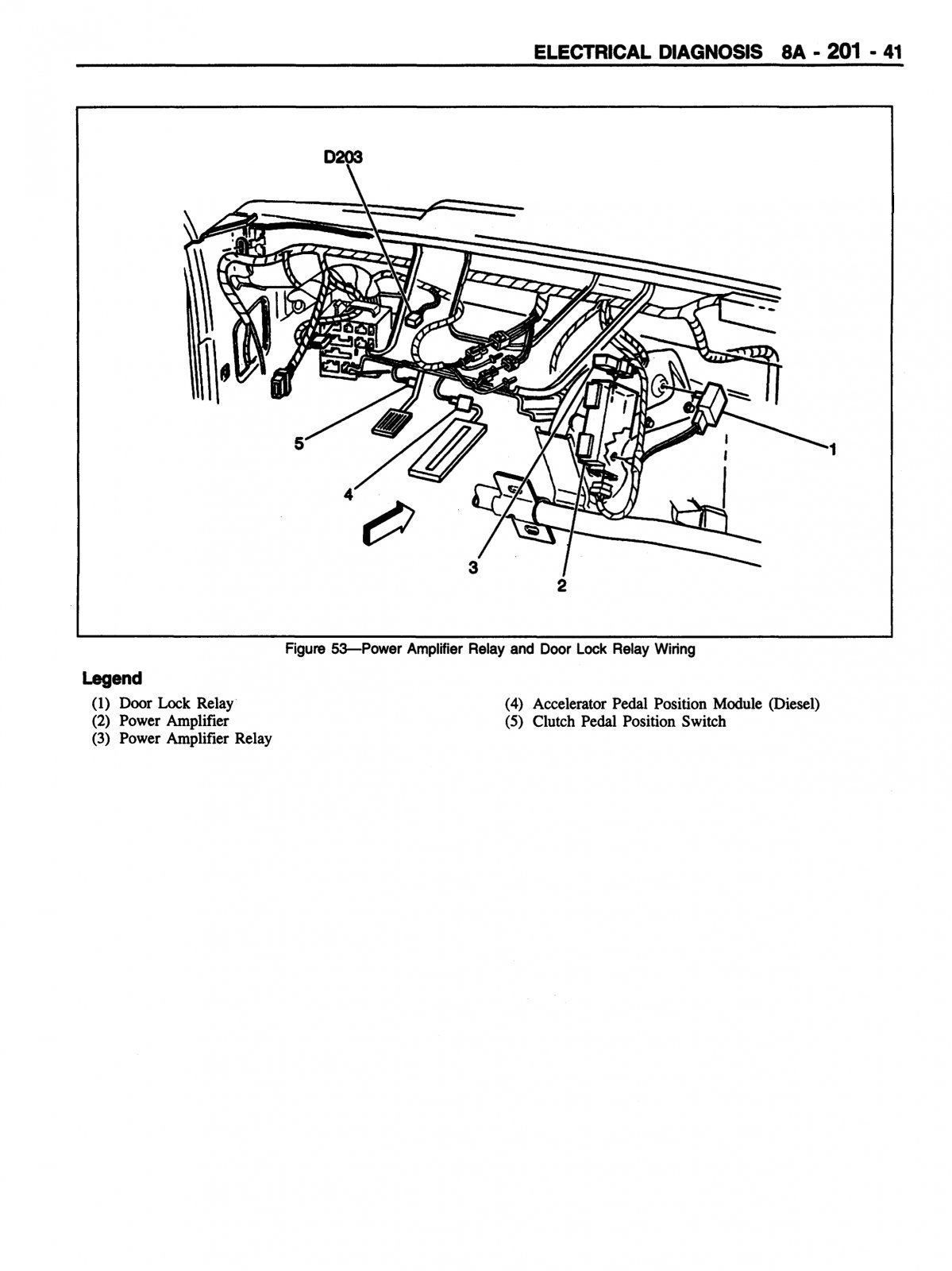

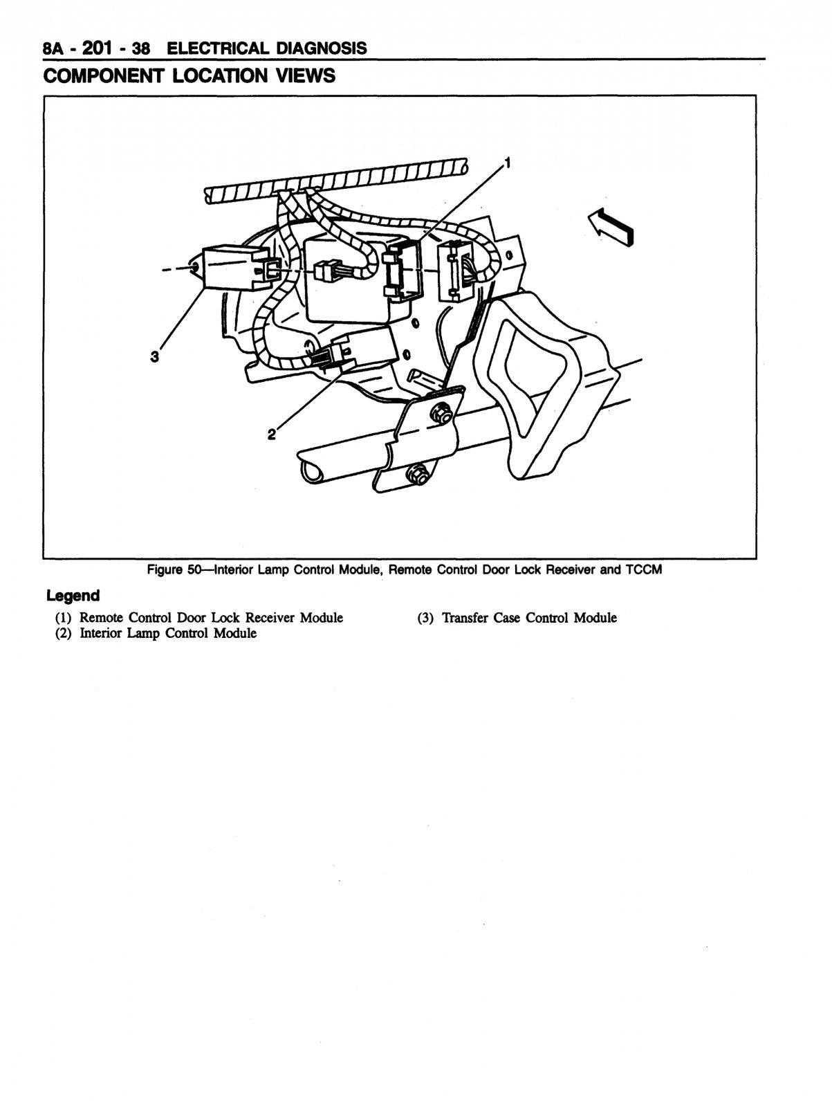

I’ve read where some had a bad door lock relay cause that as well. The relay and the remote control module are somewhere under the dash…

Thanks for the comments! There's been no major work done in a long time. I'm about ready to replace the dash with an intact one so I'll have all the wiring areas for it openly accessible. Tested the FOBs first thing - no effect. It actually does get much more noticeable in full sunlight. I'm stumped.
