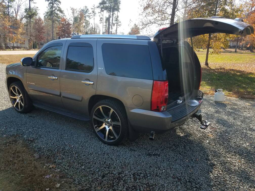

Bought some low pro visors. I thought these were the inchannel, but they are stick on. They go around the window frame and not on the body. They flow well with the body. They dont let a lot of air in but with the sun roof cracked, it helps with thr circumation. I like them over all.

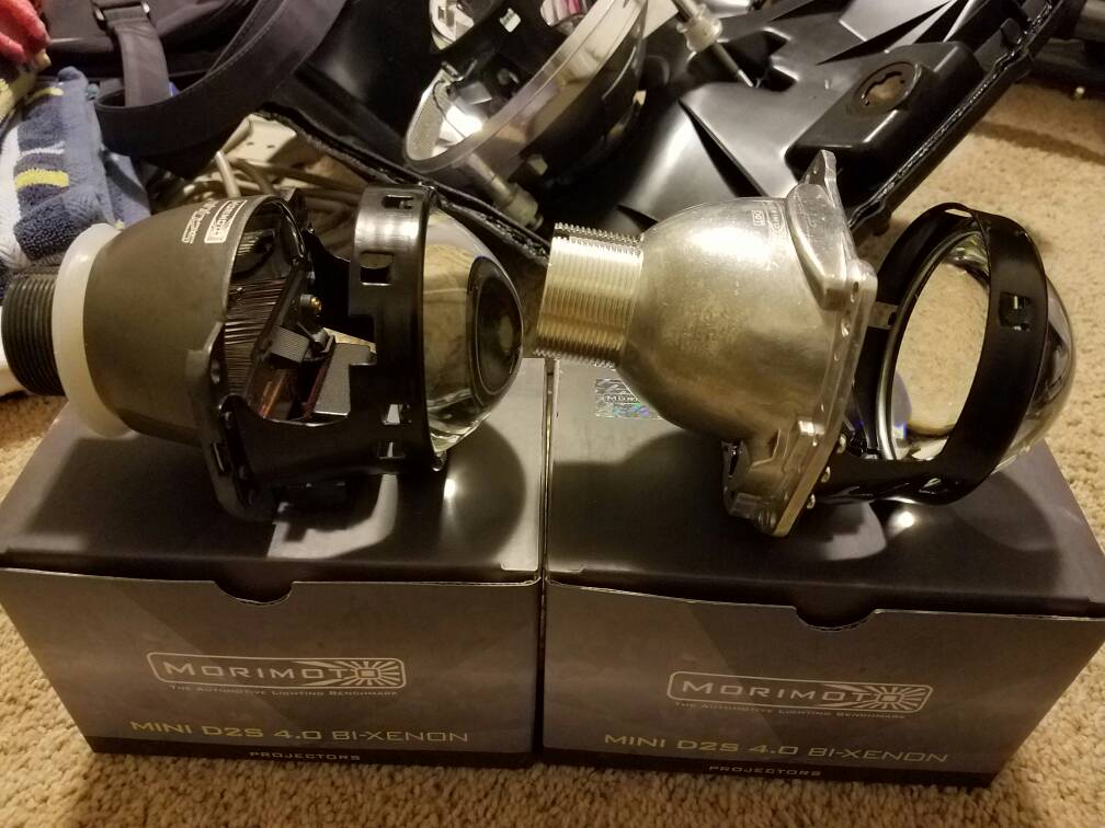

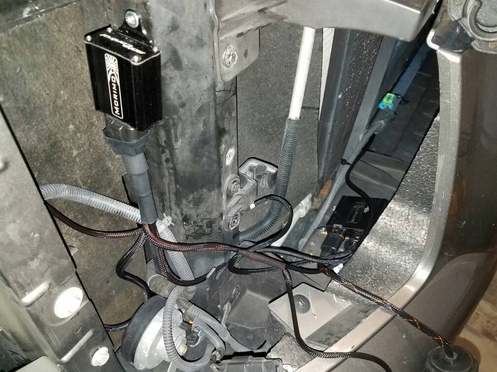

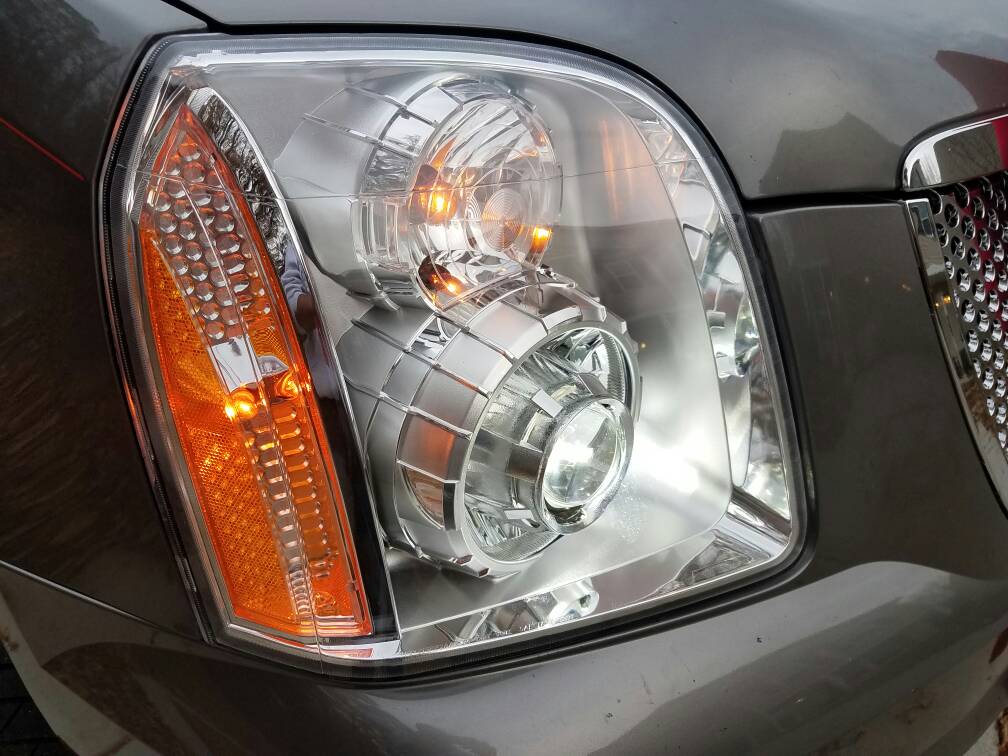

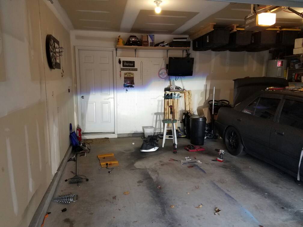

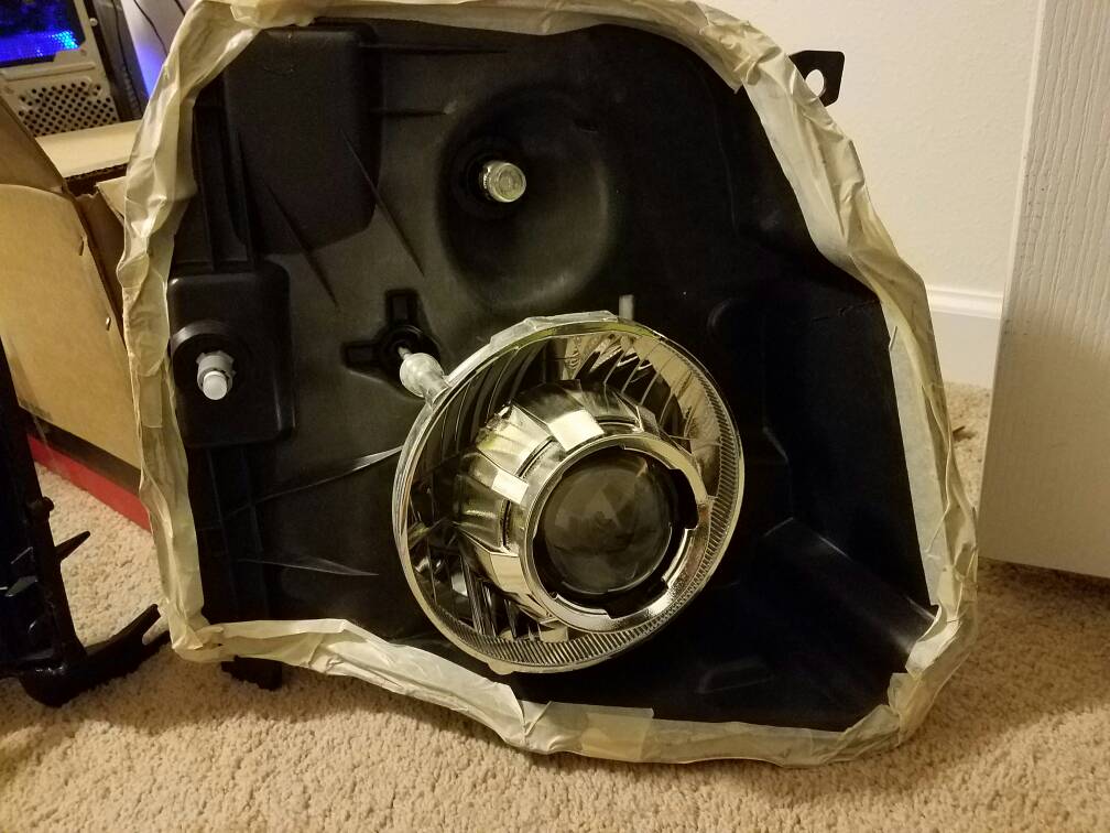

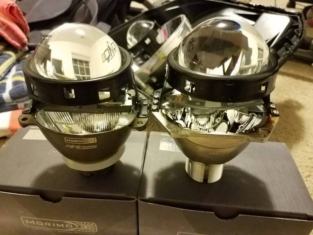

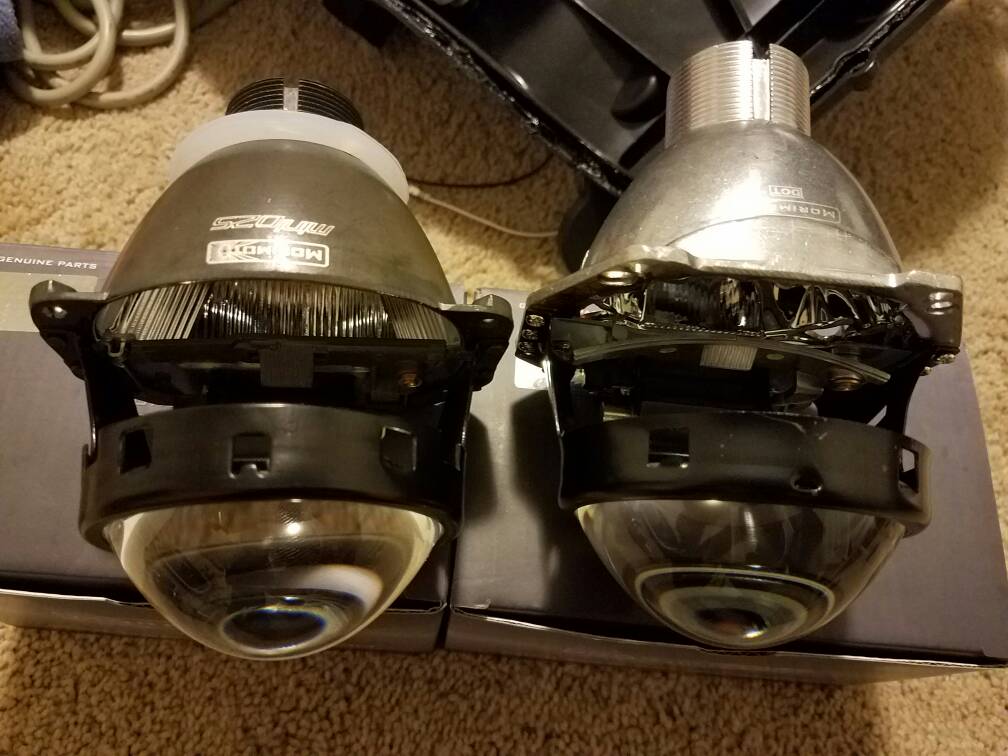

Ordered the D2S 4.0 as some motivation since my retrofit has made no progress. Got them switched out and go my 3157 and t10 led bulbs installed. I will be adding a resistor if it hyperflashes, which im sure it will.
The Mini D2S 3.0 will be up for sale shortly.
Sent from my SM-G935P using Tapatalk
93blkongreenpro
93blkongreenpro
Feb 9, 2016
1,388
1,358

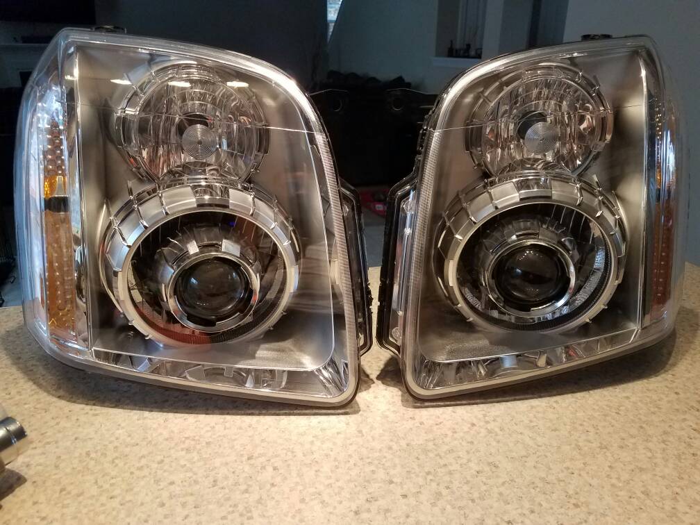

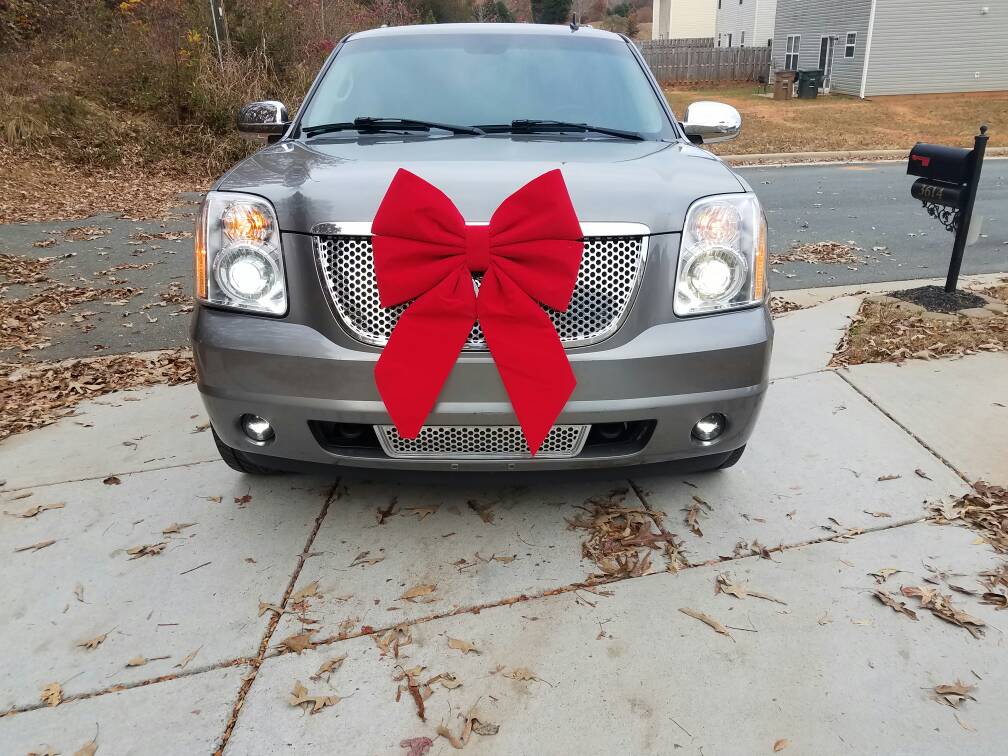

Hopefully monday I can button up the retrofit.

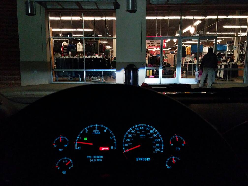

A quick pic from yesterday. Fried 3 turkeys and had the truck playing tunes to past the time.

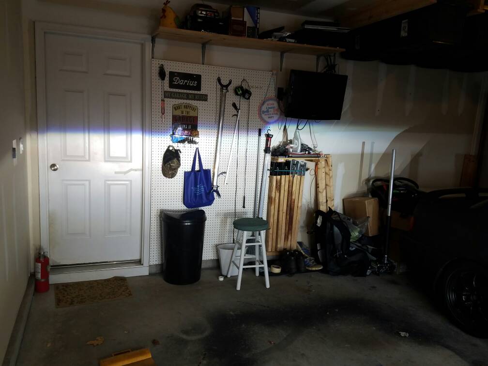

Thanks. And yep. They were aimed too high, but when i picked my son up from daycare, i lowered them, but too much. I need to find a flat parking lot around here soon.

I was, but it kept blowing the fuse. So I put the stock bulbS in after 3 sets of fuses. But yes, it was switchback and was very bright for the 5 seconds it was lit

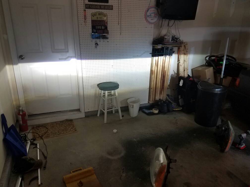

Readjusted the cutoff to the 2step. Lets see how this pans out tmrw night with traffic. Hopefully 2this will give me a little more road coverage without blinding traffic

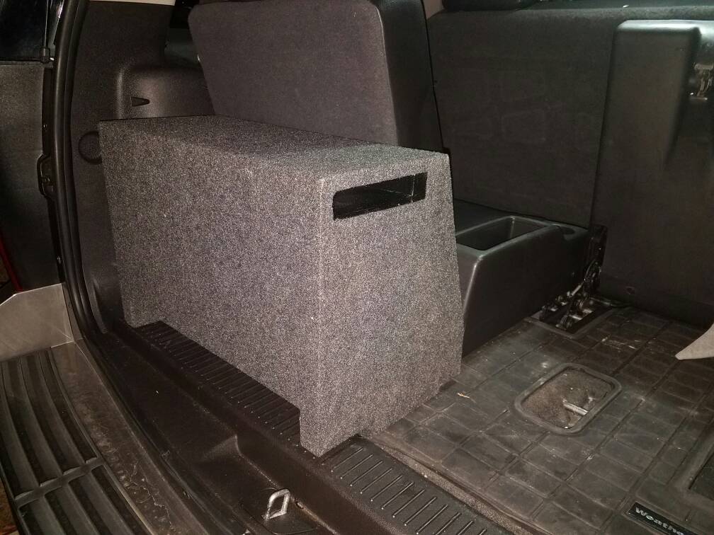

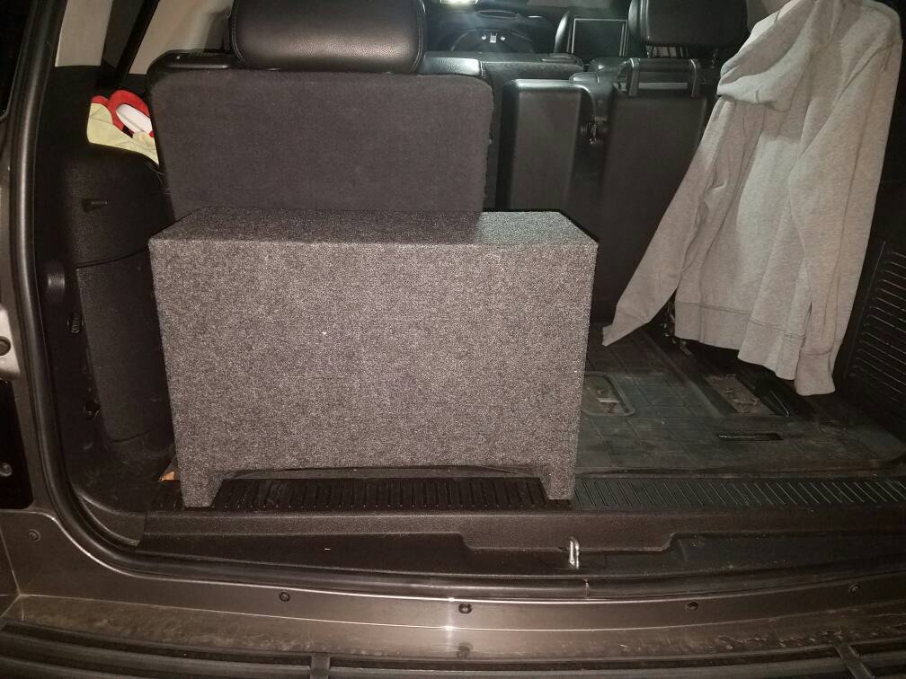

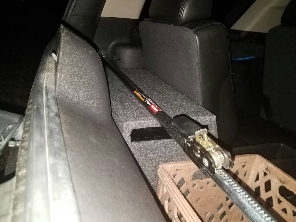

The kicker L78 in the .48cuft center console enclosure has been doing its job, but I finally bit the bullet and bought a another subwoofer setup that goes behind the 3rd row.
I will keep the center console sub and add a connector so I can switch back and forth with ease.
I ordered a DC Audio Level 2 12 m2 D4. I read good things about it and it was around the price I wanted to spend, and from what I read, is American made and handmade to order. All pluses.
The box is a 1.25 cu ft ported and down firing. The woofer specs says the optimum ported bix volume is 1.25 so it should sound good right away.
The sub is 600 rms at 2ohms and my PPI Phantom 900.5 is 440 rms at 2 ohms so it should match good and leave me some head room if I should find a better 5 channel later, or if I go with a 4 channel setup with a separate mono amp for the sub.
I should have everything the qst week in jan and I should havs the connector figured out by them. Something simple. 2 wire. Quick disconnect. I will try Lowes to see what they have. I will probably have it on the rear driver side in that little hidden pocket area to make the connections quick and easy.

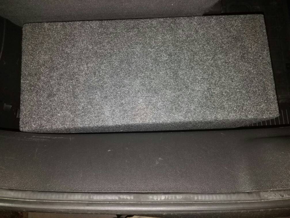

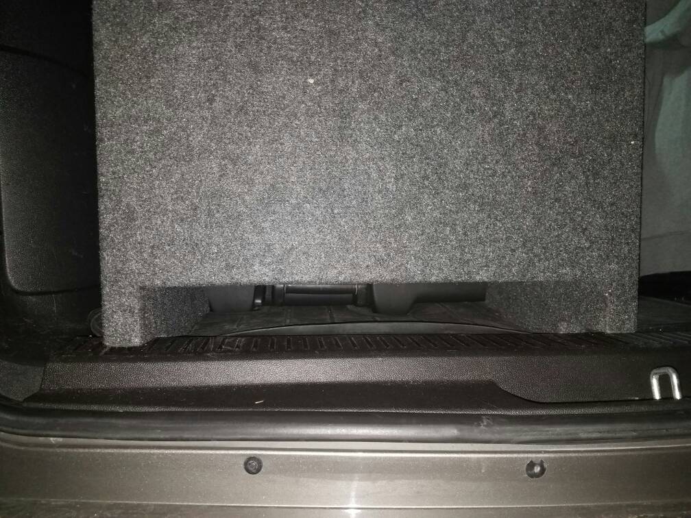

Box came in. Smaller than I thought, which is nice.
