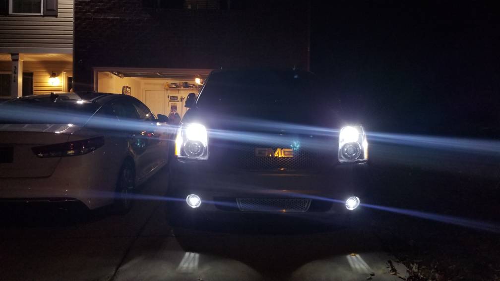

Why are they flickering?
When they come back on, the slowly come up to full brightness. So on the camera it looks like a flicker. But that was 1 reason I went with these bc of that function and it looks classy and updated.

Can’t tell if where you mounted the resistors is metal or plastic, if its plastic they will melt right through that, not tryin to be negative, that’s just the problem I was having In debating on to use resistors again or spend the money to have the BCM flashed. I had resistors and switchbacks on my NBS, and I just threw them down inside there and they melted right through a bunch of wires, they get extremely hot, so I took them out and got a flasher. Overall your lights look amazing tho man!!

It's metal, bc that's my grounding point for my hid ballast. And I did it for better heat dissipation.

Perfect! Just wasn’t sure without me lookin at it in person.
If you get a chance, get a night shot, love the white on white light with the switchbacks and the headlights, looks so clean.

I messed up my rotation somehow, so I need to take them back out and re-rotate my projectors. I'll check on the resistors and contact hopefully tmrw.

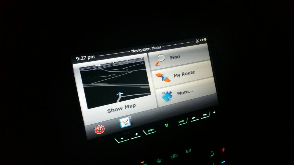

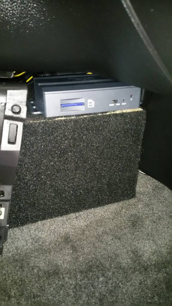

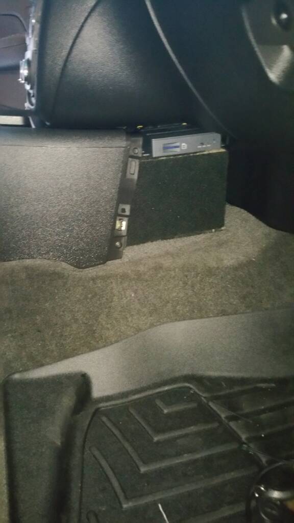

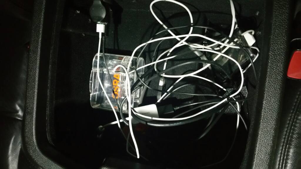

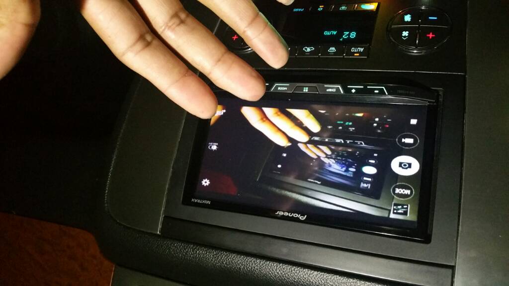

Few quick pics. It took about 1.5 hours. I had to rerun the gps antenna to the outside of the truck. It would not pickup behind the radio.
And my cluster of entertainment wires.

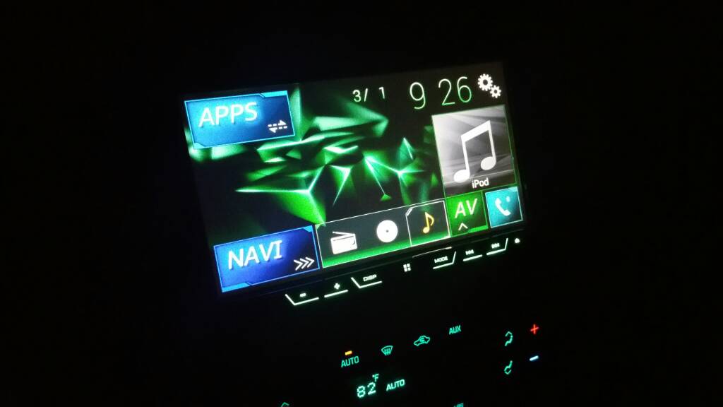

Its nice that I can screen mirror my phone. That will actually come in handy saturday as the UNC game is on at 6 and I will not be home.

when I put my gps antenna in I pulled up the front part of the dash (closest to windshield), there is small square spot underneath right by the daylight sensor and it fit perfectly right there, then just fed the wire back inside to the headunit., then I put a Sirius antenna as well almost directly in front of the driver under the same dash piece as there was just enough room in a slot there. I didn't want to have to run mine outside so I just figured it out.

I found out about the dash spot after the fact. I have since replaced the 4700 with the 4200NEX that had android auto/ apple car play, so no need for an gps antenna ☺

Fixed my front camera rotation finally.
I will get to the headlights tmrw.
The cutoffs are making an "X". It's bad.
But I swear to you, these Morimoito XB Switchbacks are brighter than our h11 headlights, lol.

Nice, bothers me enough that you left the amber reflectors in lol, but at least now with leds you don't have the reflection of the amber turn signal bulbs anymore.
Gives it a cleaner look for sure.

I tried to get that surround out of the lens and it was not budging. So after 5 mins of thinking I was going to break the lens, I said f-it. And the orange stays. I wanted to remove it, but not at the cost of buying another pair of head lights, lol. Maybe the oem's come apart easier.

They arnt cemented in, but the lip was wrapped around and I felt like if I prayed too much, the lens was going to snap.

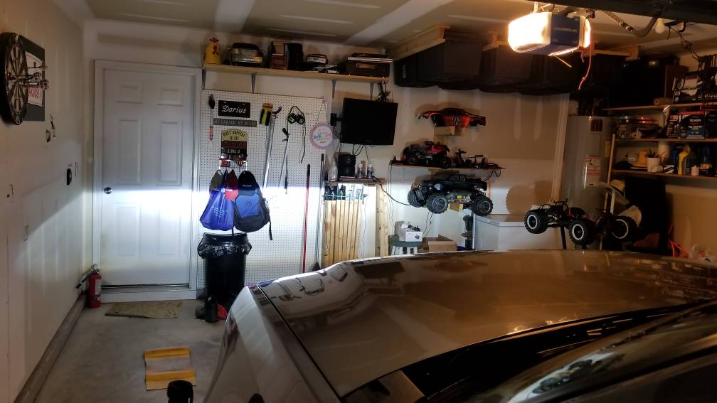

Headlight was out, but it ended up being a bad ground not allowing the ballast to ignite. Painted the cai cover bc it looked terrible. And I need to clean and oil the k&n. And added a nose for the Xmas spirit.
