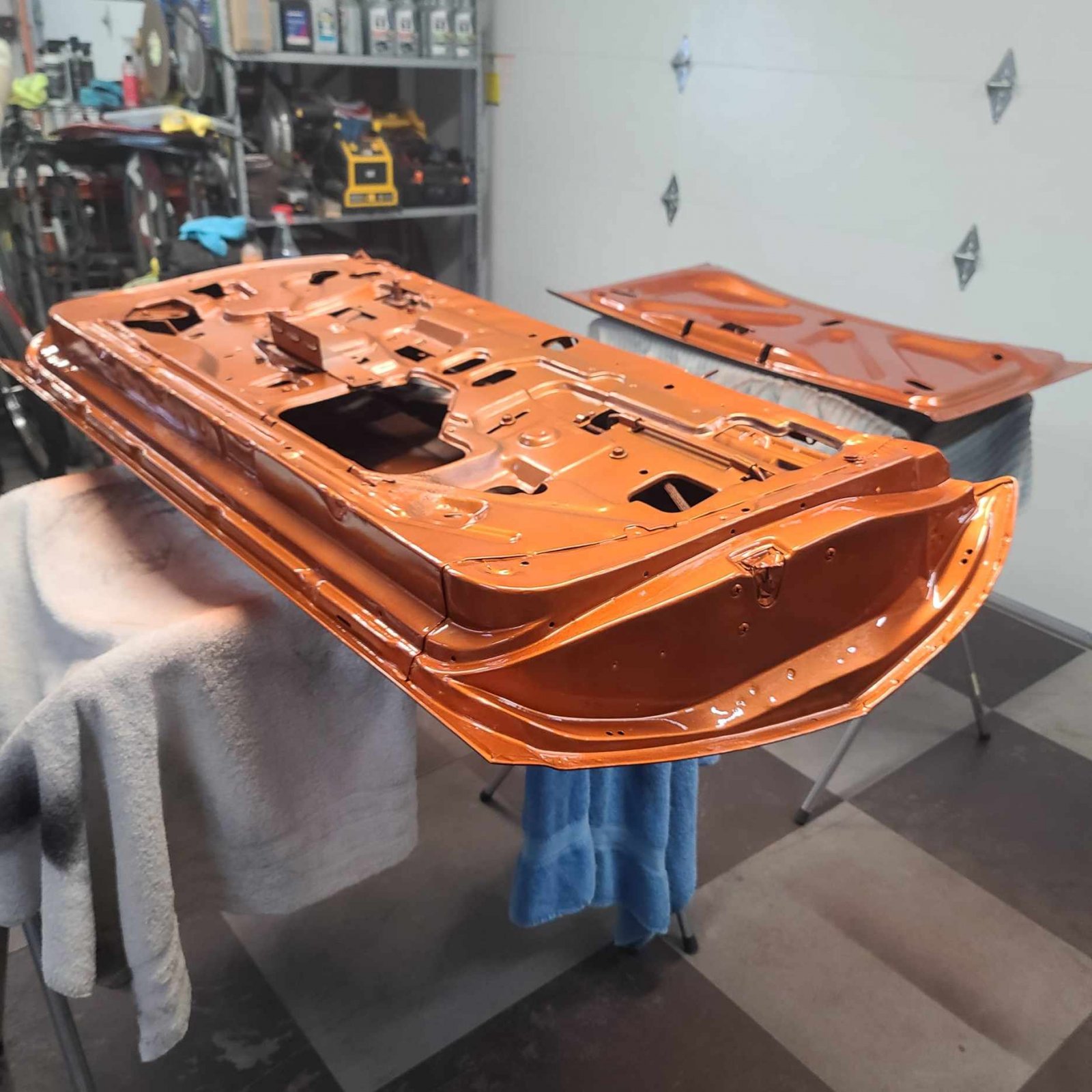

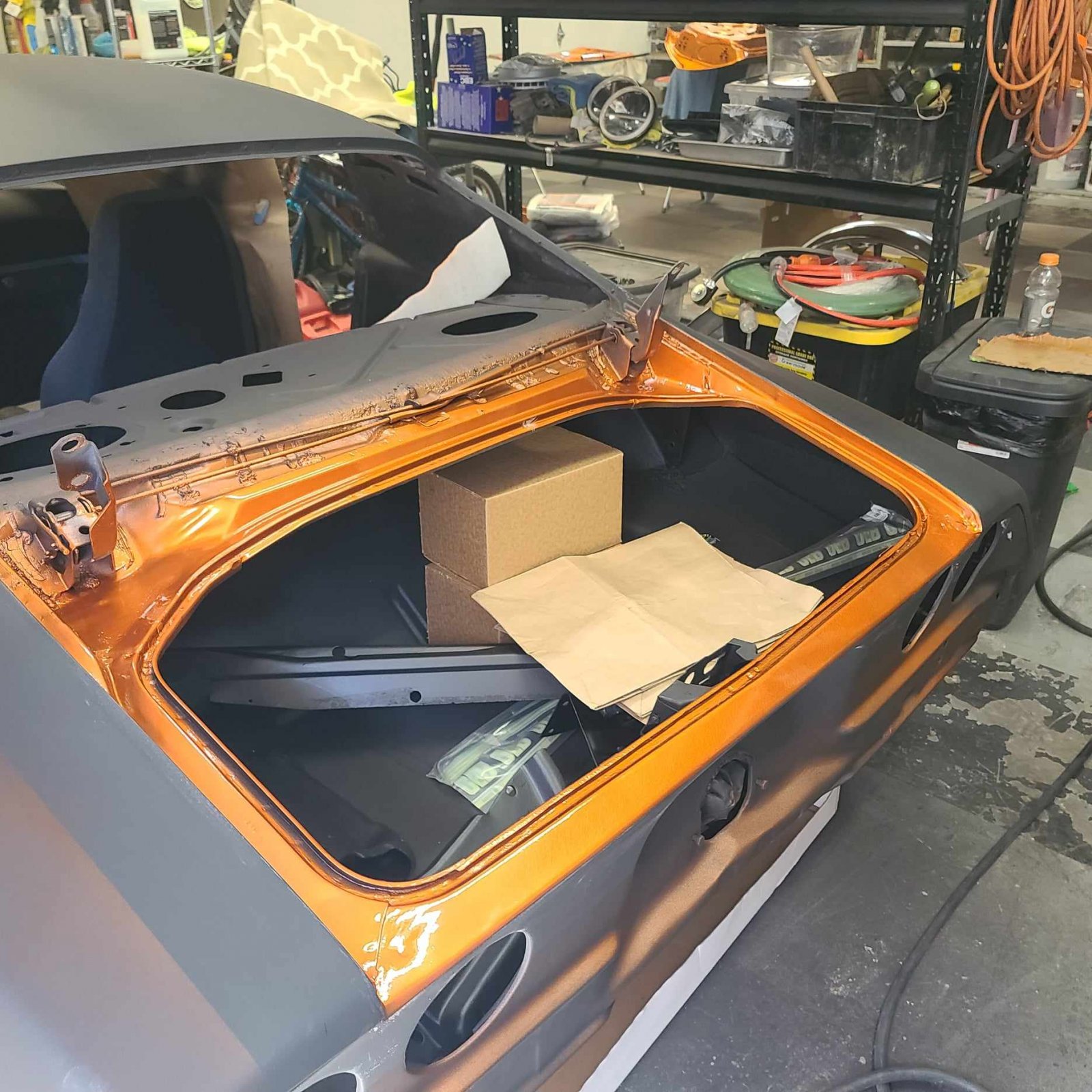

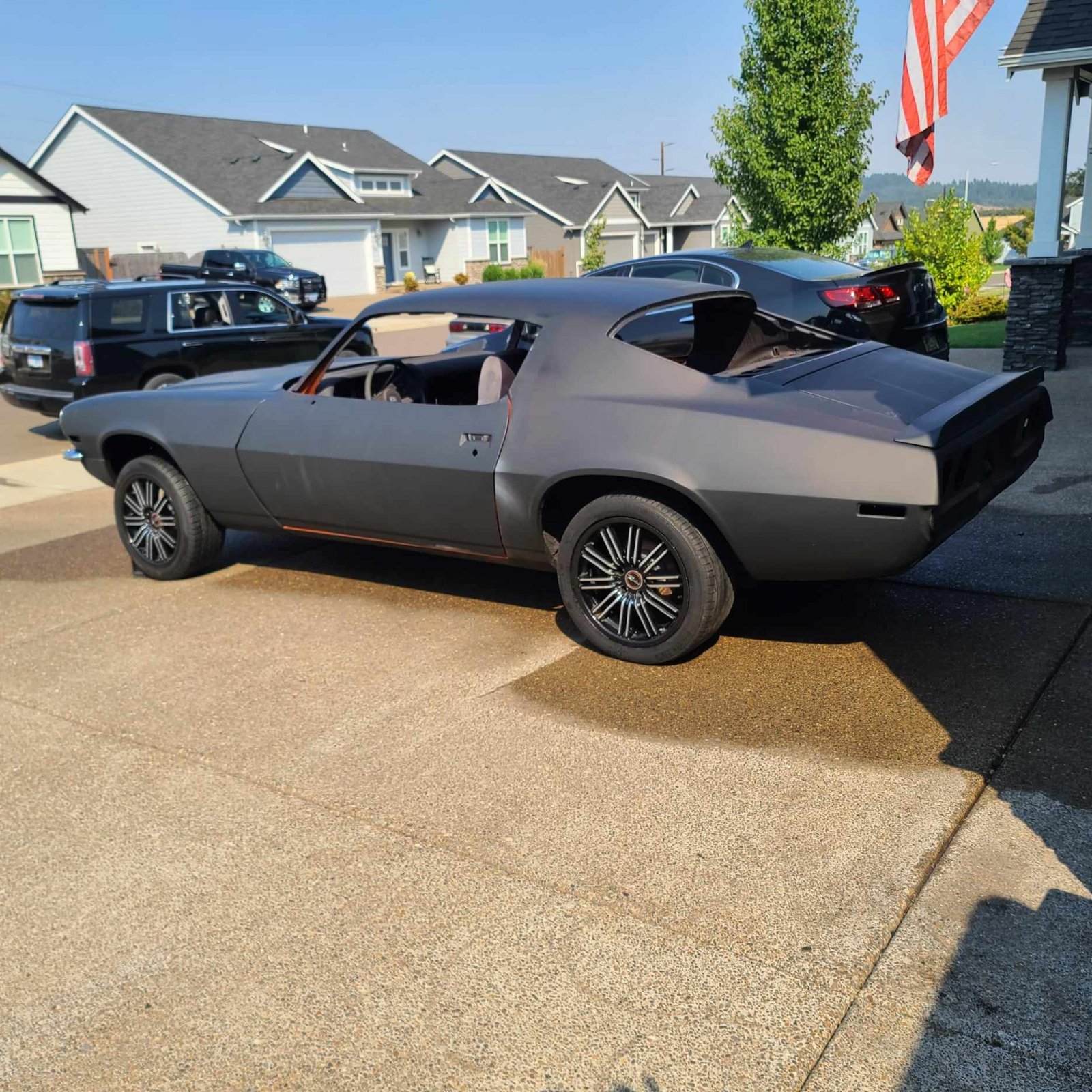

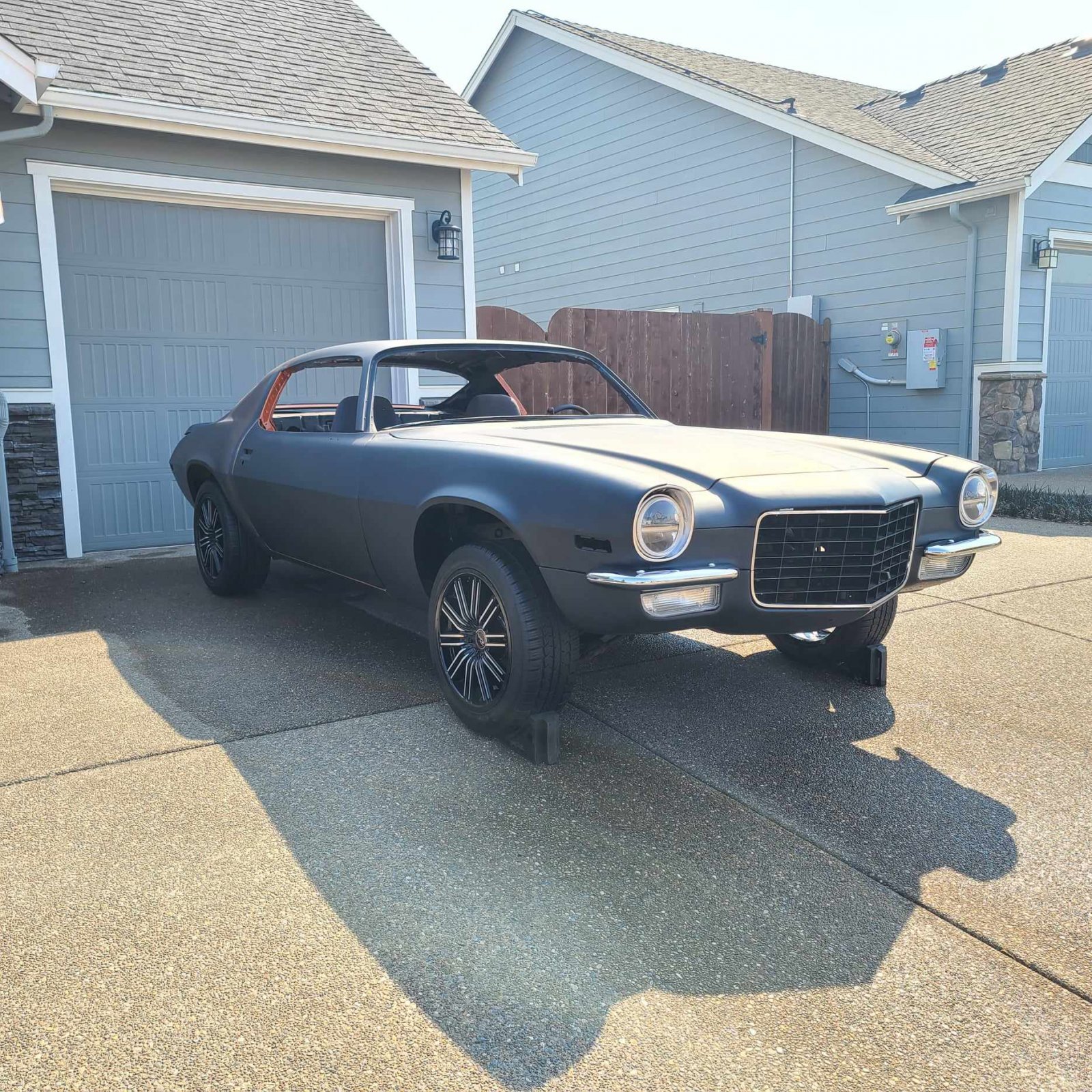

20+ years ago I was looking for my Son's 1st car. Found this clean 73 Camaro but it didn't have AC so a friend bought it. He took it apart to make a race car then quickly gave up so the Camaro sat in a field for 20 years before he gave the remains to me a few months ago.
I striped it down to bare metal & found no rust or any prior damage. Sprayed some epoxy primer then some 2K hi build primer. Yesterday painted the inner bits. Looking for a 2010-2012 Camaro SS with 6 speed manual as a donor. Upgraded to C5 Corvette 13" front disc & Blazer 12.7" rear disc, 1 3/8" front swaybar & 1" rear swaybar.

Still no donor car yet. Copart prices are insane. I may end up spending the money for a clean driver since I need so many parts off it.

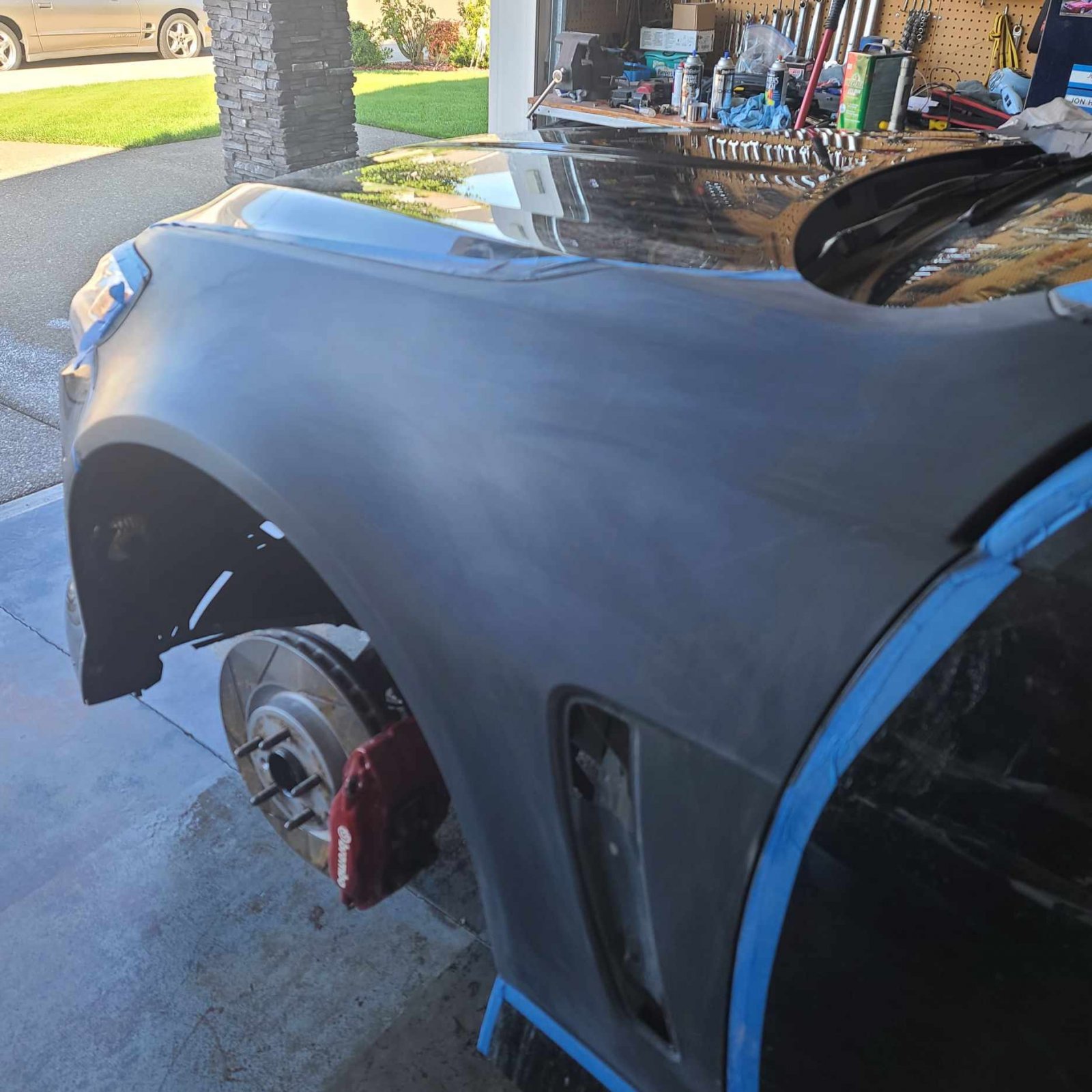

I'm close to paint & was working on panel gaps & paint prep then a large object hit my wife's fender while on the hwy then I had an AFM lifter failure on my Yukon so priorities changed.
I fixed my wife's fender & did an AFM delete on my Yukon just in time for the holiday season. Looks like the 73 Camaro will get painted next year.

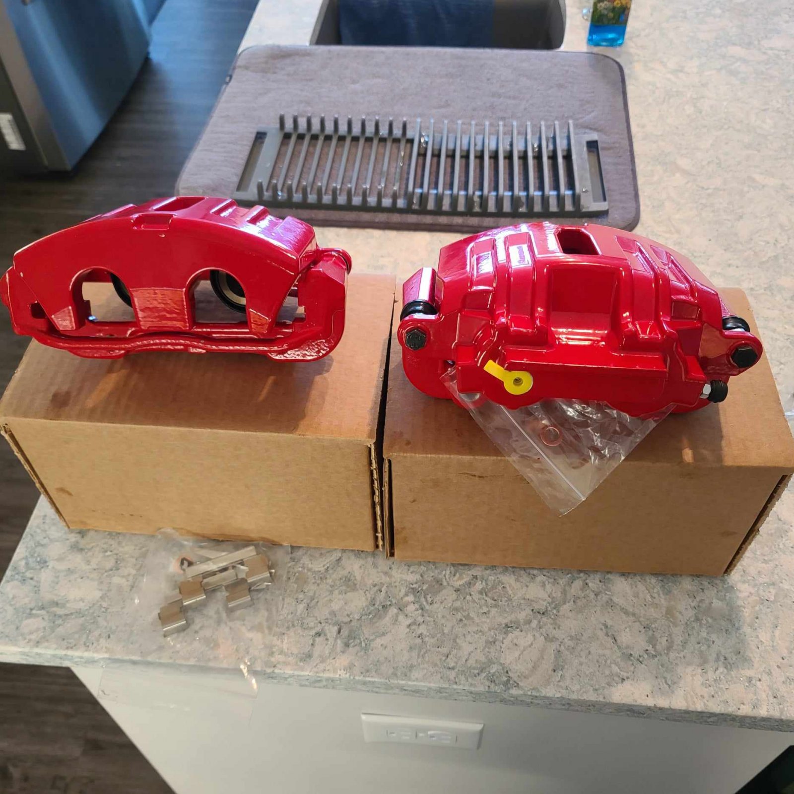

Here I was test fitting the front pieces. I picked up these $125 17x9 rollers to make room for the 13" Corvette front disc brakes & 11.7" Blazer rear disc brakes.
I got the Blazer rear disc backing plates for $12 each at a Pick n Pull 1/2 price sale. Also picked up 3.73 gears from a low mileage Escalade. Have Power Stop powder coated calipers.

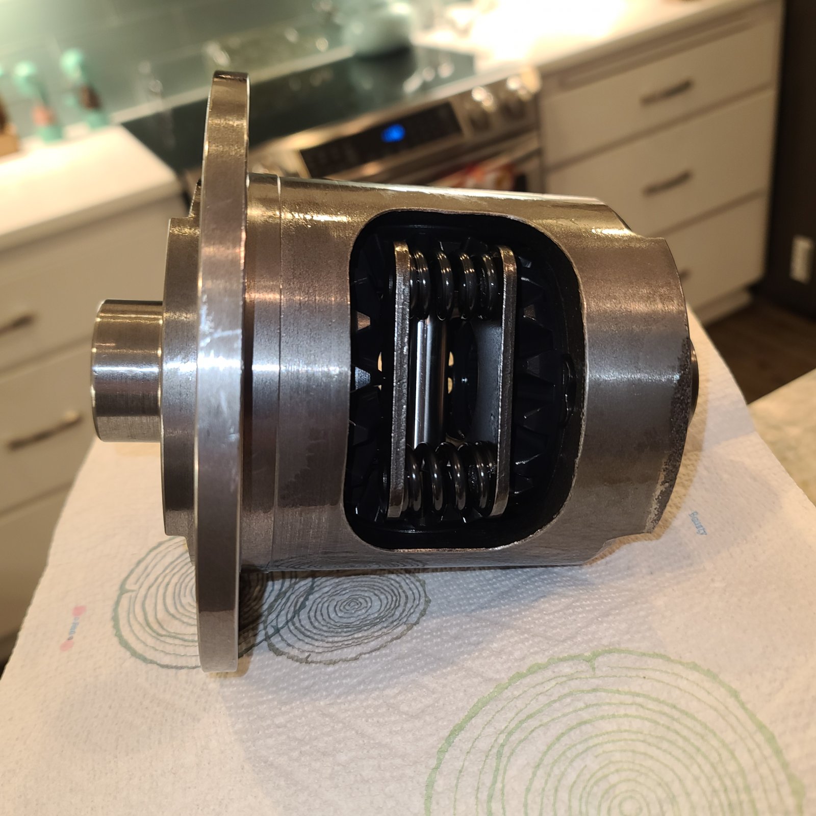

Does your Camaro have a 10 or 12 bolt rear end that your new posi unit is going into?
Axle upgrades, too?

It's a 10 bolt rear using a posi made for a 90s GM truck with a 30 spline 10 bolt then I'm upgrading the axles. Installing 12 bolt 30 spline axles made for a 1970 SS big block that came with a 12 bolt rear.
I did this same setup when we built my Son's 74 Camaro with a 600hp 454. Makes a very strong but not too heavy rear.
