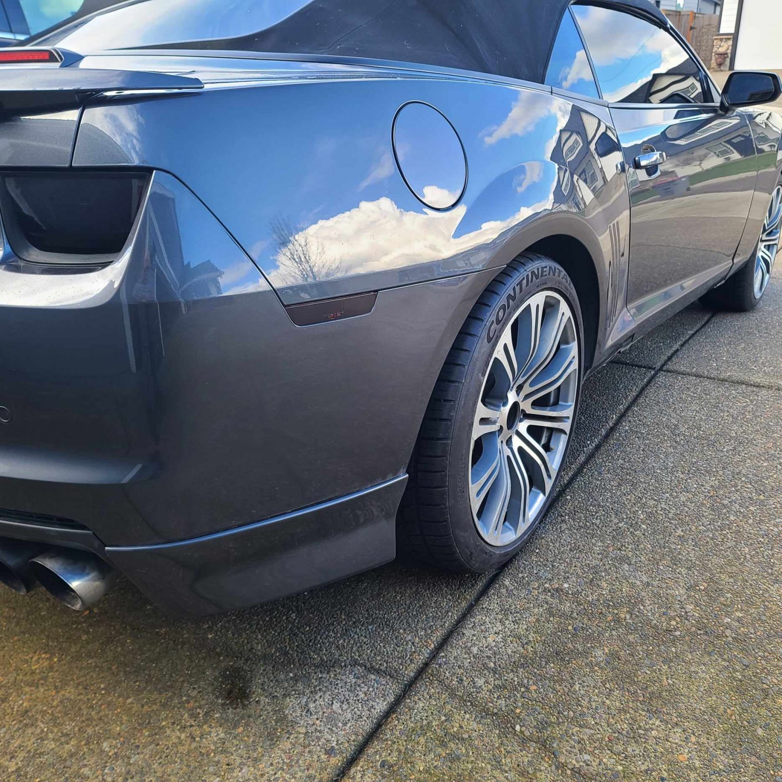

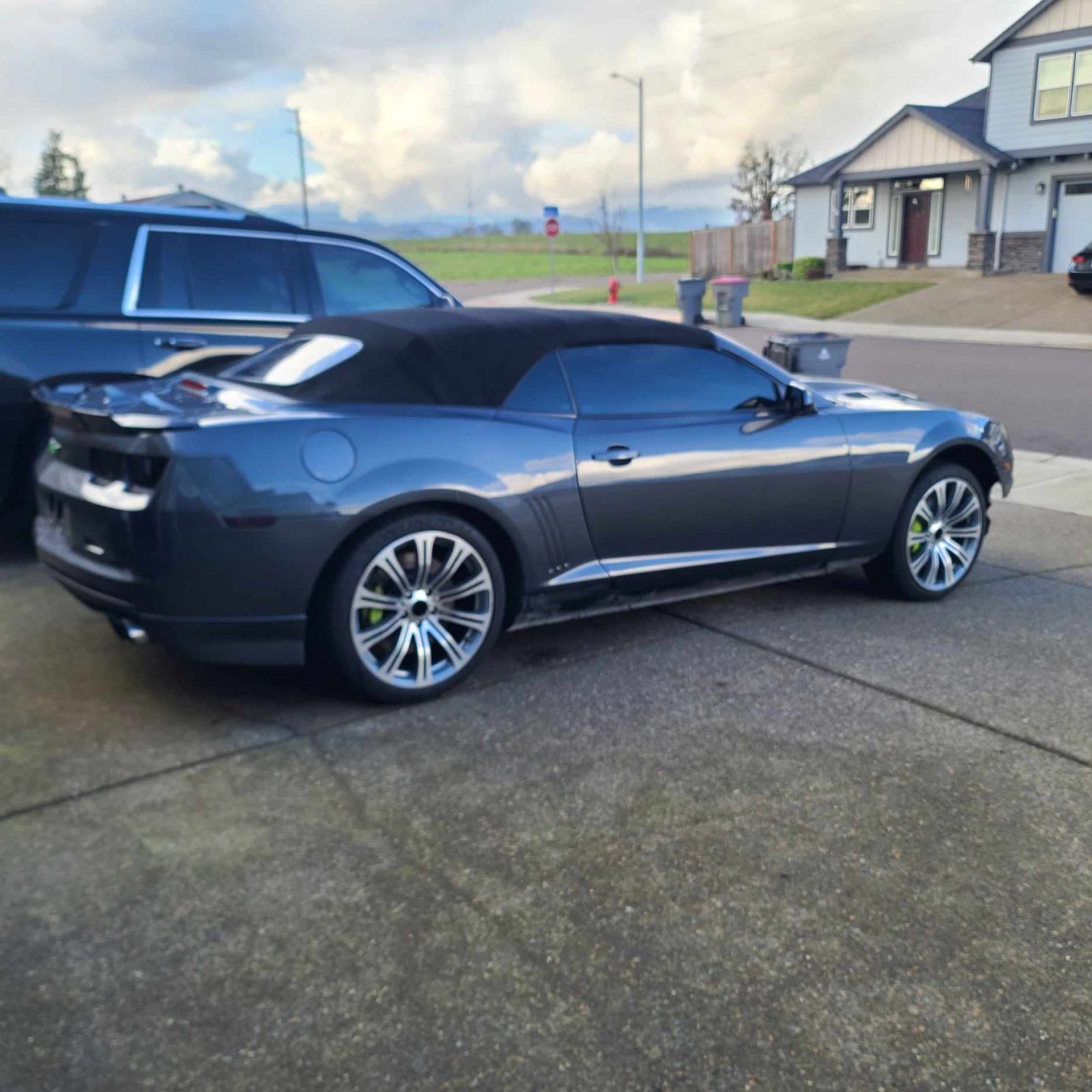

Paid $500 for some Continental DWS06 245F & 275R tires on BMW 20x8.5F & 20x10R forged rims. 85% tread. These weigh 11lbs less per wheel than what was on the car. I will paint them black & use SS center caps.

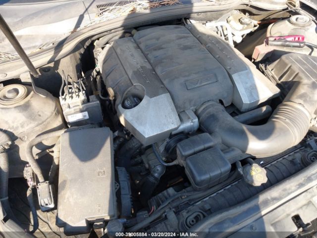

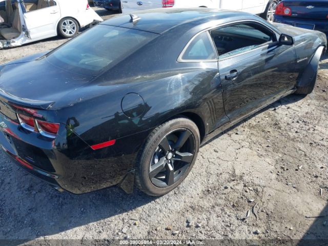

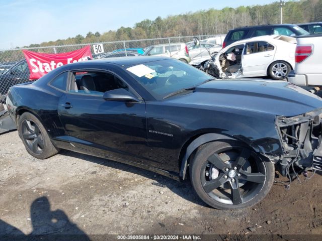

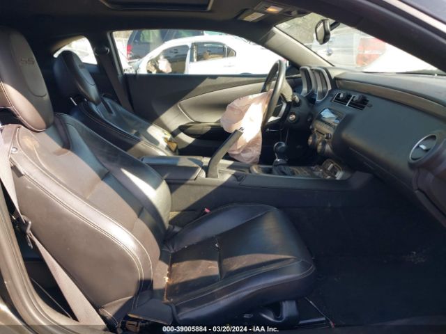

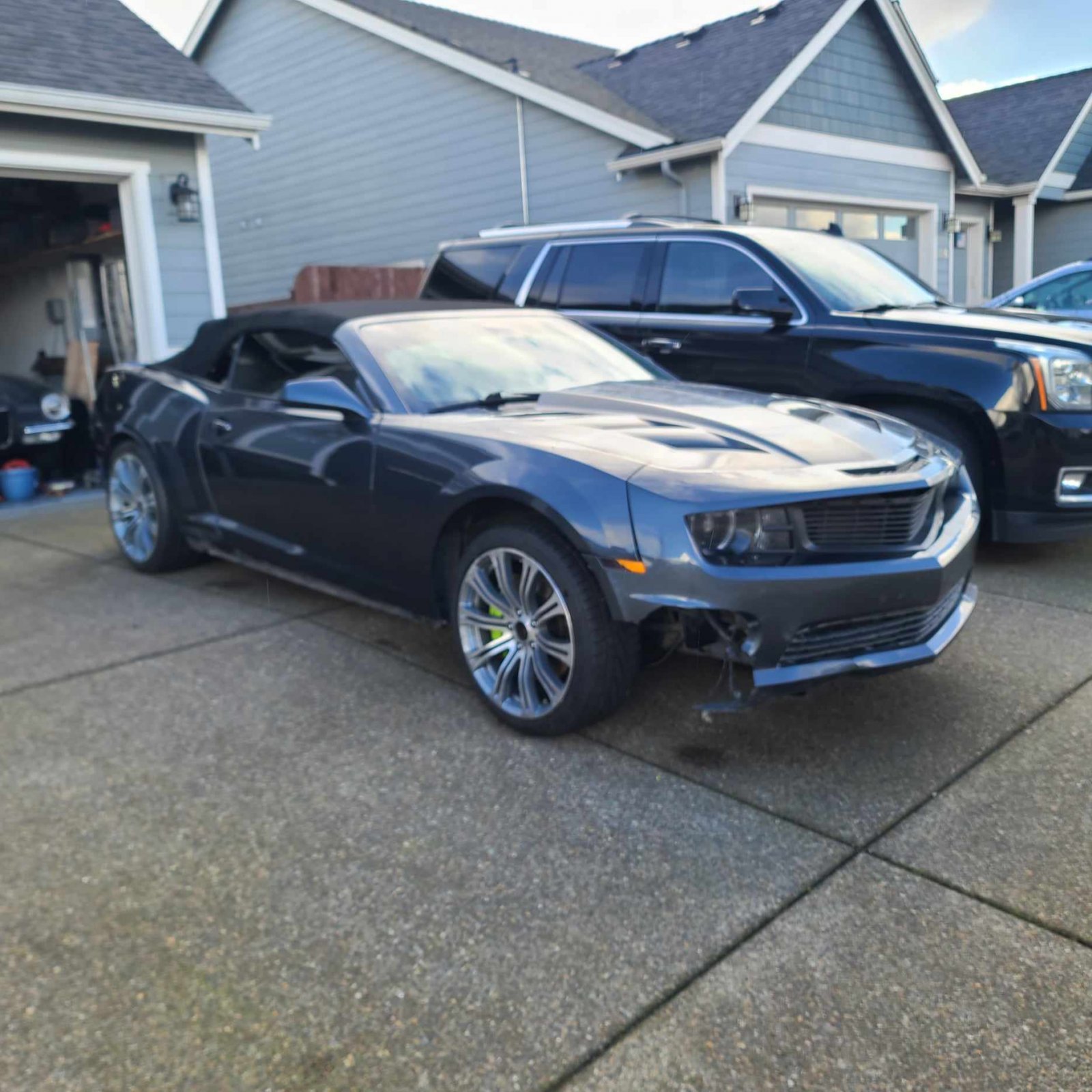

Since I'm keeping the 2011 Camaro 2SS convertible. I bought another donor, 2011 Camaro 2SS coupe with 6 speed manual transmission. Paid $5,600 including auction fees for this one. Manual car Rear-end center section sells on Ebay for $1,000. Brembo calipers $400-500 plus who knows what else I can sell once I'm done taking what I need.

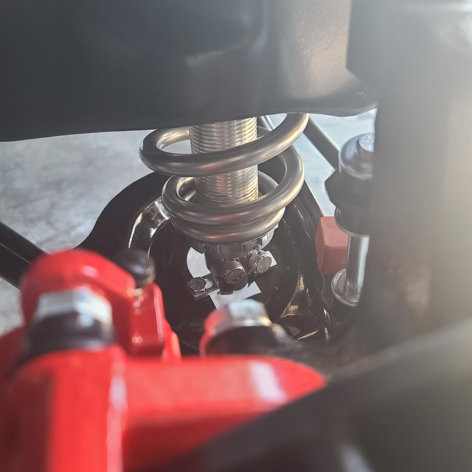

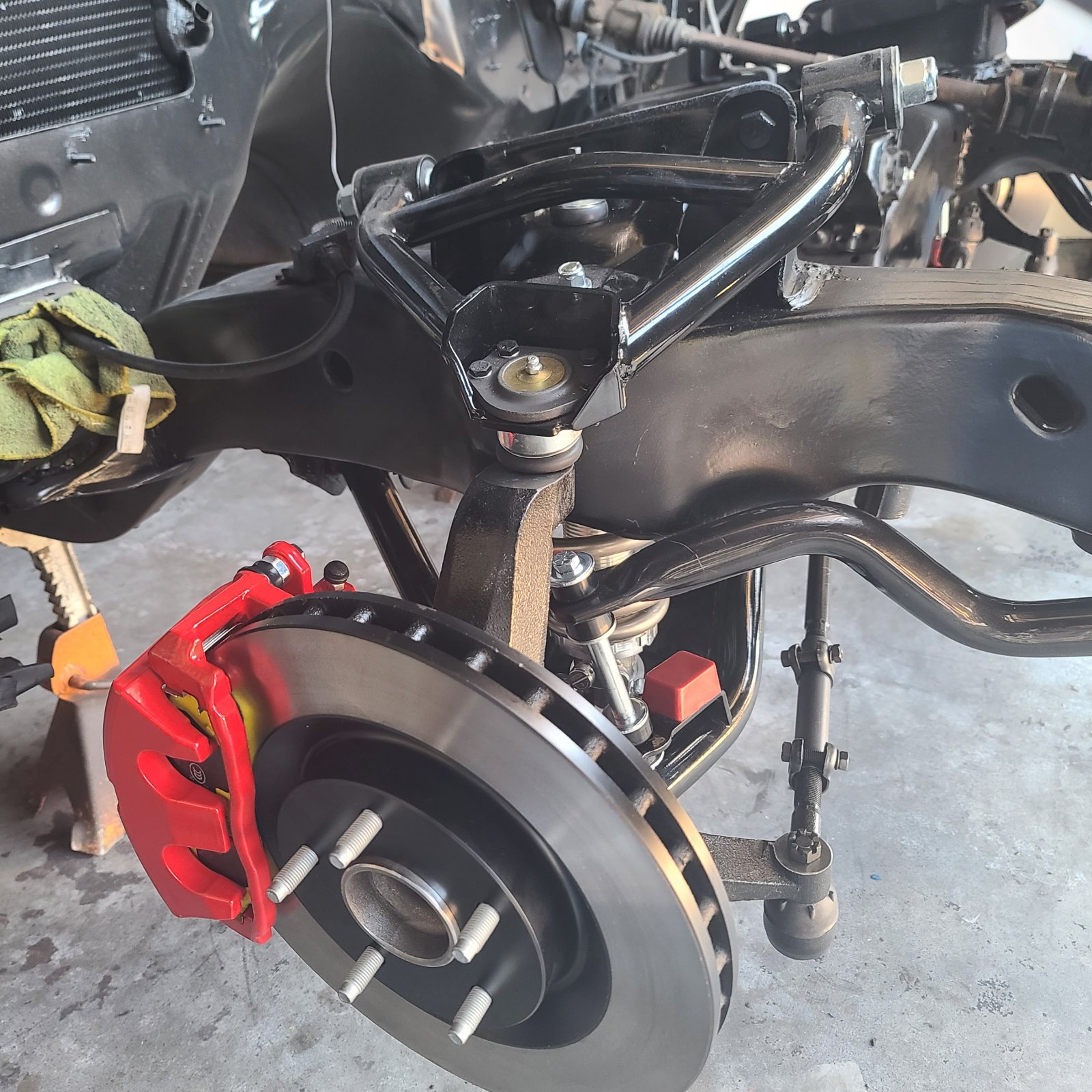

Replaced the front suspension & steering on the 73 Camaro. Tubular control arms, dual adjustable coil over shocks, Corvette spindles with C7 hubs, 13" high carbon rotors, EBC Yellow Stuff pads, powder coated C5 calipers, 1 3/8" swaybar, quick ratio steering box.

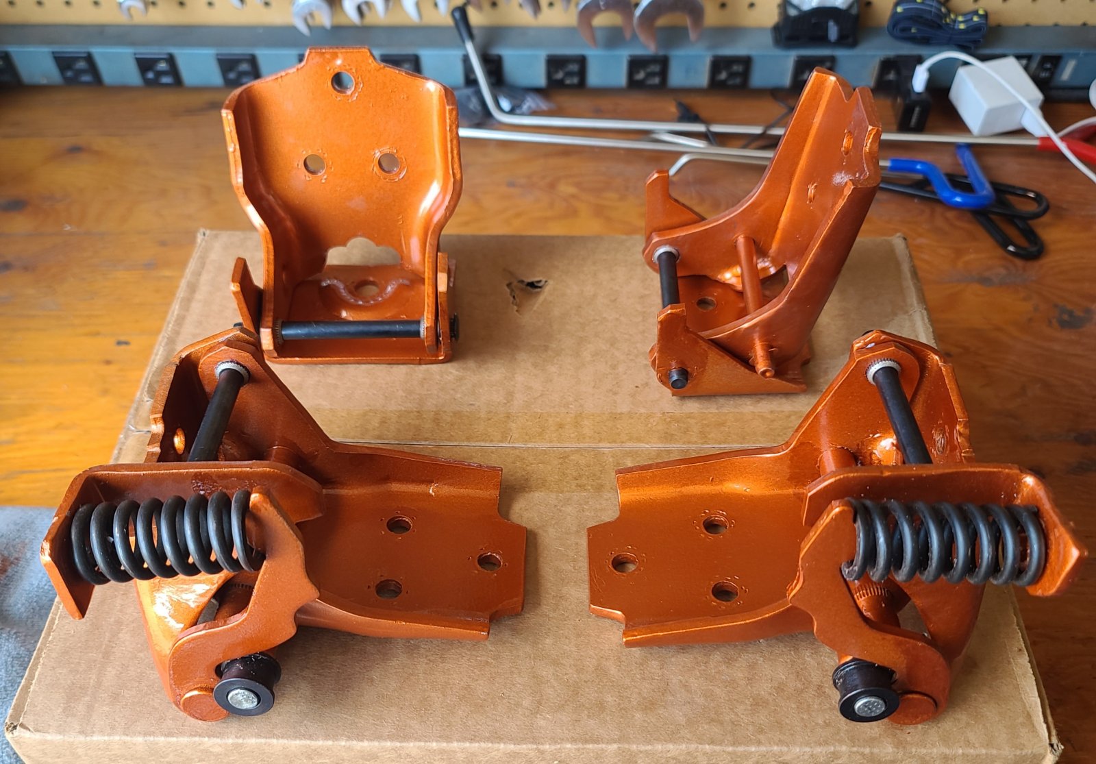

Those doors are heavy. I rebuilt the hinges & used Gen 3 Camaro rollers which are said to be better.

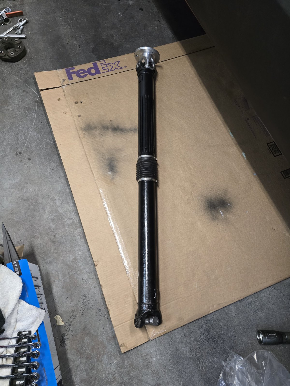

Since the TR6060 6 speed manual transmission doesn't have a slip yoke I used a 2004 Ford Explorer 4WD driveshaft, 1350 u-joints and flange adapter.
