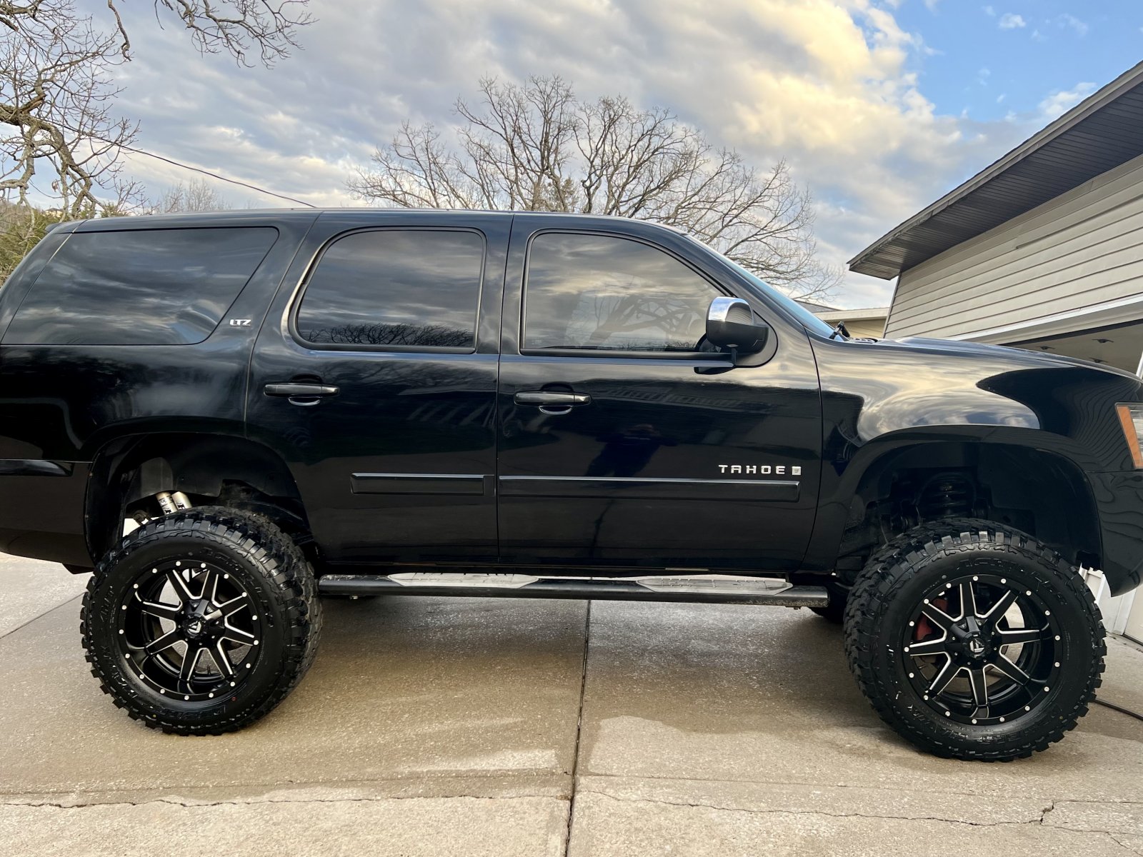

Your lift is not what’s driving the need for a re-gearing of your rear dif. It’s the size of tire you want to end up with. Check out this link.I’m also looking to get the 7.5” RC lift on my 07 Yukon (2WD). I’ve been told that I would need to get re-gearing done on the rear differential. Also looking to install 35’s after the lift.

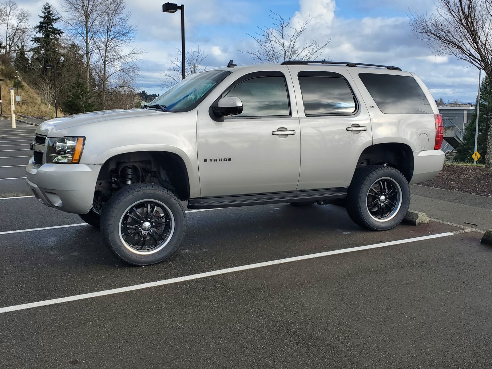

@Tonya the Tahoe I have seen a lot of people that use that same kit and have that problem. They usually put a spring spacer in the rear to raise the rear even with the front and they use wheel spacers on the rear wheels to make then poke out the same as the front. I think that kit uses aftermarket steering knuckle that makes the front tires poke out more.I just had 4wheelparts install my 7.5 RC lift. I also got RC uppers and their full length front struts and rear shocks too.
Ride is awesome! I almost don't wanna mess with it.
Problem is, it squats!! Also, the front wheels are spaced out more than the rear now. I didn't expect that because both 4WP and RC websites specifically state that it produces a level stance.
I think I'll have to get new wheel spacers for the front and new spring spacers for the rear. Sure feels nice sitting up high.
