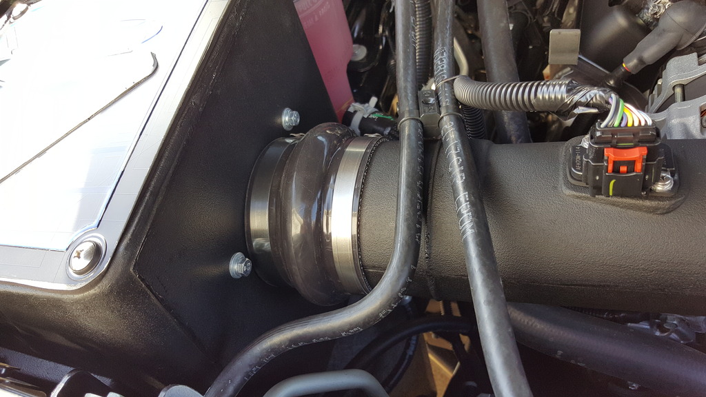

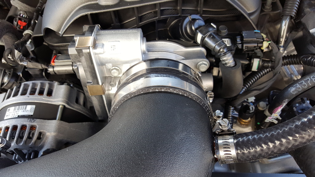

After i got my Volant CAI part # 155546 i found out they use 4" coupling on throttle body. Its little too big. I call them and they told me 4" will work just fine as long i install clamp at the of coupling. Is it just my Volant came this way or all of them came like this?
I found out coupling i need is 4" to 3.875. Airaid makes coupling for our TB part # 9116 but its only 2" long

I just tested Vibrant 4" to 3.5" coupler part # 2776 and its little bit tight fit on TB. Also for some reason Volan CAI is little bit quieter at part and wide open throttle. Maybe because this coupler is reducer from 4 to 3.5 ". I dont know. I still waiting on Airaid 4 to 3.875 coupler

Here is Airaid reducer part # 9116 4" to 3.875" and also Airaid 4" hump hose part # 140-400 to match
I did replace silicone t/8 that comes vith Volant kit with Vibrant 5/8 silicone hose part # 20445. Its reinforced hose and 2ont kink like Volant ones. you will have to cut it from 5ft to what ever you like

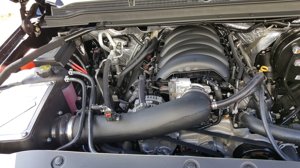

I like it. its litttle noisy on part anf wot but if you dont get heavy on throttle you will be fine. Mpg stay the same but better throttle response
