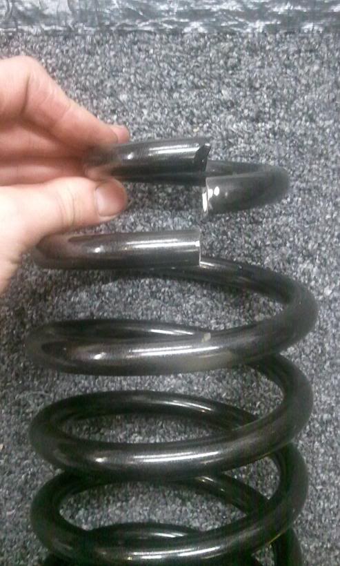

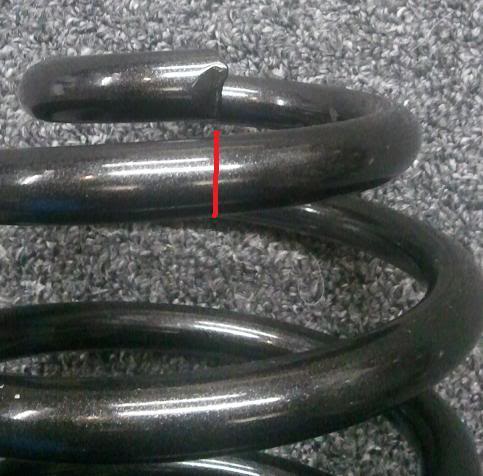

ive cut them as long as you have the correct rear shocks and shock extenders your fine.
remember when you lift up the truck measure from bottom to top of spring lets say its 11 inches. the belltech springs is about 12 inches long so if you cut it make sure you dont make the spring shorter then 11 inches
heres how i cut a few of them already

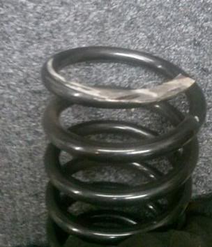

then you have to make the top part flat so doesnt ride around

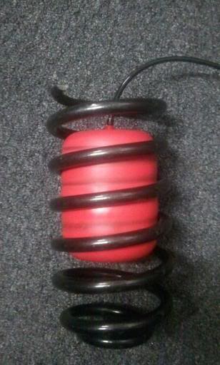

here it is with the helpe rbag inside
