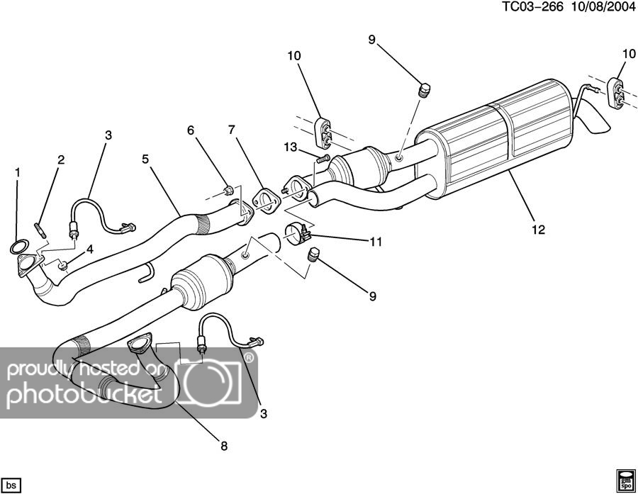

This is what I am working with. Its a California 4 cat set-up. I will be taking it in for an estimate on two hi flow cats and maybe the muffler.

rockauto might have what your after. the image you linked shows the right side cat all the way back by the muffler. the right side rockauto lists is farther forward. the walker brand right side specifically states carb compliance when i pull it up.

This is similar to what I have except it has 4 cats (California Truck). My truck is a 2500 Yukon XL, and I havent found that the exhaust parts interchange, but I could be wrong.

ok yes 2500 makes a big difference. magnaflow has a listing for California legal catalytic converters for your truck. on my phone so the images dont come up right but it shows a left and right side. then it also lists a universal one probably for that last one infront of the muffler.
