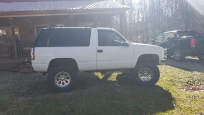

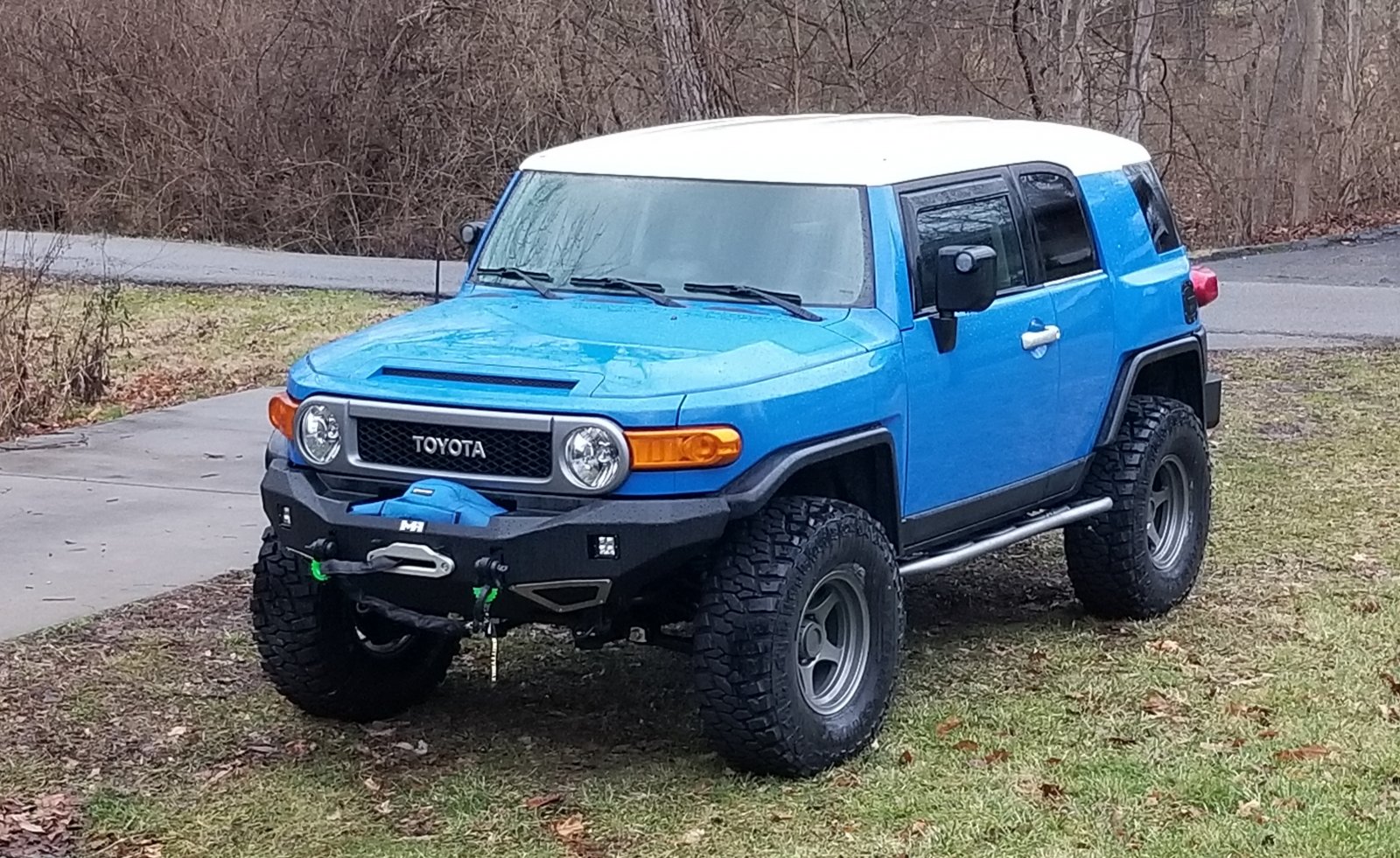

One more thing to consider is (as I recently became aware of) the actual stud bore. I'd bought wheels and tires for my FJ Cruiser and decided after a week or so that, as mean and nasty as they looked on 'er, the 35s were just wreaking havoc on driveability and would probably do the same to related body panels when beatin her eyes out offroad. No big deal, I thought. They'll fit right on the Yukon that's currently on 37s that I'm not a fan of. Turns out the GM M14X1.5 stud is just a wee bit too fat to fit through the wheel's holes that were intended for a 'yota M12X1.5 stud. Still workin on a solution...
