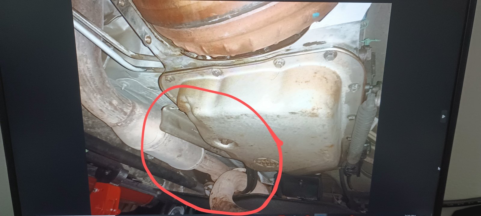

Check the exhaust mount/bracket that mounts to the transmission case on the passenger side. Actually, check the entire exhaust system. I once had an exhaust on my 99 Silverado that sounded like a rod knock.

Here's the mount I was talking about. The nut on there is kinda hard to remove. I believe I used a 15 mm ratcheting wrench.
And the exhaust/cats removed out of the truck. This is from my 06 Suburban 2500, but I think it's the same for the 2500HD trucks. I removed mine to fix a rear main seal leak last winter.

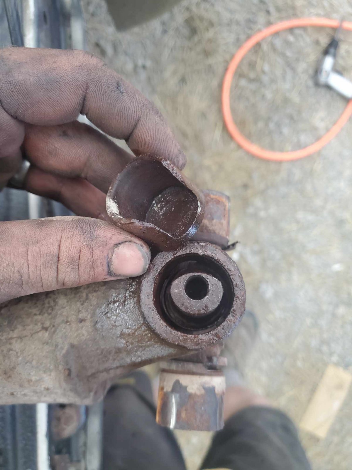

Minor update - couldnt help myself, crawled under the truck after I got home this evening to poke around. One hell of a bad universal joint - no needles left in two caps. I've had a bunch of bad u-joints - a few this bad - but none this bad this drove smooth down the interstate at 80.
I'll grab a new one and pop it in in the next day or two and hopefully that resolves the noise.

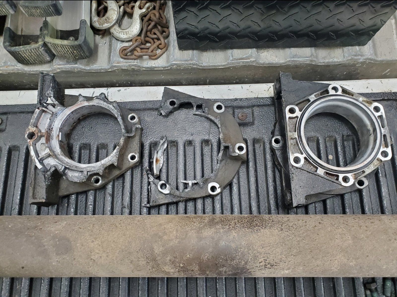

And here's the resolution! So there was in fact a very bad universal joint - half the cap on one side was missing. While pulling the driveshaft I realized - wow, transfer case sure does move a lot for something that isn't supposed to move at all. Turns out the extension housing on the back of the tranny had turned into two pieces. The t-case was being held on by one loose nut and the stamped steel bracket that holds the fuel lines. I pulled the t-case and swapped the extension housing with one off of my spare 4l80e and got it all back together with new universal in the driveshaft. Saw a few other things under the truck could use being addressed, but nothing immediately concerning. Tranny leak appears to be solved and all drivability issues are gone, including the drive engagement delay which I would guess was something binding up because of the t-case flopping around whilly nilly. Luckily the transmission output and t-case input, as well as all mating surfaces, appear undamaged.
I also rotated tires, put in a fresh air filter, and changed the oil, which if the sticker in the window is anything to go by was 17k miles over due. Gained 15psi of oil pressure at hot idle and driving around. Thinking it needs a ball joint on the driver side and a front end alignment and she should be in pretty good shape.
