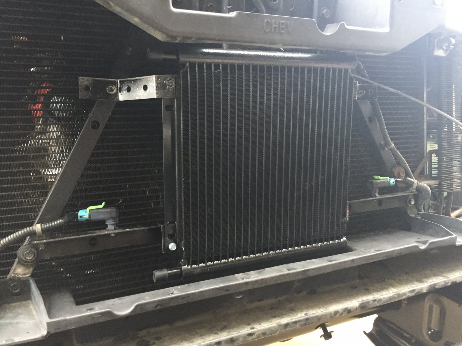

I have an 07 Tahoe 5.3L AFM/DOD deleted with stage 2 TS cam. Circle D 2600 300mm converter. I installed an aftermarket cooler and when towing my camper I'm still getting temps close to 210. If I were to bypass the factory cooler in the radiator would it help keep the temps down.

Maybe, tell us how the external is plumbed with the one in the radiator.

factory hose still goes into the top of the radiator, the bottom hose has been cut and its ran into the aftermarket cooler and out back to the trans

aftermarket cooler

I was just thinking if you have 210 degree water flowing through the radiator then how much could it really cool the trans fluid.
That's what I thought. Fluid goes from the transmission into the bottom of the radiator and out the top then into the external cooler and back to the transmission.
Your setup is going from the transmission to the external cooler and then through the radiator and back to the transmission defeating the purpose of the external cooler.
Normal operating temperature is 180-200 degrees. The warnings and CELs don't happen until temperatures exceed 260 degrees.
I had originally thought about that but wasn't for sure so i just went with it. I'll switch it around and see of that helps. Thanks
No. Your engine coolant should be running somewhere around 195 degrees. The heat exchanger (auxiliary cooler) in the the radiator tank is acting as a pre-cooler for your external cooler.
You didn't tell us if you temp reading is downstream or upstream from your external cooler.
That would explain it.
