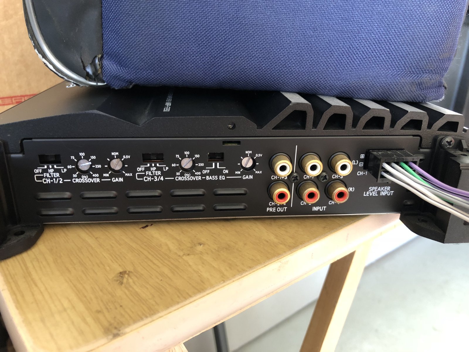

Got a amp for free and I already have rockford door speakers. My question is, can i just cut the factory door speaker wires from the head unit without issues and run them to this amp so i dont have to run all new wires through the doors?
What about the rca cable or is that what these colored speaker level input is for? I havent done a 4 ch amp since 06 so i kinda forgotten some stuff haha
Thanks

Depends on your HU as to what you can do.
If your HU is aftermarket you can run RCAs from it to the amp and then cut and run the existing speaker wires to the amp.
If the HU is stock then you could cut the wires coming from the stereo to the stock amp and hook them to the speaker level inputs and cut the wires going to the speakers and hook them to the new amp.
Or you could run all new wiring to the doors but that is more work.

Knew i forgot something. Yea its a stock hu.
Thanks for the info, i was second guessing myself...
