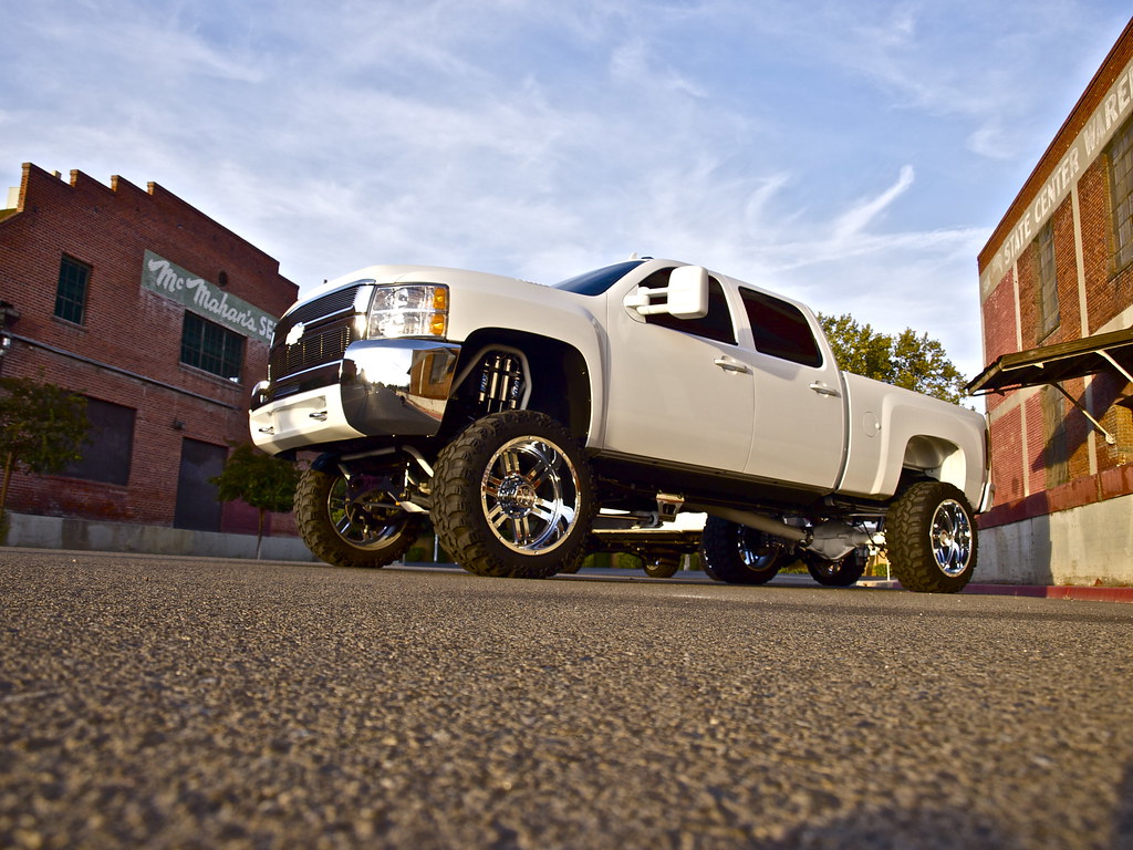

Hey Bowtiefreak, here is you truck white with the Cali look! LOL
Just thought I post a pic of what your explaining. Beings that I have lived in Nor-Cal my whole life, I am starting to grow old to this look. Especially when everyone keeps copying everyone else's looks. What ever happend to originality, Thats why I love you 2 Door 'Hoe
---------- Post added at 08:39 PM ---------- Previous post was at 08:35 PM ----------
A NNBS 2500HD with the Nor-Cal Look. I think this pic really shows what is involved for the Nor-Cal Look.
