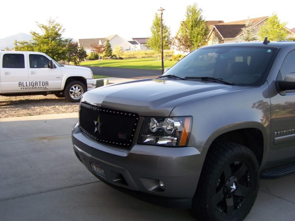

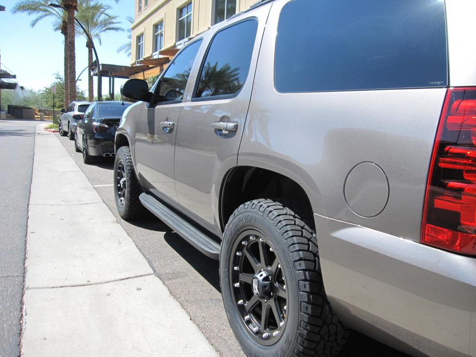

hmm I really dont mind triming. I guess my question now is what is the best offset/bs to go with. The attached pictures are the look im wanting to get.

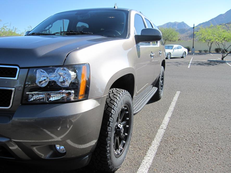

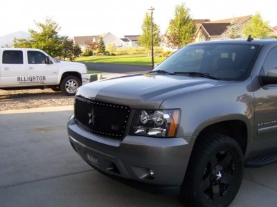

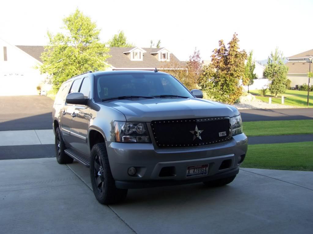

I am running a 2" Rough Country leveling kit, 20x9 XD Addicts w/ +18 offset. Tires are 275/60. I clear with no rubbing. Very minor amount of trimming required. I think a wider tire would require alot more trimming and maybe a shorter height - or a bigger lift.
