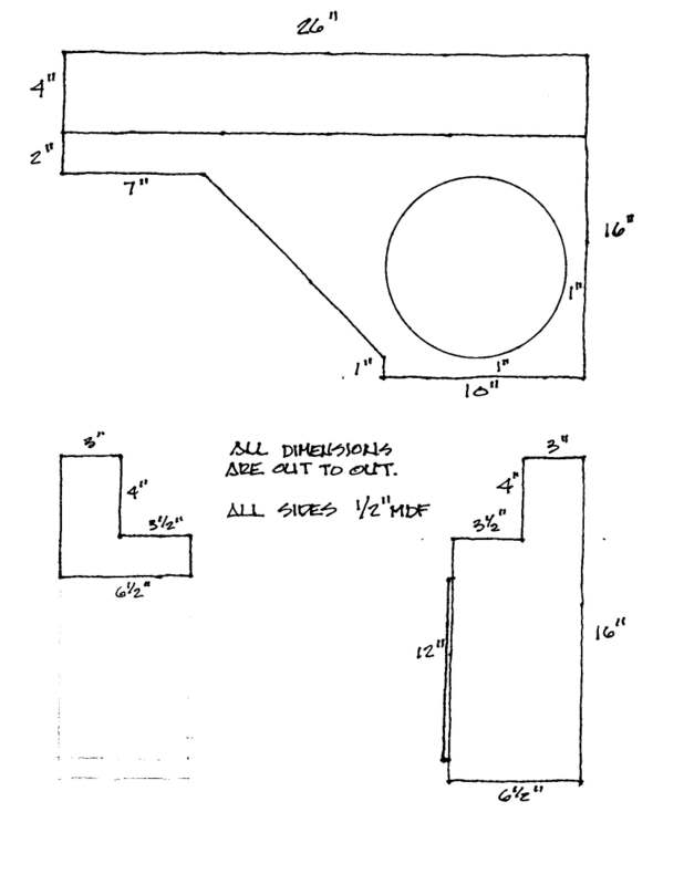

I've posted this up, it would fit in the right rear wheel well.

How big does it need to be for a 12" sub. I figured that one up and it came out to about 2.4 cubic feet. that is without taking into account for the wood thickness

Dont know if you have actually looked at that drawing hard but it will not work with anything bigger than an 8

Ok I redid my numbers. I came up with 0.62 cubic ft if you use 5/8. That is hardly big enough for anything

Well the one that I am getting needs. .5 but it takes up .14 so really it need to be .64 dont know if that little bit is going to make a difference

ok wrong again. forgot to take out one thing came up with .56
