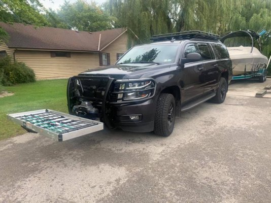

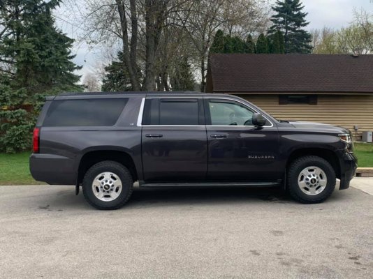

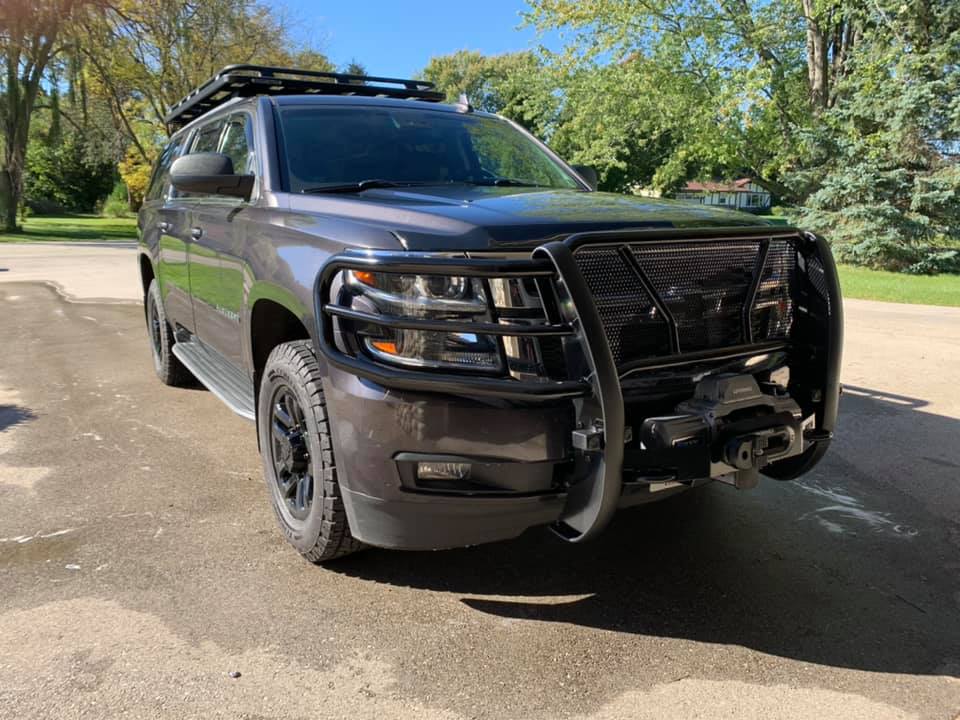

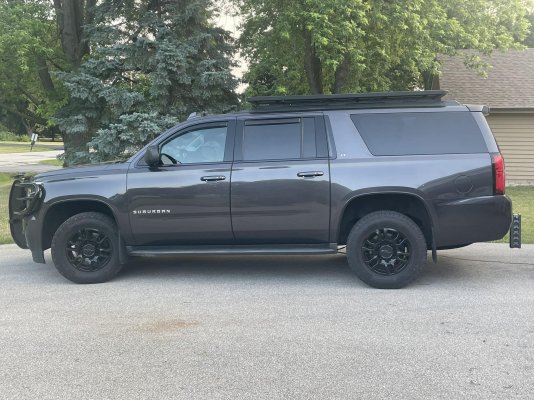

Hello here as a fellow 2016 Suburban 3500HD LT owner. Not many of us especially with the LT. A little about my rig.
Bought from dealer in Lock Haven Pennsylvania in March 2021 stock with 40k miles.
Mods:
Black grill and bowtie badges
Full husky liner set
Husky mud flaps
Rhino Roof rack with backbone
Westin HD winch guard with custom brackets
Super Winch 12k
GTR LED low beam headlights
Yellow/White switch back fog bulbs
Vibrant resonator on exhaust
Cognito UCA
Bilstein 5100 shocks
Kryptonite Keys
GM OEM Black 8x180 wheels +44mm
275/65R18 Tires
4g Aux wiring run to back to have constant 12v off aux battery
Have had for a few years now great truck and does everything I want. Will do my best to share knowledge and borrow ideas as we go... :)

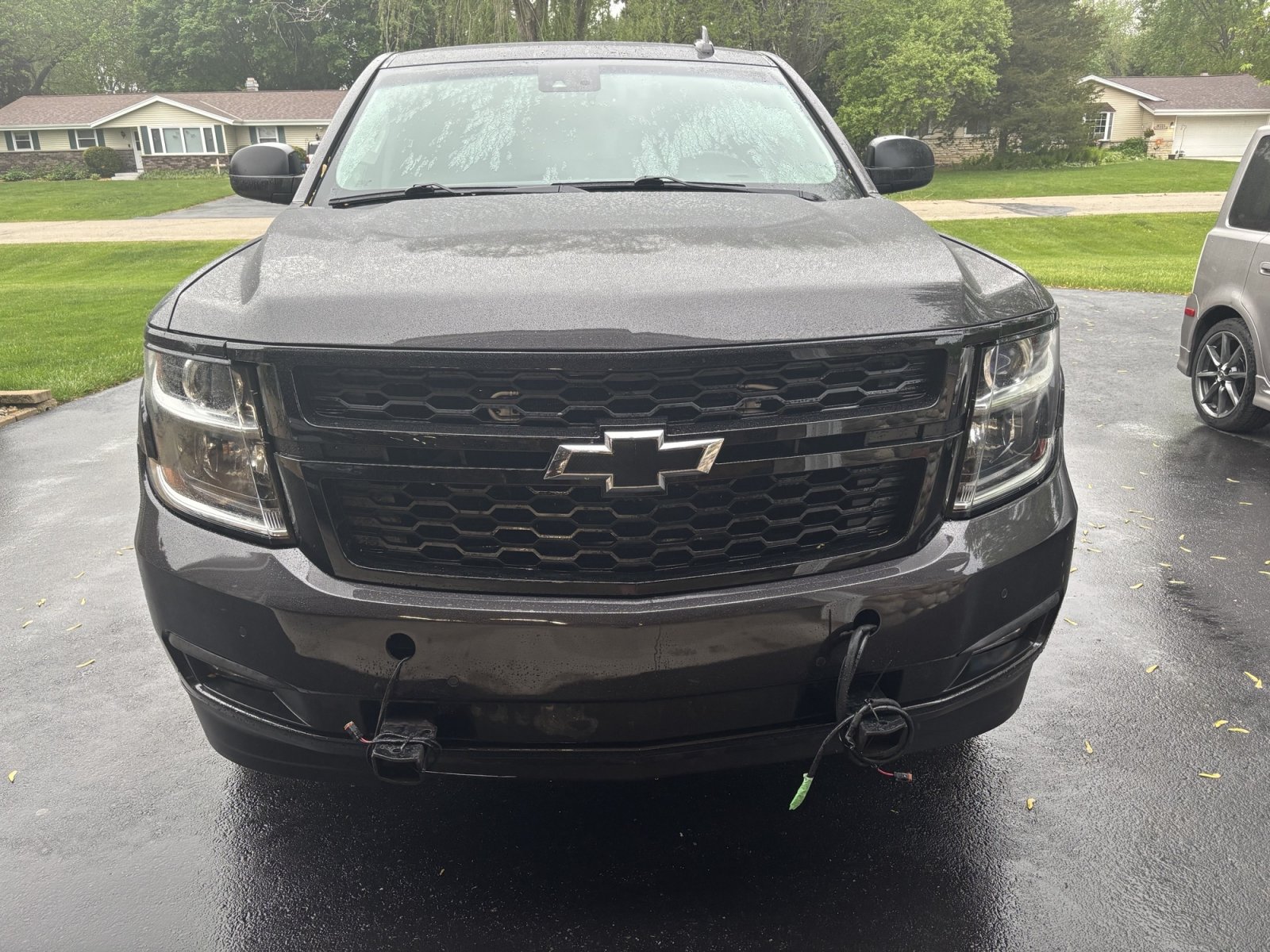

Actually impressed with the quality of this cheap aftermarket black grill from ZMAUTOPARTS on amazon . Had it installed when I got the hood and bumper painted. For those interested, you can see the holes that you have to drill in the plastic bumper cover to fit the Westin guard. The westin has an upper mount that prevents the guard from folding back into the grill.

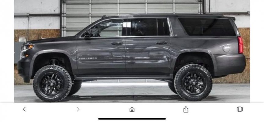

I noticed the best improvement in ride quality with tire pressure 40 front 50 rear when empty. This came from a 2500 Suburban owners manual for some year. Brother from another mother I originally was planning on lifting but quickly was schooled how much it messes up towing ability. Here was my inspiration picture.
Note larger tires are super hard with no lift I experimented a lot and anything more than +44 offset wheels (factory) made tires rub on lower pinch weld. If your willing to norcal the **** out of your truck then might get a little more room but I did not want to hack up this rare beast.

Yaaaa…. This much lift will definitely mess with towing! Hahaha I just wanted a modest 3” lift.
I think 33s can technically fit-ish with a level but I don’t care for the idea of just cranking the torsion keys.

If you don’t mind sharing, what did you pay for the bumper and hood?
I’m looking to have my hood done myself, also in PA
