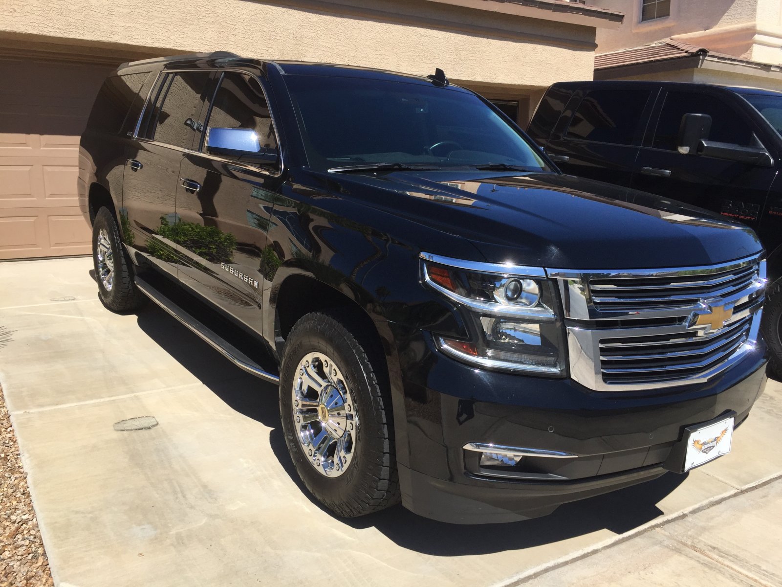

Hey y’all, I found a good deal on some Nitto Ridge grapplers in 285/70/18. That’s barely larger than what I have now which are 275/70/18 toyo open country and no issues except them wearing funny. Just wondering if they’ll even fit my leveled 2016 suburban without rubbing. Anyone have this size? Got a definitive chart of go/no go sizes that will fit our trucks with levels? Please share!

1. Are you on the stock factory 18" wheels?
2. Pics of current setup?
I'm interested in the same. Been waiting to get some 275/70/18 tires but would consider 285/70/18 if they fit like you're wondering as well.

It came with these XD chromies. I don’t know the offset but I’m pretty sure they’re 18x9. Can’t wait to swap them out.
