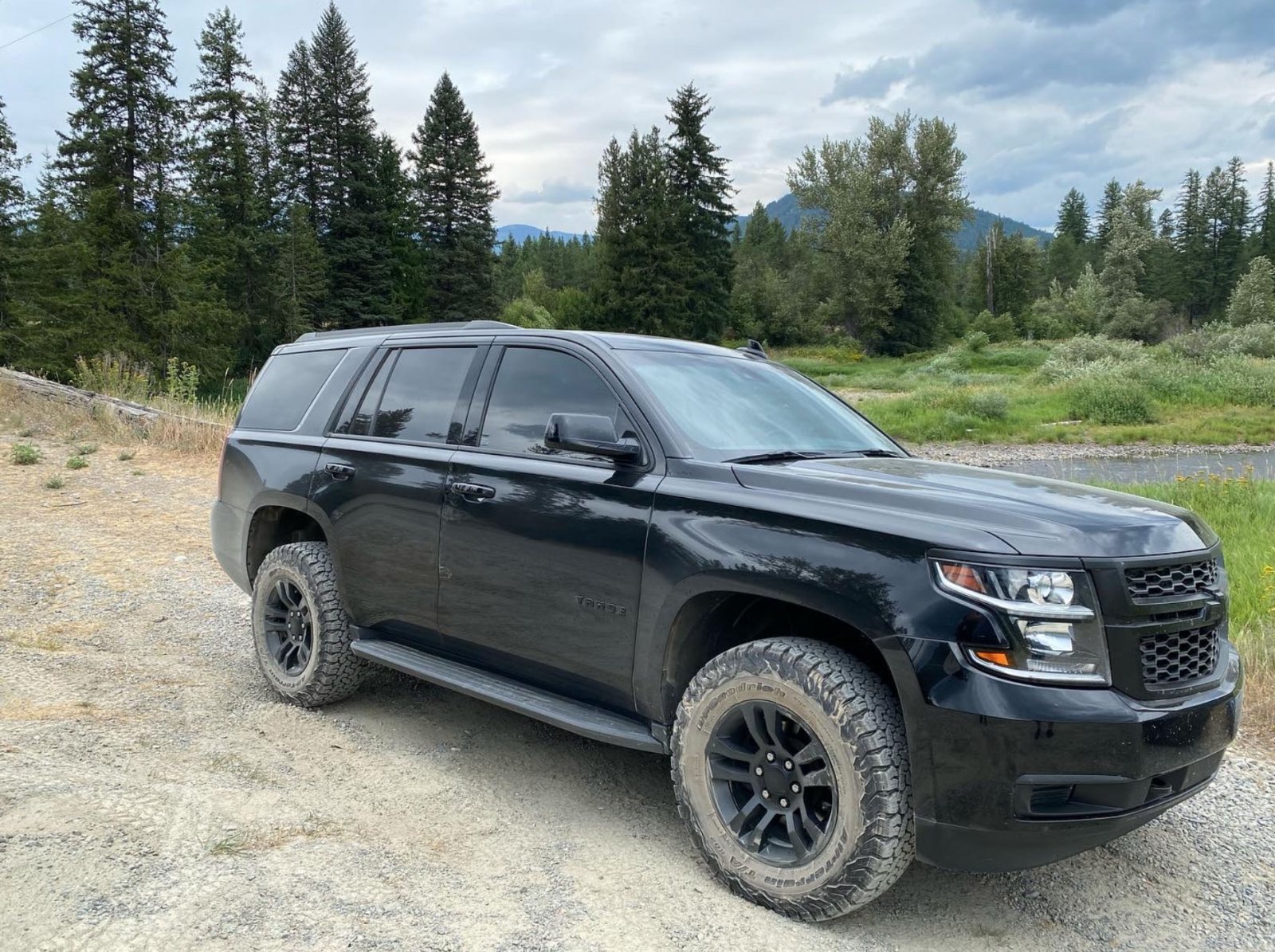

No rubbing on the stock 18" LT wheels with the 275/70/18 K02's. Even on uneven terrain or at full lock in parking lots. I installed Bilstein 5100's in the front which help with that clearance.

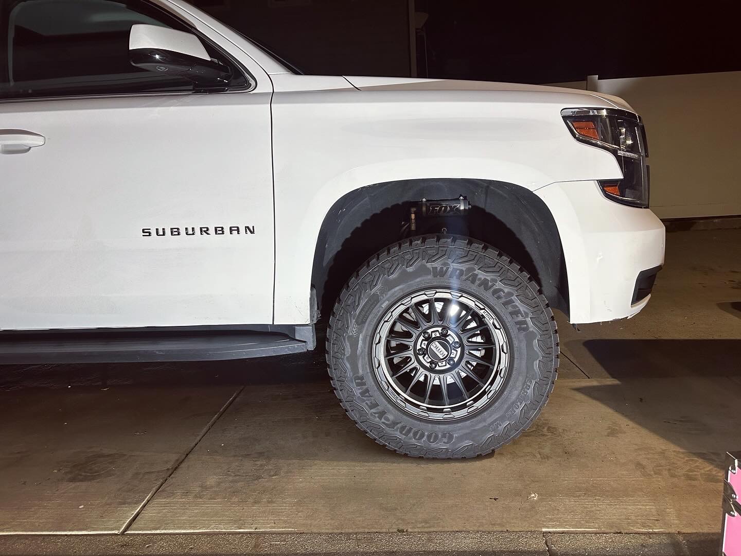

Finally made it back to post a pic of mine. I also ended up putting in a 2" Rough Country lift when I put these on and I still get some rubbing on the mud flaps. Absolutely love the look though so worth the minor annoyance.

Rides great, nice and smooth. Towing with them is just fine, cruising at 88mph on interstate 15 for hours on end is also totally fine.
I'm actually on my second set of these BFG KO2's 275/70/18. Got 50k out of the first set.
Their performance in the snow is what's convinced me to stick with these tires.
Still have the mud flaps on?

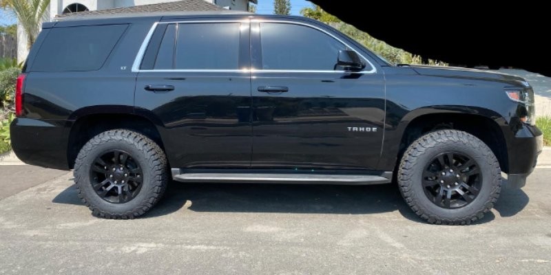

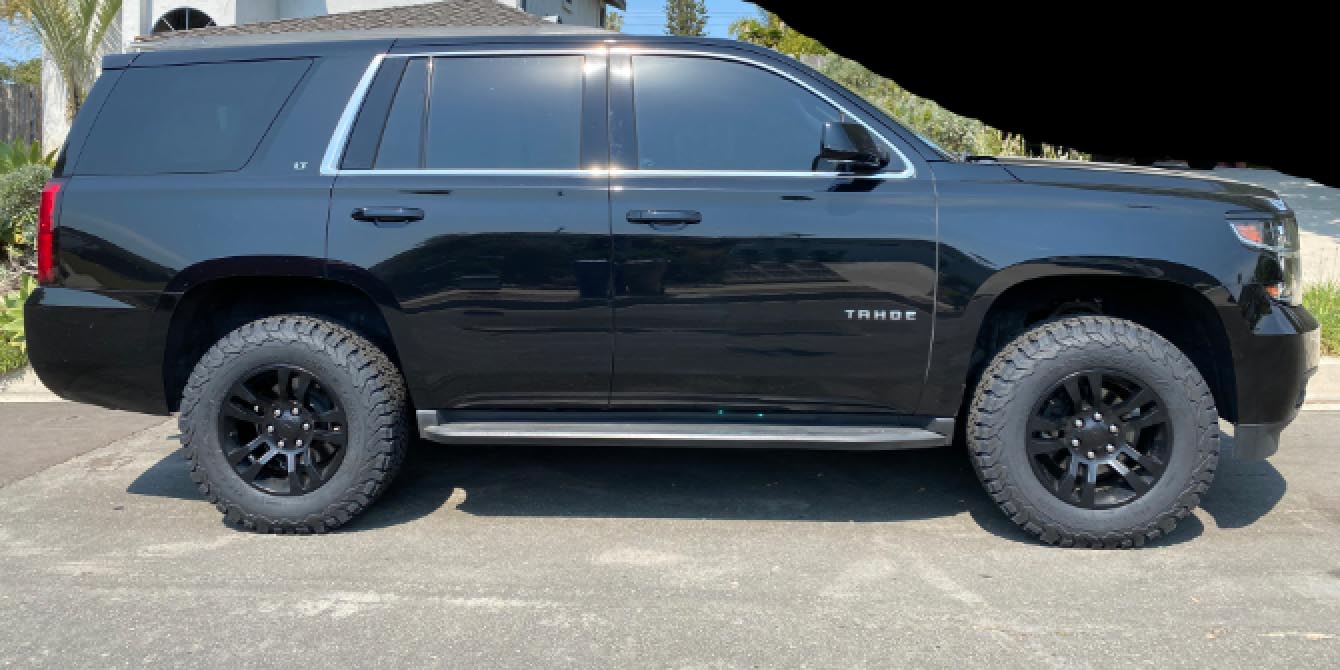

I have 275-70R18 Goodyear Territory MT tall but slightly skinnier same size as a ZR2 Silverado, full compression on turns the back of the fender rubs, but a tiny trim fixed it. Seen here with 2.75” of lift
