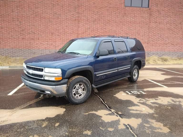

i know it is not commonly thought of as the thing to do unless doing a solid axle and building it up, but i just dont want one that is huge, as it is/will be a tow pig and possibly a plow horse.

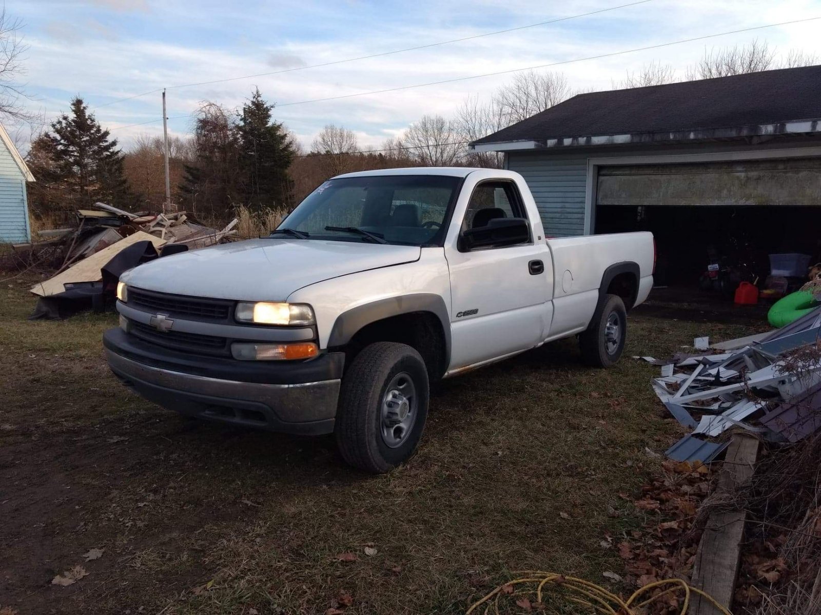

but i have an opportunity to buy a very rusty under 100k mile work truck ( like one pictured, but MUCH MUCH more rust). i would have the whole truck for donor parts and would have the 6.0 and my 4l85 to sell after as well as scrap the body/chassis when done, and have a few parts left over to boot. and for the price of the truck and the going price of just the engine and harness ect , then my trans ect ect. i bet i could get out of this swap for not much over labor. and considering i bought my burb for $1,200 i dont think that would be all bad, i mean how else would i make an 8.1 2500 burb better?
the donor has a manual case and my burb does not have a full counsel. so shifter would not be an issue. the only real issue i can think of would be a rear drive shaft, and that should be a standard length for a 4x4 2500 at that point, so shouldn't be to hard to find. front axle actuator may be a small issue (toggle switch, or cable actuation should solve this if the stock wiring dont do the trick , and i probably wont have a working 4x4 light on the dash, but i am ok with that.
i mean my math says even if i dont sell anything, i will be so cheap into if that i dont think i can find another even close.

not positive this is the donor truck , but imagine this with about 1/3 of each box side missing and no rockers/corners, and part of the fenders all rotted away.
