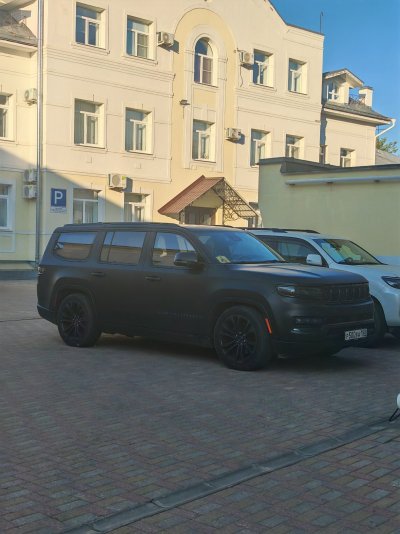

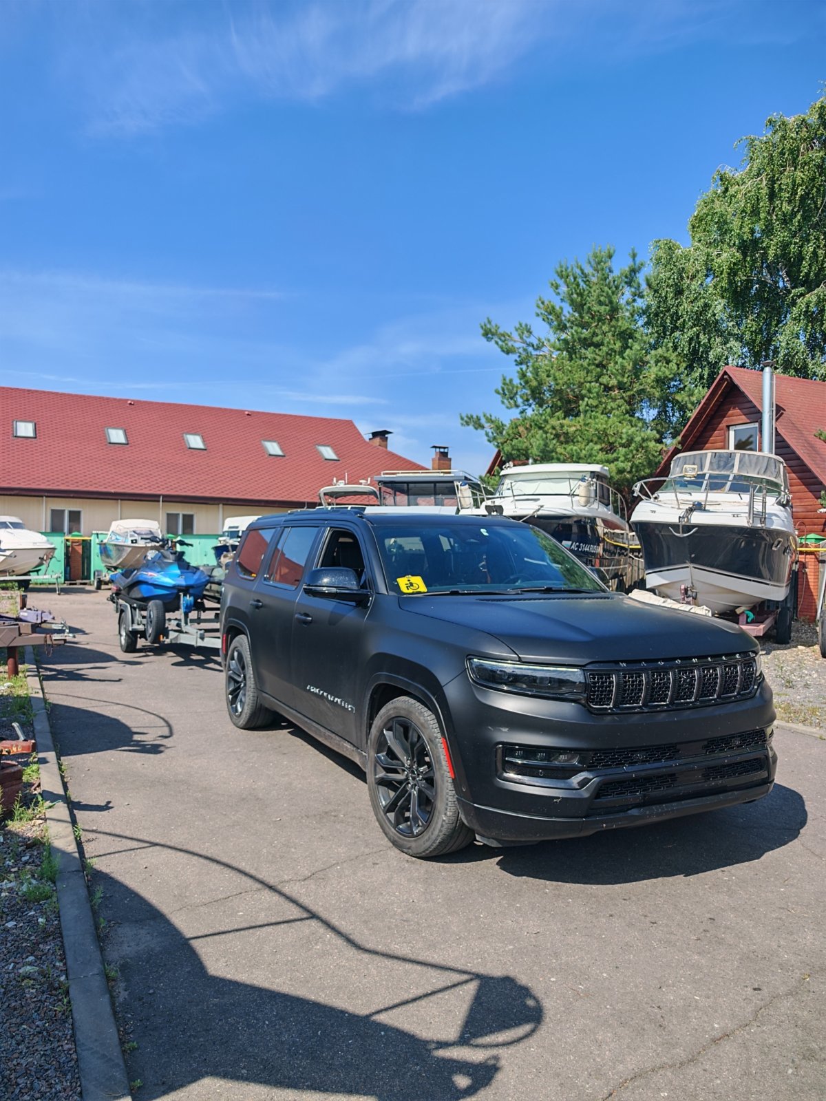

I bought a grand wagoner with a 3.0t engine, after 6.2 GM, it's already hard to scare me. And Grand Wagonier is just a space car, I like it very much)

What?!?!
I thought you just installed a refreshed properly disassembled and reassembled L87 6.2 motor in your 2022 Yukon XL Denali?
Did you trade it in on the Wagoneer?
I would have bought your Bi-LED module retrofit headlights.
