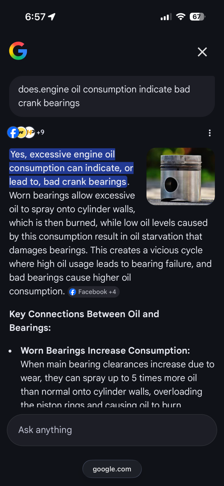

ReaperHWK
ReaperHWK
Oct 14, 2020
1,005
1,235
AI and GM says you guys are incorrect.
jfoj
Aug 9, 2012
1,227
1,089
You gotta love AI.
You do understand a few things, these engines already have oil squirters that spray oil on the underside of the pistons to cool them. Sure these may not spray directly on the cylinder walls, but there is already a fair amount of oil being sprayed upward toward the cylinders. If the oil control rings are functioning correctly and not stuck they should be able to scrape and control oil on the cylinder walls without to much problem, even more oil sprayed directly on the cylinder.
Not sure how long any engine will last with 5x the amount of oil leaking/spraying out the main bearings and how this would impact oil pressure. I assume this could equate to 5x the oil clearance over spec??
The majority of the manufacturers claim 1 quart of oil consumed per 1000 miles is considered acceptable. I am sure some may claim a higher oil consumption is acceptable? I sure would not want an engine that consumes more than 1 quart between oil changes because the intake valves and catalytic converters would not be very happy. 1 quart per 1000 miles equates to 5-6 quarts of oil per typical oil change, which is nuts, but some engines and the way the vehicle is used may consume this amount of oil. But nothings I would consider as "normal".

blanchard7684
Senior Member
Dec 23, 2024
447
382
The particular failure mode being described in the AI summary and associated source articles is confounding two things--piston ring wear and bearing wear.
To get a normal wear pattern develop on bearings to the extent that oil flow is increased and being sent to cylinder walls, in such an excess quantity that it overloads the piston rings, would only occur if, and only if, the engine had tremendous miles on it.
In this scenario the rings are already worn. Thus you can't directly link worn bearings to high oil consumption.
The specific situation going on with 6.2 bearings is accelerated wear due to manufacturing problems primarily, and secondarily from the bearings being exposed to mixed boundary lube for much longer than expected. (You see very early failures before 10,000 miles and then at higher miles like 20,000-80,000 miles.)
In no case has there been even a weak correlation between oil consumption and early bearing failures. The piston rings are not worn. They are not experiencing additional wear due to high oil flow impinging on them from the failed bearings. The bearing failures happen quickly. These engines aren't being driven around knocking like crazy for 3 or more oil change intervals.
