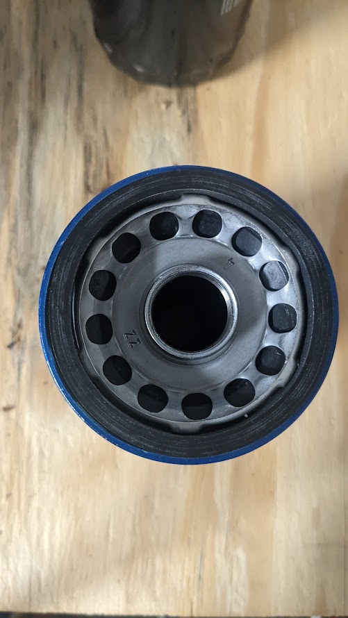

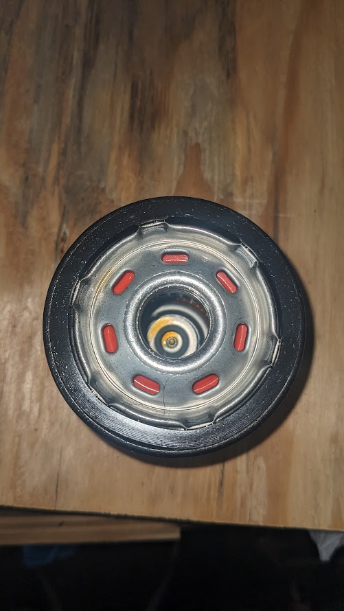

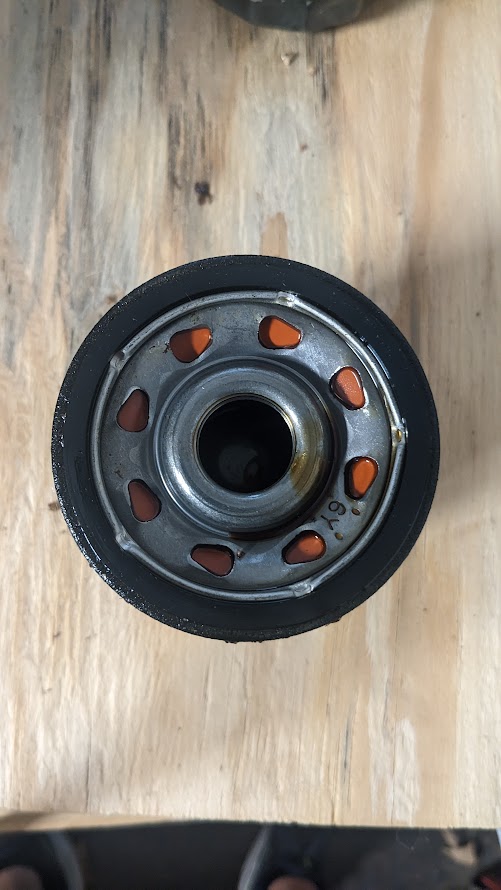

On the oil filter issue, also note that the PF63/PF64 have much larger and higher quantity of oil inlet holes in the filter when compared to some typical aftermarket filters. This does not even touch on the oil pressure relief valve spring pressure or oil filter media.
There is a reason the oil filter base has so many larger holes than what you typically see on some of the aftermarket filters. Not sure of the exact reason, but AC Delco would not do this without a specific reason.
PF63 oil filter base plate
Other After Market Oil Filter Base Plate Designs
DuraYuk
Sep 17, 2022
1,111
884
View attachment 457592View attachment 457593View attachment 457594

I believe the UPF63 may be a Napa or Wix??
But if this Amazon link is accurate on the picture of the base plate, very different animal.
Also with how often I change the oil, the UPF63 is about $10 more than the PF63 as well.
UPF63 Oil Filter
