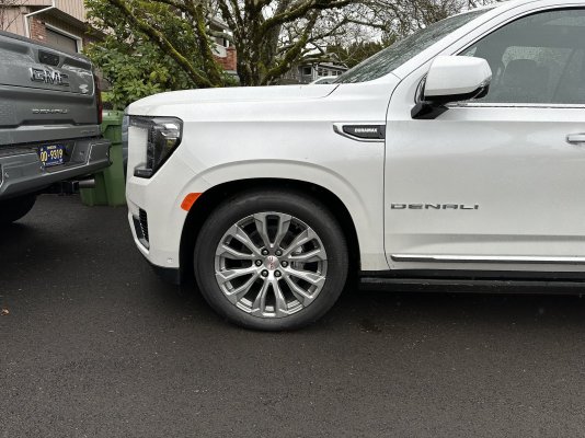

I have a 2024 Yukon Denali with the Reserve Package, which includes air suspension. I've noticed that when I park overnight, the front air shocks seem to deflate, causing the vehicle to sit low in the front (but normal in the rear). I checked and do not have the setting engaged that lowers the vehicle when parked for easy entry/exit. I previously had a 2022 Tahoe Z71 that also had air suspension, and never had this issue. This Yukon has less than 500 miles on it. I'm wondering if there is an air shock leak? When I start it, the shocks inflate to normal height, and seem to operate normally. I don't hear any air escaping when I turn the engine off. Has anyone experienced this?

UPDATE: No improvements since I got the vehicle back from the dealer. The front suspension still drops when parked. The longer it's parked, the more it deflates. I've begun measuring the distance from the ground to the bottom of the wheel well on the fender, and it drops over 3" when it sits more than one overnight period. I talked to the dealer again and sent my service rep the bulletin that was posted above (thank you). He showed it to the tech that had worked on my vehicle and said that they were ordering the parts or kit to replace and/or repair the front air shocks. Hopefully that does the trick. I'll post another update once the repair has been made.
