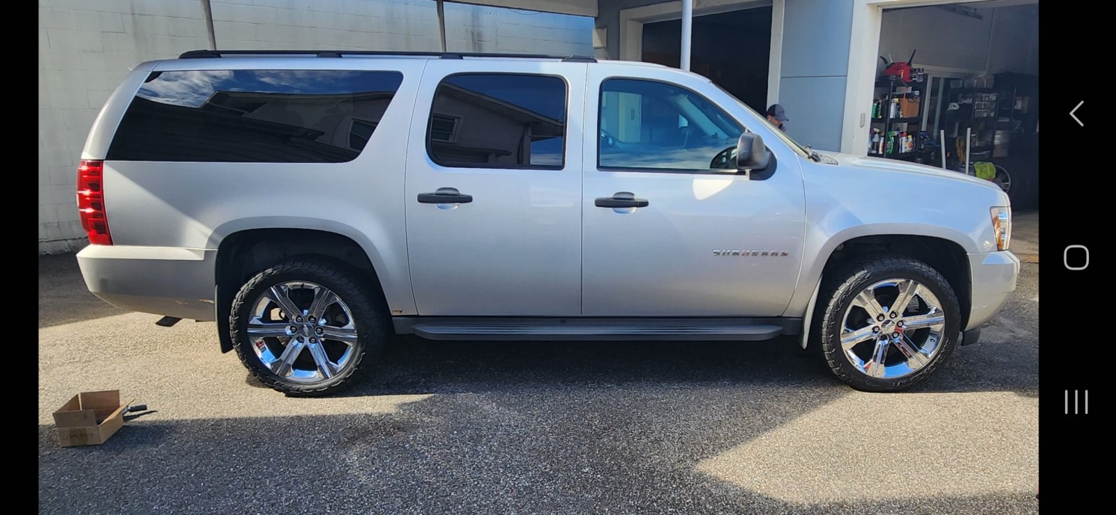

I got late model GM 22's on my 10 Burb & 08 Yukon. Bolts right up but rubs the fender liners slightly when turning in reverse.

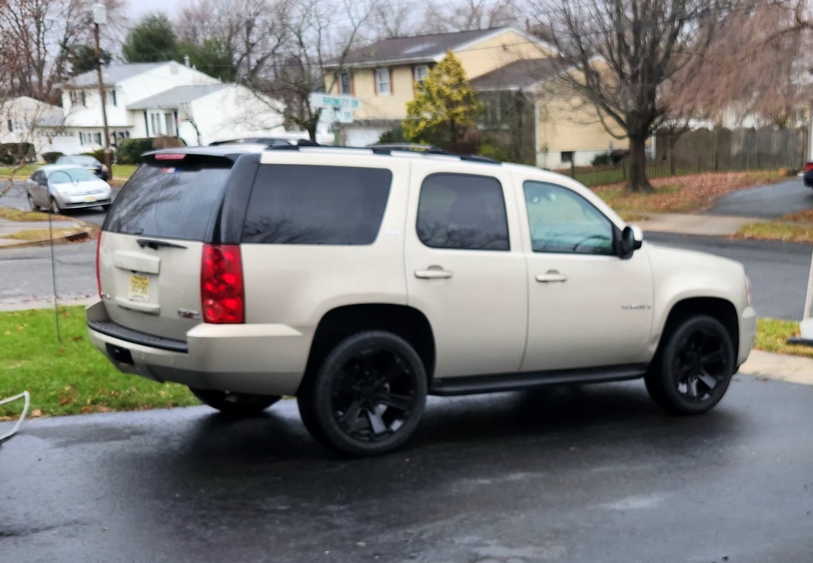

You will need to swap the sensors over from your current tire setup. Bit other than that they should fit with no issues. I have 2021 Yukon take off 20s on my 2006 and they bolted right up.

GM 22" wheels on both my trucks. Not sure what years they're from but they synced right up with the TPMS. Both rub the plastic fender wells when turning in reverse slightly. The rubbing can be eliminated with a lift kit or use some persuasion with the fender wells to pull them out a bit or just ignore the rubbing. The ride of both trucks improved with the bigger wheels.
