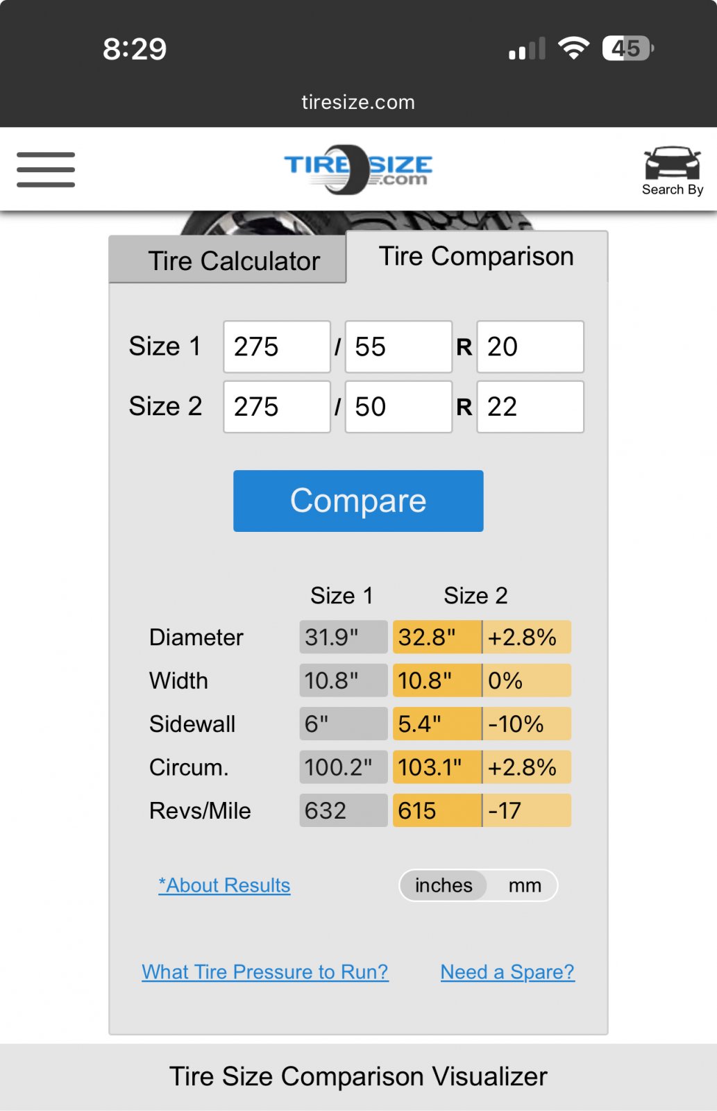

My 2013 LTZ factory wheels are 20". 275/55/20
I have a set of 2023 22" wheels with Size: 275/50R22 tires. 1" bigger in diameter. Can I put these on my 2013? with the 2023 sensors ?
Will 1" bigger make a difference on my 2013 ?
