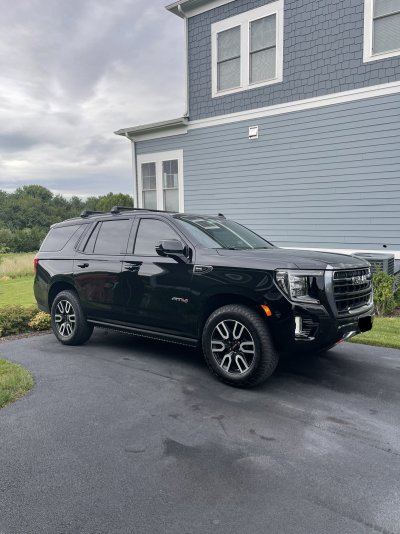

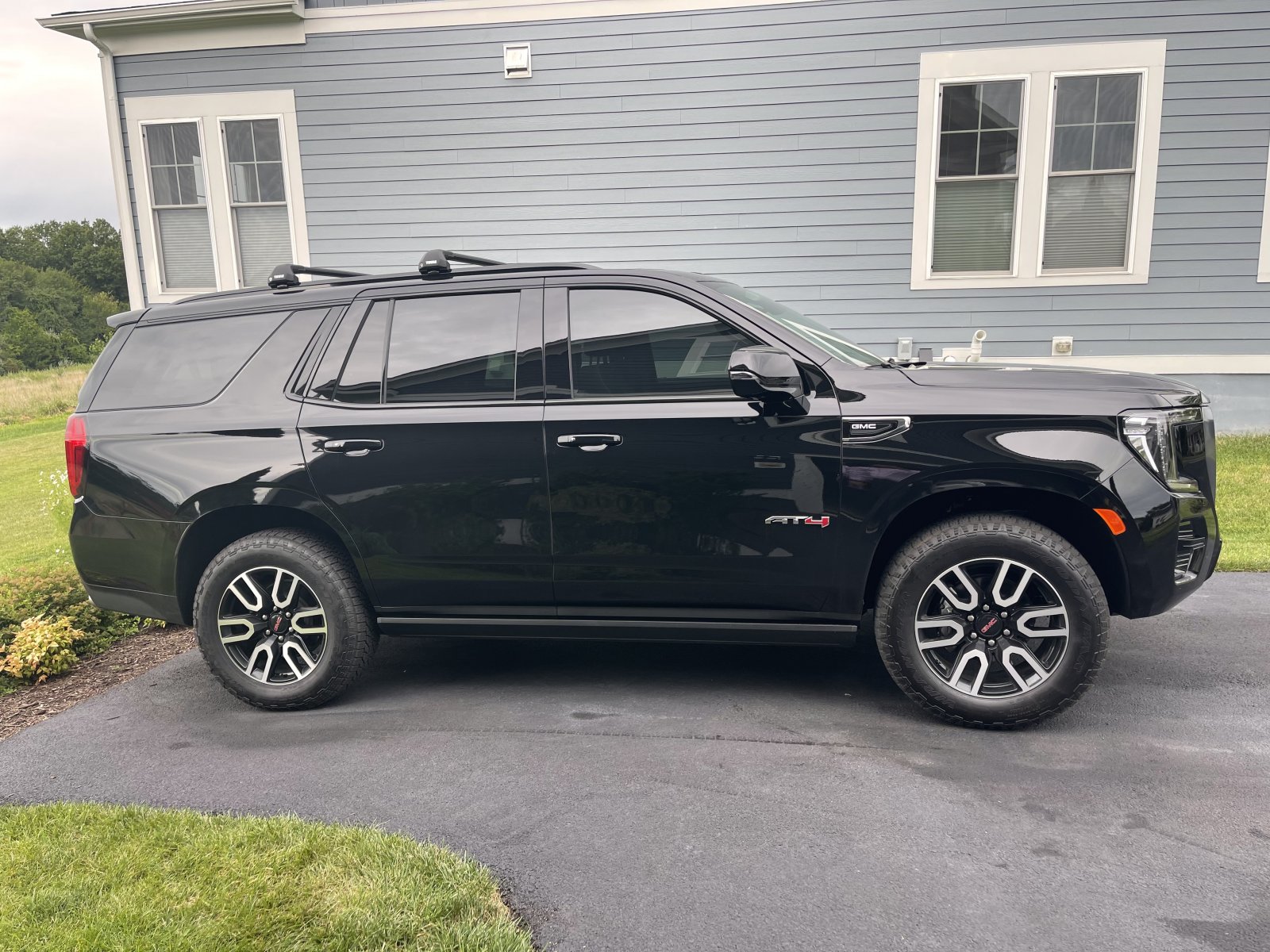

Sharing because I looked everywhere for aftermarket Yukon AT4 roof rack pics and couldn’t find much of anything so hoping this helps someone else in the future - 2022 AT4 with Thule edge mounts and aerobar - I needed something shorter than the 4.5” tall stock bars to fit into some underground garages near me - this just barely fits under a 6’8” clearance garage - pano roof opens no problem, no added road noise or issues

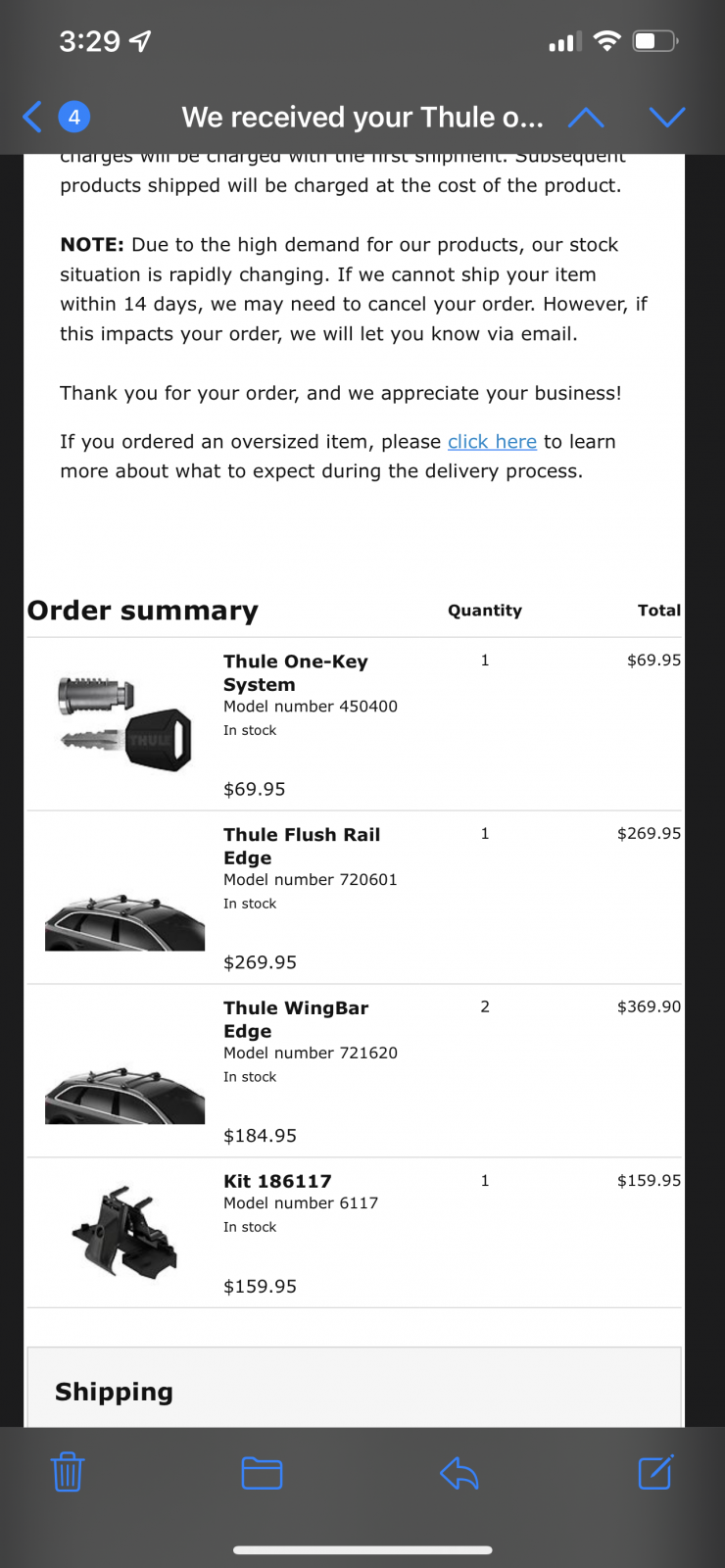

Do you have part number(s) for what you purchased from Thule? There website seems to show that they don't have a product that will work with 21+ Yukons. Thanks!

Happy to help - here’s what I ordered and it fit without any issues - I’ve also seen the same parts available on etrailer and another site but there was a backorder on one of the parts so when I found it through Thule’s site I grabbed them, install took about 20 minutes

In case you have any trouble seeing the pic:
Thule flush rail edge - qty 1 - part 720601
Thule wing bar edge - qty 2 - part 721620
Kit 186117 - qty 1 - part 6117
Thule one key system - qty 1 - part 450400

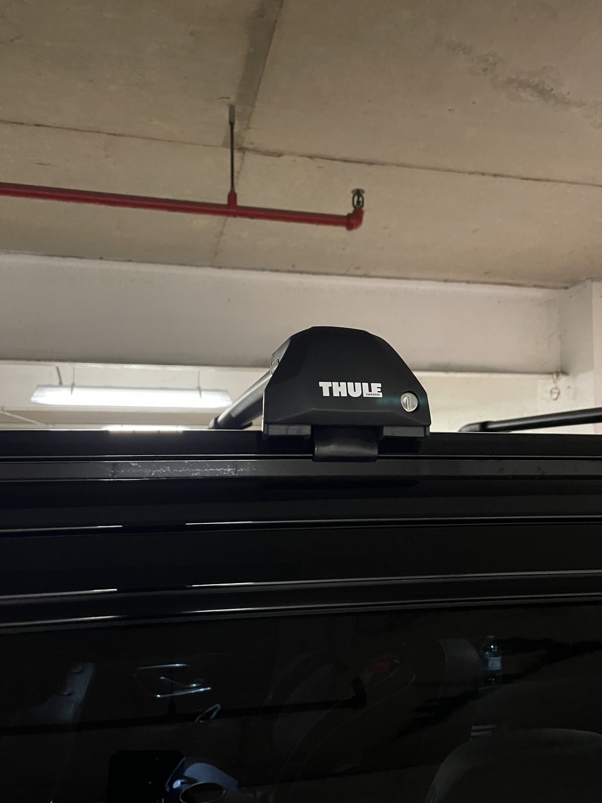

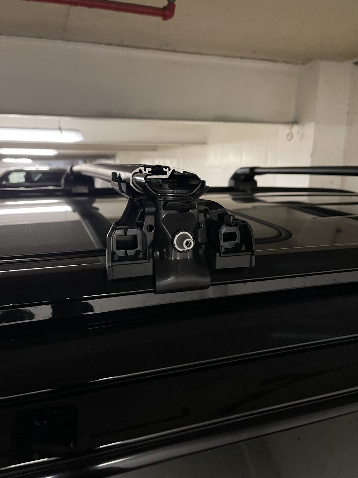

@iggy3773 can you take a couple close up pics of the cross bars mounting ti the rails...I have the factory bars, but they stick up too high....thanks in advance.

Sorry was traveling - here are a couple - one with the cover and one with the cover removed

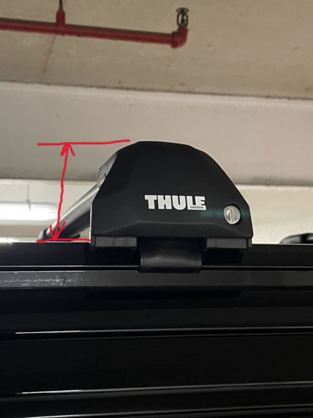

@iggy3773 I know this is an old post, so not sure if you're still monitoring. But... if you are and feel like doing a favor, can you get a dimension from the top of the roof rail to to the top of the cross rail foot? Or roof to top of cross rail. I know this system is lower than OEM (which is what I need after 3" lift) just hard to say how much lower. I'll look for the dims of the foot kit online as well. Thanks in advance!
