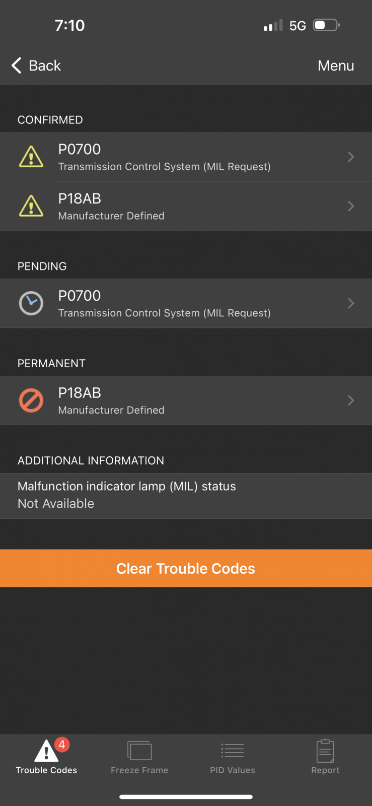

4800 miles, 3.0 diesel LS suburban.
Was in stop and go traffic coming down to a stop, went to accelerate again but not moving (still in D) and threw a check engine light. Trying to put in park and then back in gear, not doing anything. Message appeared no shift condition. Trying to cycle on/off, car will not get into gear. Meanwhile I’m stopped in the middle lane with traffic piling up behind me. After a minute or so another cycle it finally goes into gear and off I go. Made it home but check engine light still there. Getting it towed to dealership today, not wanting to risk getting stalled again.
Read the codes (see screenshot). Looks like generic transmission code…
Anyone else experience this?
Will update after I hear back…

Could be transmission control module - could be wiring issue.
I took have a base model LM2 and I've been poking around under the hood/chassis as much as possible to see if any harnesses are touching places they shouldn't. There's a labyrinth of wiring on these vehicles - even the base model and though GM designed a fair amount of wire routing guides and clipping points, there's always a chance that the person on the line that day didn't add the zip-tie or clip that is needed to keep the harness from rubbing against something else.
There's an extensive TSB from GM that covers many engines, including LM2 and areas to look for wiring harness chaffing. I'd take a look and see if you can find anything on your own.

Thanks, that’s a good suggestion however it’s already been picked up. Waiting for them to get back to me tomorrow..

Not much of an update but my case has been escalated to GM and the dealer is waiting to hear back from them. That was on Friday morning and they said it will take at least until Wed.

Finally received my ride back today after exactly 2 weeks at the dealership. Service advisor initially said there was an issue with the TCM and they were waiting for parts. However after pressing for more info today before picking up it seems they replaced the transmission valve body, per paperwork.
