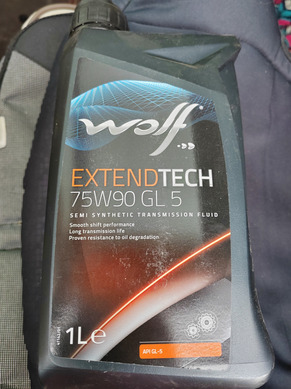

To replace it, buy any 75w90 GL5 oil and a self-locking additive GM 88900330, and change it. The symptom goes away.
