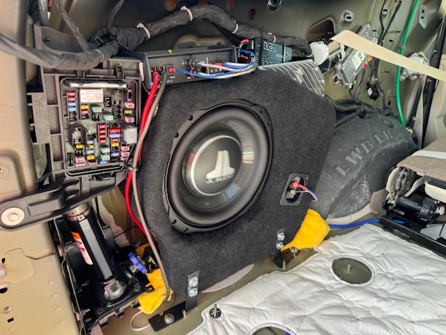

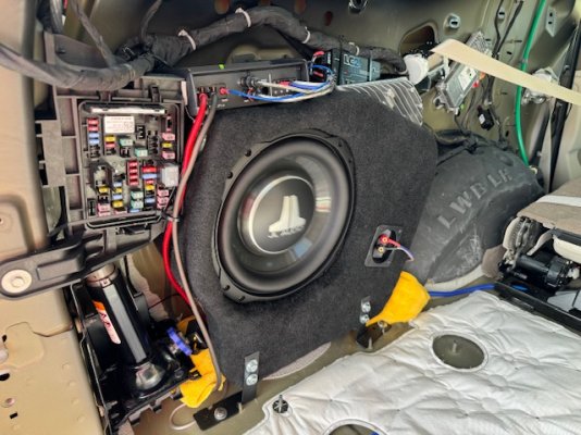

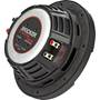

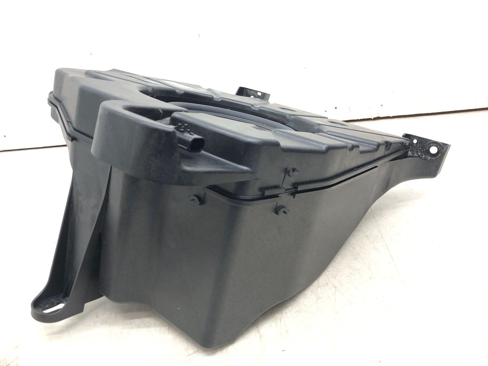

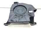

I bought a 2021-2023 oem rear bose subwoofer box part number #84776627. It is 4 inches deep where it molds to the gas filler neck inside the fender. Then it tapers up to 5 inches deep. I purchased a Kicker comprt 2-ohm 8-inch subwoofer with a mounting depth of 2 11/16 inches. I am powering it with an Audio Control amplifier — 300 watts RMS x 1 at 2 ohms. I picked the amp because it is small and the RMS wattage matches the sub, it also has an internal line output converter.

The oem box used an 8 inch subwoofer. You could make the hole larger. The internal box depth is split half 4 inches and 5 inches on the other half.

Where did you mount the amp for the sub? I’m hoping there’s a good hidden space that works.
