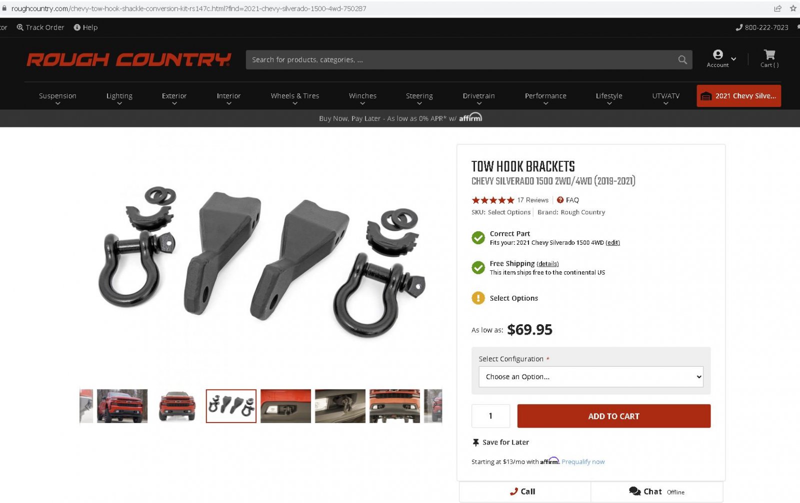

Has anyone tried to put hooks on the 21/22 Denali yet? There appears to be a part number listed for them, just wondering if they install and fit in the right spot to work with the factory bumper access cover.
30,763
48,455
rough country makes these for the silverado's, they do not show them for the suv's, there could be a couple reasons why
1. the plastic trim over the hole is either in the way and would need to be cut out
or
2. the frame size/mount holes are different
you would have to take some measurements and if possible compare to any oem options, calling RC would likely be no help the sales people have no clue.
they also make a tow hook for the silverado's they do not extend out as far as these brackets do.
