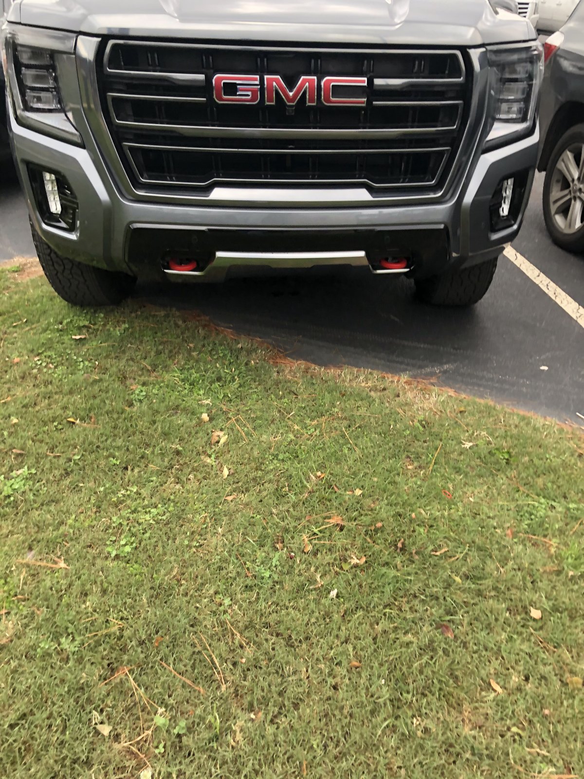

Does anyone know if the AT4 front fascia will mount to an SLT and if so, is the chrome grill trim part of the front fascia? I ask because AT4 has "black chrome" trim, whereas SLT is chrome. Seems like one big piece of plastic, but would be nice to keep chrome trim. I really want tow hooks and would appreciate the additional approach angle.
Jsenky
Jul 17, 2016
65
35
my at4 doesnt really have a front “fascia” like the slt does. The whole bumper and grill are different and would have to be replaced to swap between the two trims. The silver part in the pic below is just the skid plate.
i would like to think you can get the tow hooks to work somehow though.
