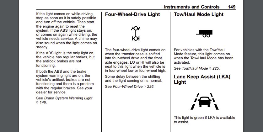

The page you posted is what I found it shows a picture of the dash light and it reads it will come on when in 4x4 and the front axle engages. I do not see that light on my dash does anyone else see that light? Maybe some have a manual shifted transfer case? Mine has a knob

I don't remember seeing a light on my 2017 other then the one on the knob. Which I'm OK with because the older ones that's the only indication you had so that's what I'm used to looking for.
It does tell you when it's transferring to 4x4 and presumably if there's a problem.
